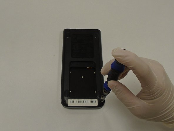

    • Using a Phillips #00 screwdriver, remove the two 4.5 mm screws securing the battery cover located at the bottom center of the device.
    • Remove the cover.

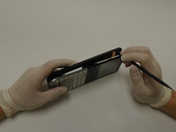

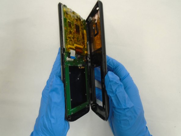

    • Using a spudger, gently pry apart the front and back panels.

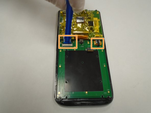

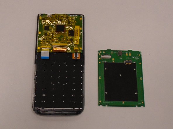

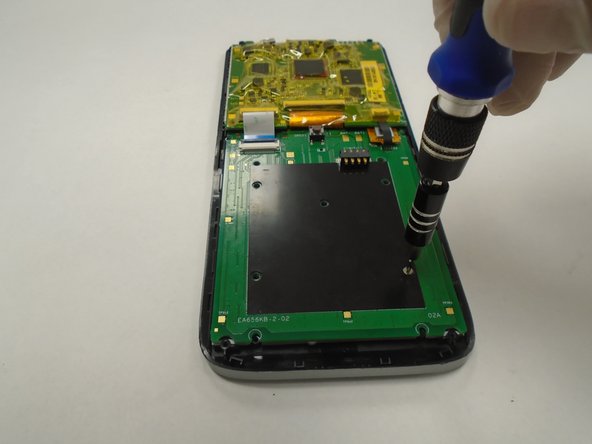

    • Using a Phillips #00 screwdriver, remove the eleven 3 mm screws securing the battery board/button panel located at the bottom half of the device.
    • Using a plastic opening tool, gently pry the retaining clip securing the ribbon cable to the top-left side of the board.
    • Using plastic tweezers, gently unplug the ribbon cable from the board.
  7. HP Prime Graphing Calculator G8X92A Button Panel Replacement: crwdns2935265:07crwdnd2935265:01crwdnd2935265:03crwdne2935265:0 HP Prime Graphing Calculator G8X92A Button Panel Replacement: crwdns2935265:07crwdnd2935265:02crwdnd2935265:03crwdne2935265:0 HP Prime Graphing Calculator G8X92A Button Panel Replacement: crwdns2935265:07crwdnd2935265:03crwdnd2935265:03crwdne2935265:0

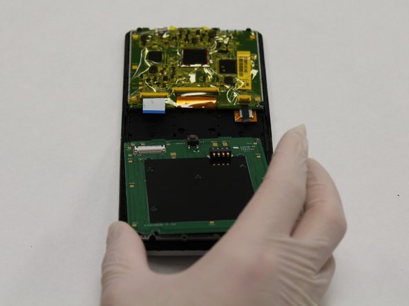

    • Using a plastic opening tool, gently pry upward on the battery board/button panel from the bottom to remove.
