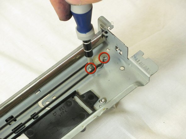

  23. HP Photosmart c3180 Driver Motor Replacement, Driver Motor: crwdns2935265:023crwdnd2935265:01crwdnd2935265:02crwdne2935265:0 HP Photosmart c3180 Driver Motor Replacement, Driver Motor: crwdns2935265:023crwdnd2935265:02crwdnd2935265:02crwdne2935265:0
    • Set aside the printer body.
    • Remove the two motor retainment T10 4 mm Torx screws, per images 1-2.

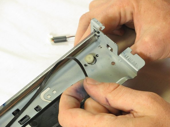

  24. HP Photosmart c3180 Driver Motor Replacement: crwdns2935265:024crwdnd2935265:01crwdnd2935265:02crwdne2935265:0 HP Photosmart c3180 Driver Motor Replacement: crwdns2935265:024crwdnd2935265:02crwdnd2935265:02crwdne2935265:0
    • Grasp the bottom of the drive motor (Hidden behind the housing in images 1-2) and rock it away from the center of the cable loop to release the tension in the cable.
    • Using your fingers, unhook the cable from drive motor.
  25. HP Photosmart c3180 Driver Motor Replacement: crwdns2935265:025crwdnd2935265:01crwdnd2935265:01crwdne2935265:0
    • Remove the printer drive motor by gently pulling it downward.
