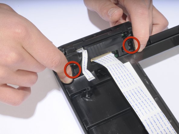

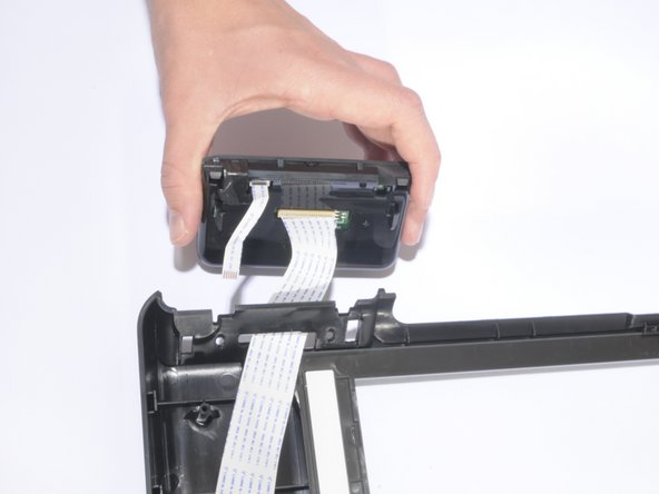

  11. HP Photosmart D110a LCD Screen Replacement, LCD Screen: crwdns2935265:011crwdnd2935265:01crwdnd2935265:02crwdne2935265:0 HP Photosmart D110a LCD Screen Replacement, LCD Screen: crwdns2935265:011crwdnd2935265:02crwdnd2935265:02crwdne2935265:0
    • The LCD screen is attached to the piece of the hood with the glass shield.
    • Do not remove the small ribbon wire. While the LCD has two ribbon cables, only the larger one can be safely disconnected.
    • To release the LCD, locate the two mounting slots, and push the sloped slides inward to release the LCD from its slots.
  12. HP Photosmart D110a LCD Screen Replacement: crwdns2935265:012crwdnd2935265:01crwdnd2935265:03crwdne2935265:0 HP Photosmart D110a LCD Screen Replacement: crwdns2935265:012crwdnd2935265:02crwdnd2935265:03crwdne2935265:0 HP Photosmart D110a LCD Screen Replacement: crwdns2935265:012crwdnd2935265:03crwdnd2935265:03crwdne2935265:0
    • Slide the LCD module downward to remove it from its holders.
    • The large ribbon wire from the LCD can be detached if needed.
