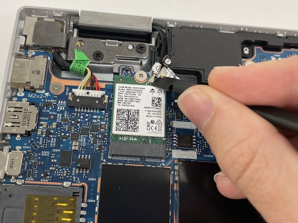

    • Disconnect connectors 1 and 2 of the wireless card using the spudger.

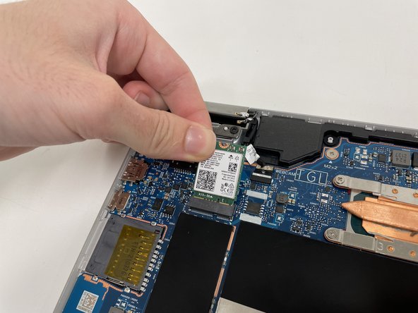

  7. HP Pavilion x360 Convertible 14-dw1025nr Motherboard Replacement: crwdns2935265:07crwdnd2935265:01crwdnd2935265:02crwdne2935265:0 HP Pavilion x360 Convertible 14-dw1025nr Motherboard Replacement: crwdns2935265:07crwdnd2935265:02crwdnd2935265:02crwdne2935265:0
    • Use PH1 to remove the 2.5mm holding screw.
    • Lift the card up and out.

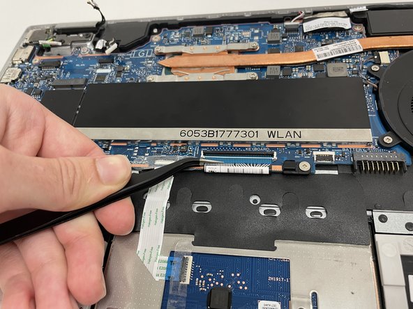

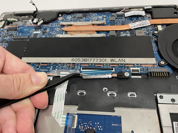

  12. HP Pavilion x360 Convertible 14-dw1025nr Motherboard Replacement: crwdns2935265:012crwdnd2935265:01crwdnd2935265:03crwdne2935265:0 HP Pavilion x360 Convertible 14-dw1025nr Motherboard Replacement: crwdns2935265:012crwdnd2935265:02crwdnd2935265:03crwdne2935265:0 HP Pavilion x360 Convertible 14-dw1025nr Motherboard Replacement: crwdns2935265:012crwdnd2935265:03crwdnd2935265:03crwdne2935265:0
    • Be sure not to scratch or puncture the ribbon cable.
    • Use the spudger to lift the black flap of the keyboard connector.
    • Use the angled tweezers to carefully grip and pull out the ribbon cable.

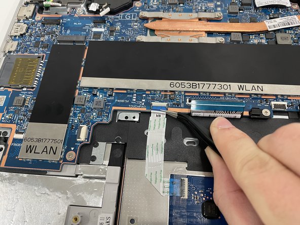

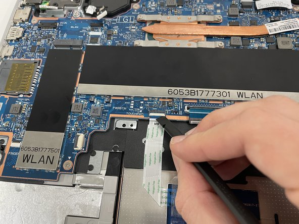

  13. HP Pavilion x360 Convertible 14-dw1025nr Motherboard Replacement: crwdns2935265:013crwdnd2935265:01crwdnd2935265:03crwdne2935265:0 HP Pavilion x360 Convertible 14-dw1025nr Motherboard Replacement: crwdns2935265:013crwdnd2935265:02crwdnd2935265:03crwdne2935265:0 HP Pavilion x360 Convertible 14-dw1025nr Motherboard Replacement: crwdns2935265:013crwdnd2935265:03crwdnd2935265:03crwdne2935265:0
    • Use the angled tweezers to remove the clear sticker covering the trackpad connector.
    • Use the spudger to lift the white flap of the connector.
    • Use the angled tweezers to pull out the ribbon cable.

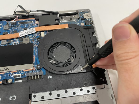

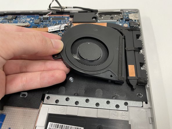

  14. HP Pavilion x360 Convertible 14-dw1025nr Motherboard Replacement: crwdns2935265:014crwdnd2935265:01crwdnd2935265:01crwdne2935265:0
    • Use the spudger to disconnect the fan cable.
  15. HP Pavilion x360 Convertible 14-dw1025nr Motherboard Replacement: crwdns2935265:015crwdnd2935265:01crwdnd2935265:03crwdne2935265:0 HP Pavilion x360 Convertible 14-dw1025nr Motherboard Replacement: crwdns2935265:015crwdnd2935265:02crwdnd2935265:03crwdne2935265:0 HP Pavilion x360 Convertible 14-dw1025nr Motherboard Replacement: crwdns2935265:015crwdnd2935265:03crwdnd2935265:03crwdne2935265:0
    • Use PH1 to remove the 3 4mm screws holding the fan.
    • Lift the fan up and away from the heat pipe.

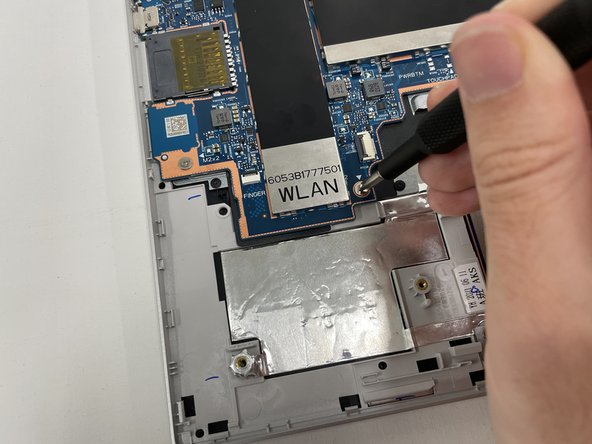

  16. HP Pavilion x360 Convertible 14-dw1025nr Motherboard Replacement: crwdns2935265:016crwdnd2935265:01crwdnd2935265:02crwdne2935265:0 HP Pavilion x360 Convertible 14-dw1025nr Motherboard Replacement: crwdns2935265:016crwdnd2935265:02crwdnd2935265:02crwdne2935265:0
    • Use PH1 to remove the 7 2.5mm screws holding down the motherboard
    • Both battery stabilizers (small, black plastic parts) will be loose.

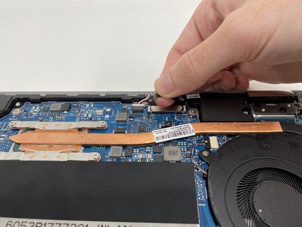

  17. HP Pavilion x360 Convertible 14-dw1025nr Motherboard Replacement: crwdns2935265:017crwdnd2935265:01crwdnd2935265:01crwdne2935265:0
    • Slightly lift the heat pipe with one hand.
    • Using your other hand, lift the small part of the motherboard up and away from the laptop frame.
    • The silver section under the heat pipe is a ribbon cable that connects the small piece to the large section of the motherboard.

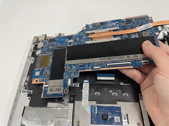

  18. HP Pavilion x360 Convertible 14-dw1025nr Motherboard Replacement: crwdns2935265:018crwdnd2935265:01crwdnd2935265:02crwdne2935265:0 HP Pavilion x360 Convertible 14-dw1025nr Motherboard Replacement: crwdns2935265:018crwdnd2935265:02crwdnd2935265:02crwdne2935265:0
    • Lift the right side of the large portion of the motherboard up and away from the frame of the laptop.
