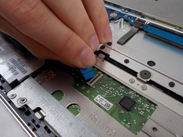

  4. HP Pavilion x360 14m-cd0003dx Touchpad Replacement, Touchpad: crwdns2935265:04crwdnd2935265:01crwdnd2935265:03crwdne2935265:0 HP Pavilion x360 14m-cd0003dx Touchpad Replacement, Touchpad: crwdns2935265:04crwdnd2935265:02crwdnd2935265:03crwdne2935265:0 HP Pavilion x360 14m-cd0003dx Touchpad Replacement, Touchpad: crwdns2935265:04crwdnd2935265:03crwdnd2935265:03crwdne2935265:0
    • Lift the black tab on the ZIF connector, and gently pull the track pad ribbon cable free.

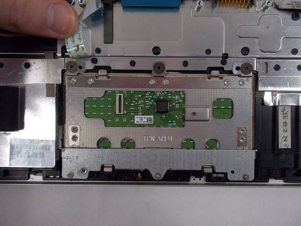

  5. HP Pavilion x360 14m-cd0003dx Touchpad Replacement: crwdns2935265:05crwdnd2935265:01crwdnd2935265:03crwdne2935265:0 HP Pavilion x360 14m-cd0003dx Touchpad Replacement: crwdns2935265:05crwdnd2935265:02crwdnd2935265:03crwdne2935265:0 HP Pavilion x360 14m-cd0003dx Touchpad Replacement: crwdns2935265:05crwdnd2935265:03crwdnd2935265:03crwdne2935265:0
    • Use a Phillips Head Screwdriver to remove the bottom 3 screws (5 mm).
    • Remove the metal plate that secures the touch pad.

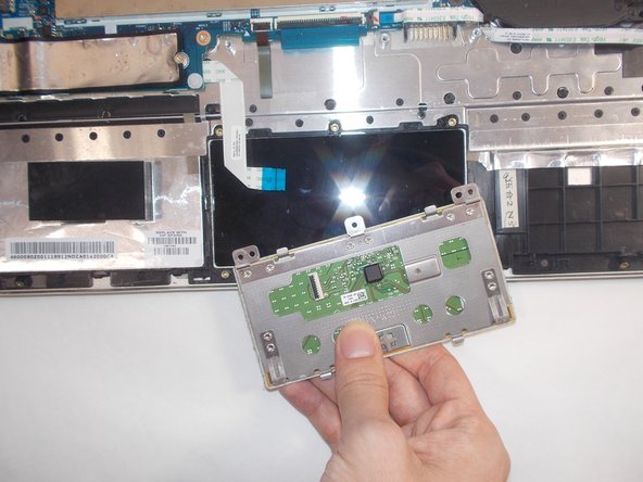

  6. HP Pavilion x360 14m-cd0003dx Touchpad Replacement: crwdns2935265:06crwdnd2935265:01crwdnd2935265:02crwdne2935265:0 HP Pavilion x360 14m-cd0003dx Touchpad Replacement: crwdns2935265:06crwdnd2935265:02crwdnd2935265:02crwdne2935265:0
    • Use a Phillips Head Screwdriver to unscrew top 3 screws (5 mm).
    • Remove touch pad.
