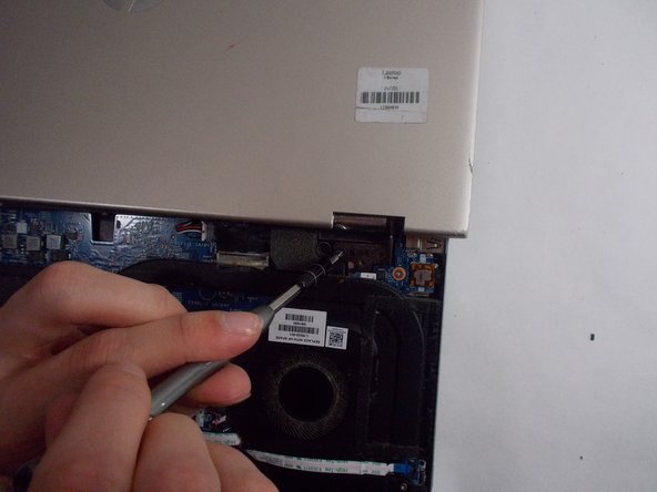

  4. HP Pavilion x360 14m-cd0003dx Hinges Replacement: crwdns2935265:04crwdnd2935265:01crwdnd2935265:02crwdne2935265:0 HP Pavilion x360 14m-cd0003dx Hinges Replacement: crwdns2935265:04crwdnd2935265:02crwdnd2935265:02crwdne2935265:0
    • The next few steps involve disconnecting the screen from the laptop in several places.
    • The first place is connected to the left side of the thin blue board at the top.
    • Peel back the clear adhesive and remove the pin header from the port on the blue board.
  5. HP Pavilion x360 14m-cd0003dx Hinges Replacement: crwdns2935265:05crwdnd2935265:01crwdnd2935265:02crwdne2935265:0 HP Pavilion x360 14m-cd0003dx Hinges Replacement: crwdns2935265:05crwdnd2935265:02crwdnd2935265:02crwdne2935265:0
    • The next place is underneath the gray adhesive. Peel back this adhesive to expose the connection underneath.
    • Disconnect the gold pin header from its port.
  6. HP Pavilion x360 14m-cd0003dx Hinges Replacement: crwdns2935265:06crwdnd2935265:01crwdnd2935265:01crwdne2935265:0
    • Repeat Step 4 for the connection on the right side.
    • Peel the clear adhesive and remove connection.
  7. HP Pavilion x360 14m-cd0003dx Hinges Replacement: crwdns2935265:07crwdnd2935265:01crwdnd2935265:03crwdne2935265:0 HP Pavilion x360 14m-cd0003dx Hinges Replacement: crwdns2935265:07crwdnd2935265:02crwdnd2935265:03crwdne2935265:0 HP Pavilion x360 14m-cd0003dx Hinges Replacement: crwdns2935265:07crwdnd2935265:03crwdnd2935265:03crwdne2935265:0
    • Peel the thin gray adhesive strips.
    • Pull out the thin black cable underneath these strips. It is the same black cable that was disconnected in the previous steps.
  8. HP Pavilion x360 14m-cd0003dx Hinges Replacement: crwdns2935265:08crwdnd2935265:01crwdnd2935265:01crwdne2935265:0
    • After the cable has been disconnected, the screen can be removed.

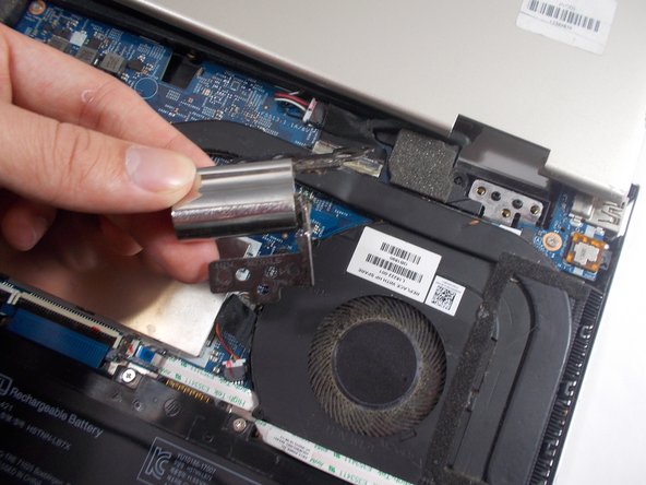

  12. HP Pavilion x360 14m-cd0003dx Hinges Replacement: crwdns2935265:012crwdnd2935265:01crwdnd2935265:02crwdne2935265:0 HP Pavilion x360 14m-cd0003dx Hinges Replacement: crwdns2935265:012crwdnd2935265:02crwdnd2935265:02crwdne2935265:0
    • Use a Phillips #00 screwdriver to remove the 5 mm screws from the hinges on each side inside the laptop.
  13. HP Pavilion x360 14m-cd0003dx Hinges Replacement: crwdns2935265:013crwdnd2935265:01crwdnd2935265:02crwdne2935265:0 HP Pavilion x360 14m-cd0003dx Hinges Replacement: crwdns2935265:013crwdnd2935265:02crwdnd2935265:02crwdne2935265:0
    • Remove the hinges from both sides of the laptop.
