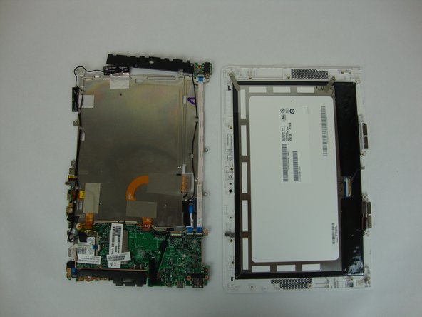

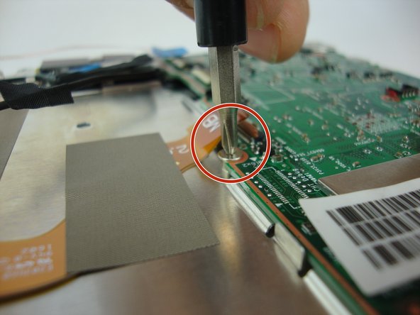

  6. HP Pavilion x2 10-n113dx Hinge Connector Replacement, Screen: crwdns2935265:06crwdnd2935265:01crwdnd2935265:03crwdne2935265:0 HP Pavilion x2 10-n113dx Hinge Connector Replacement, Screen: crwdns2935265:06crwdnd2935265:02crwdnd2935265:03crwdne2935265:0 HP Pavilion x2 10-n113dx Hinge Connector Replacement, Screen: crwdns2935265:06crwdnd2935265:03crwdnd2935265:03crwdne2935265:0
    • Using the Phillips #0 screwdriver, carefully remove the 21 screws that hold the screen to the display panel. 3.32 mm head, 3.99 mm length (RED) , 2.82 head 3.5 mm length (YELLOW), and 4.15 mm head, 2.35 mm length (BLUE).
    • 3.32 mm head, 3.99 mm length.
    • 2.82 head 3.5 mm length.
    • 4.15 mm head, 2.35 mm length.

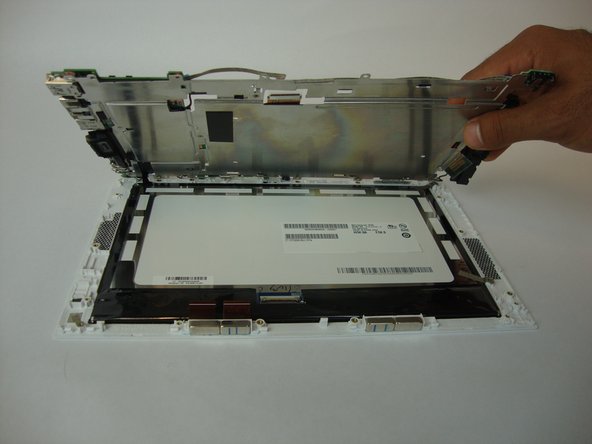

  7. HP Pavilion x2 10-n113dx Hinge Connector Replacement: crwdns2935265:07crwdnd2935265:01crwdnd2935265:03crwdne2935265:0 HP Pavilion x2 10-n113dx Hinge Connector Replacement: crwdns2935265:07crwdnd2935265:02crwdnd2935265:03crwdne2935265:0 HP Pavilion x2 10-n113dx Hinge Connector Replacement: crwdns2935265:07crwdnd2935265:03crwdnd2935265:03crwdne2935265:0
    • Very carefully lift the circuit board in order to keep everything attached. Be careful with any cables that may still be connected.

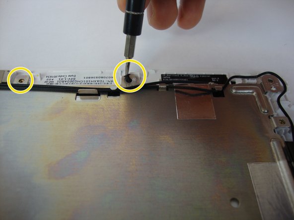

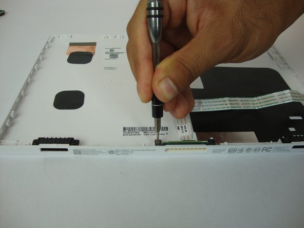

  8. HP Pavilion x2 10-n113dx Hinge Connector Replacement, Hinge connector: crwdns2935265:08crwdnd2935265:01crwdnd2935265:02crwdne2935265:0 HP Pavilion x2 10-n113dx Hinge Connector Replacement, Hinge connector: crwdns2935265:08crwdnd2935265:02crwdnd2935265:02crwdne2935265:0
    • Use the Phillips #0 screwdriver to unscrew 2 screws 2.82 mm head 3.5 mm length from the hinge connector

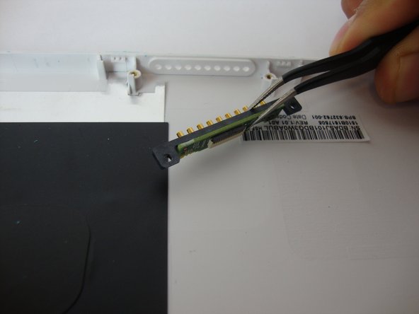

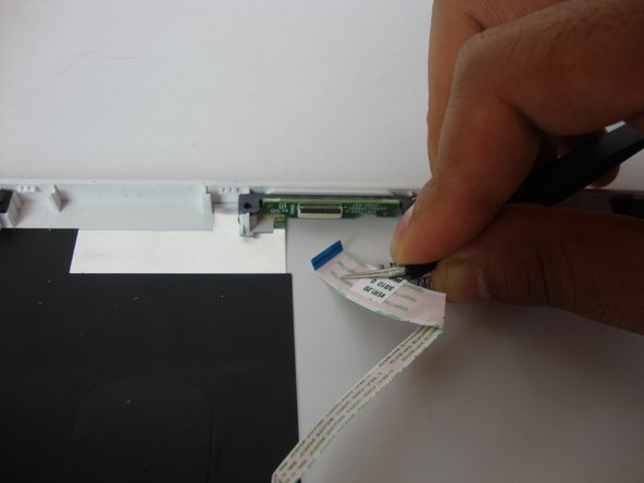

  9. HP Pavilion x2 10-n113dx Hinge Connector Replacement: crwdns2935265:09crwdnd2935265:01crwdnd2935265:02crwdne2935265:0 HP Pavilion x2 10-n113dx Hinge Connector Replacement: crwdns2935265:09crwdnd2935265:02crwdnd2935265:02crwdne2935265:0
    • Use the tweezers to gently remove the white pogo board ribbon from the hinge connector.
  10. HP Pavilion x2 10-n113dx Hinge Connector Replacement: crwdns2935265:010crwdnd2935265:01crwdnd2935265:02crwdne2935265:0 HP Pavilion x2 10-n113dx Hinge Connector Replacement: crwdns2935265:010crwdnd2935265:02crwdnd2935265:02crwdne2935265:0
    • Gently remove the hinge connector from the display panel.
