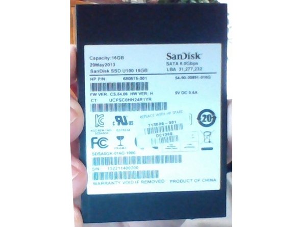

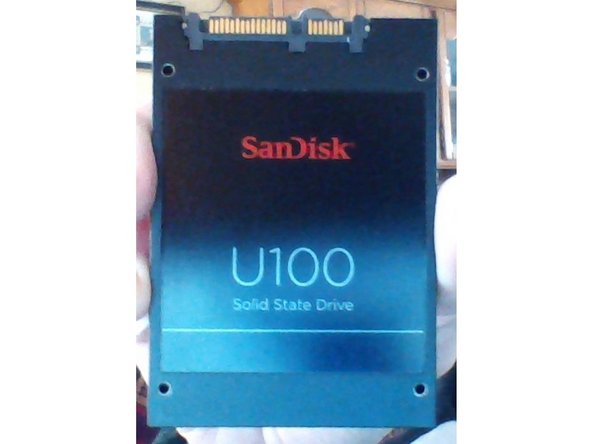

  3. HP Pavilion Chromebook 14-c050nr RAM & SSD upgrade procedure., SSD used: crwdns2935265:03crwdnd2935265:01crwdnd2935265:03crwdne2935265:0 HP Pavilion Chromebook 14-c050nr RAM & SSD upgrade procedure., SSD used: crwdns2935265:03crwdnd2935265:02crwdnd2935265:03crwdne2935265:0 HP Pavilion Chromebook 14-c050nr RAM & SSD upgrade procedure., SSD used: crwdns2935265:03crwdnd2935265:03crwdnd2935265:03crwdne2935265:0
    • SanDisk 128GB SATA 6.0GB/s 2.5-Inch 7mm Height Solid State Drive (SSD) With Read Up To 475MB/s- SDSSDP-128G-G25
    • Above SSD was sourced from amazon you may find a better deal elsewhere.
    • Actual original SSD is pictured. However box shown is the upgrade SSD box.

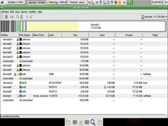

  4. HP Pavilion Chromebook 14-c050nr RAM & SSD upgrade procedure., Don't skip the following pre upgrade operations!!!: crwdns2935265:04crwdnd2935265:01crwdnd2935265:02crwdne2935265:0 HP Pavilion Chromebook 14-c050nr RAM & SSD upgrade procedure., Don't skip the following pre upgrade operations!!!: crwdns2935265:04crwdnd2935265:02crwdnd2935265:02crwdne2935265:0
    • Make a backup of existing SSD so you can restore the chromeos image into the new SSD. The backup is done with the "Chromebook Recovery Utility" from chrome web store as shown in 1st image. You will need a empty 4gb thumb drive.
    • Write an empty partition table on your new drive before installing it. You will need a linux system with a usable SATA interface and the gparted software to perform this step.
    • The drive will not be recognized by the system without this empty table!!!! Second image is the "gparted" software screen shot.
    • You merely need to point the gparted software to the new raw device file and the partition table will be created if it does not exist (it should not if this is a new drive). If it DOES already exist you should clear it so that chrome can initialize it correctly for you later (hint: delete key press to remove a selected existing table row).

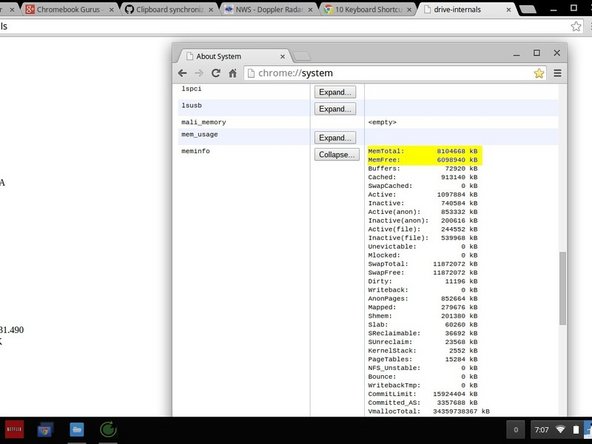

  5. HP Pavilion Chromebook 14-c050nr RAM & SSD upgrade procedure., Restore chromeos from recovery media!: crwdns2935265:05crwdnd2935265:01crwdnd2935265:02crwdne2935265:0 HP Pavilion Chromebook 14-c050nr RAM & SSD upgrade procedure., Restore chromeos from recovery media!: crwdns2935265:05crwdnd2935265:02crwdnd2935265:02crwdne2935265:0
    • You will be prompted on your first bootup to the new drive for the media to restore onto your upgraded SSD device. You should have created that in the step 4 above before you actually upgraded your hardware. If you did not create the backup you will have to reinstall your original SSD and start over. I told you to read all the steps didn't I ?
    • The images show you where to look to see if your upgrades are working in the chromeos system URL. Just threw this in FYI
    • If all is well, like my screen shots indicate, you can install crouton and ubuntu and virtualbox and do real computing with your chromebook now!!!!!

The partition size is governed by the size of the SSD you install. ChromeOS does this for you when you restore from your ChromeOS image media. I got 107 GB of free formatted space from a 128 GB SSD as you can see above. This seems about right given the original SSD was 16 GB.
