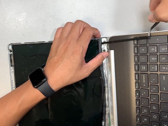

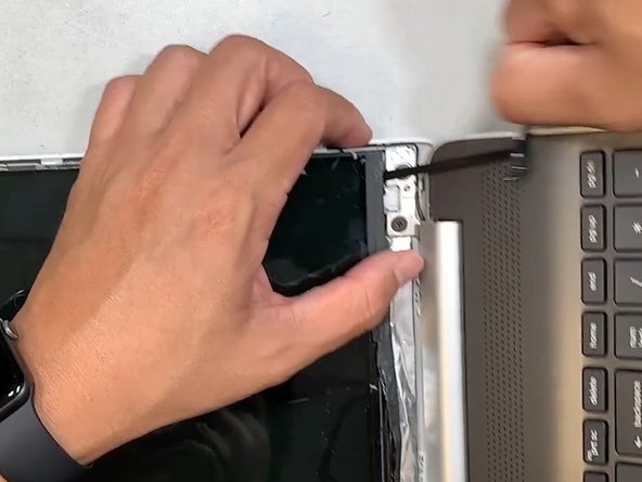

    • Open the laptop so the screen is in an upright position.
    • Use a spudger on the underside of the bezel to release the clips securing it to the screen assembly.
    • Work your way around the entire bezel until the bezel is free.

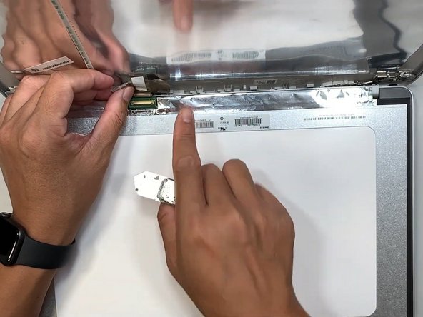

    • Use tweezers to remove the double-sided tape underneath the four corners of the display screen.
    • If you tear the tape, it is okay, it will just be moderately more challenging to pull the display screen off from the laptop.
  4. HP Pavilion 15 dyl1087nr Screen Replacement: crwdns2935265:04crwdnd2935265:01crwdnd2935265:02crwdne2935265:0 HP Pavilion 15 dyl1087nr Screen Replacement: crwdns2935265:04crwdnd2935265:02crwdnd2935265:02crwdne2935265:0

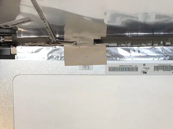

    • Flip the display screen over facedown to reveal the tape connecting the screen to the rest of the computer.
  5. HP Pavilion 15 dyl1087nr Screen Replacement: crwdns2935265:05crwdnd2935265:01crwdnd2935265:03crwdne2935265:0 HP Pavilion 15 dyl1087nr Screen Replacement: crwdns2935265:05crwdnd2935265:02crwdnd2935265:03crwdne2935265:0 HP Pavilion 15 dyl1087nr Screen Replacement: crwdns2935265:05crwdnd2935265:03crwdnd2935265:03crwdne2935265:0

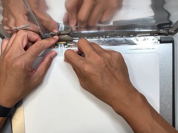

    • Remove the tape covering the display cable connector.
    • Use your spudger to detach the display cable connector. First, gently push the tip of a spudger under the metal buckle to unclip it, then swing it over the socket.
    • Next, hold the buckle and cable together and gently pull the connector straight out of its socket.
    • Grip the cable and buckle together and insert the connector fully into its socket.
    • Aligning the connector can be tricky. Reposition it as necessary and don't try to force it into the socket, or you may damage both the connector and its socket.
    • Flip the buckle over the socket and use a spudger to press the buckle down until it clicks into place.
