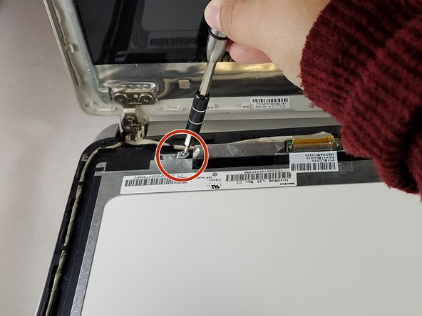

    • Remove the four 2.86 mm JIS#0 screws from each corner of the silver frame that is holding the digitizer.
  12. HP Pavilion 14-v062us Screen Replacement: crwdns2935265:012crwdnd2935265:01crwdnd2935265:02crwdne2935265:0 HP Pavilion 14-v062us Screen Replacement: crwdns2935265:012crwdnd2935265:02crwdnd2935265:02crwdne2935265:0
    • Locate the white and brown wiring that connects to the digitizer and the screen.
    • Cut through the clear part of tape attached to the brown latch and white wiring.
    • Disconnect the wiring, by lifting the brown latch with the blue plastic opening tool and pulling the white wire at the same time.
    • Lift off the digitizer. If you need to replace the digitizer stop here and replace this part.
    • If you need to replace the screen, then continue

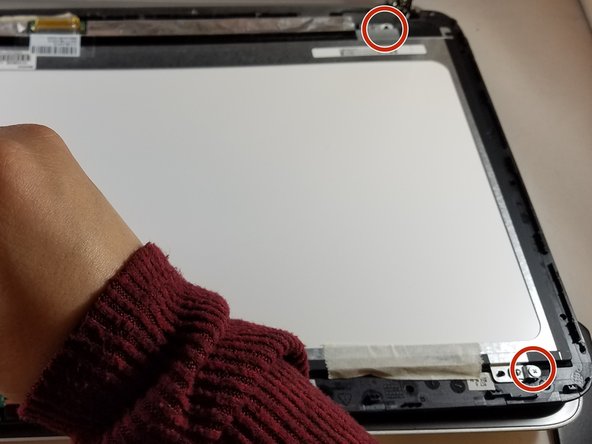

  13. HP Pavilion 14-v062us Screen Replacement: crwdns2935265:013crwdnd2935265:01crwdnd2935265:01crwdne2935265:0
    • Remove the four 5.66 mm PH#0 from under the keyboard near the hinges.
  14. HP Pavilion 14-v062us Screen Replacement: crwdns2935265:014crwdnd2935265:01crwdnd2935265:03crwdne2935265:0 HP Pavilion 14-v062us Screen Replacement: crwdns2935265:014crwdnd2935265:02crwdnd2935265:03crwdne2935265:0 HP Pavilion 14-v062us Screen Replacement: crwdns2935265:014crwdnd2935265:03crwdnd2935265:03crwdne2935265:0
    • Wedge spudger in between screen and back of computer
    • Only use a metal spudger as a last resort. A regular black nylon spudger or a plastic opening tool should be used whenever possible
    • Detach screen
