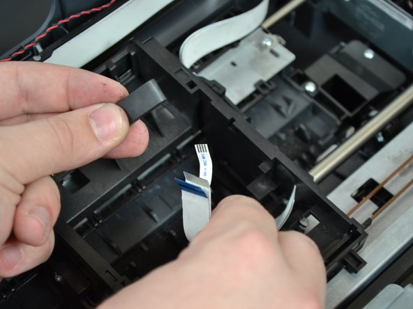

  19. HP Officejet Pro 6835 Carriage Replacement: crwdns2935265:019crwdnd2935265:01crwdnd2935265:02crwdne2935265:0 HP Officejet Pro 6835 Carriage Replacement: crwdns2935265:019crwdnd2935265:02crwdnd2935265:02crwdne2935265:0
    • Turn the carriage on its side with the ends of the cables on the top side.
    • Using the tweezers, remove one side of the black bracket by pushing the side closest to you downwards.
    • Repeat this process on the far side to remove the bracket completely.

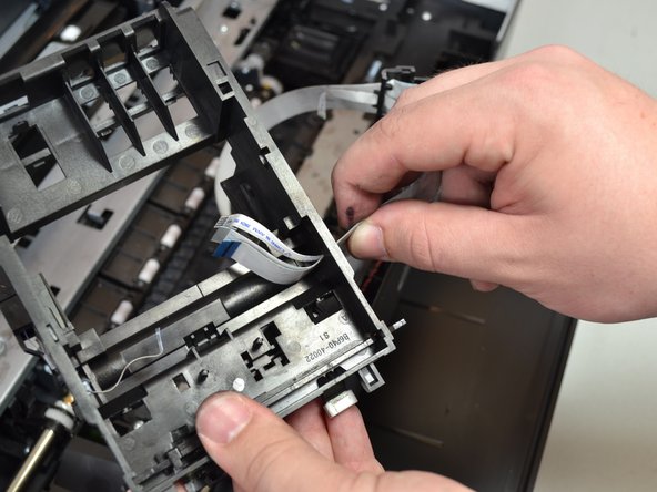

  20. HP Officejet Pro 6835 Carriage Replacement: crwdns2935265:020crwdnd2935265:01crwdnd2935265:03crwdne2935265:0 HP Officejet Pro 6835 Carriage Replacement: crwdns2935265:020crwdnd2935265:02crwdnd2935265:03crwdne2935265:0 HP Officejet Pro 6835 Carriage Replacement: crwdns2935265:020crwdnd2935265:03crwdnd2935265:03crwdne2935265:0
    • Hold the ribbon cables with one hand and use the other hand to pull off the plastic bracket.
    • It may be helpful to take the cables out one at a time if you can't fit them all through at once.

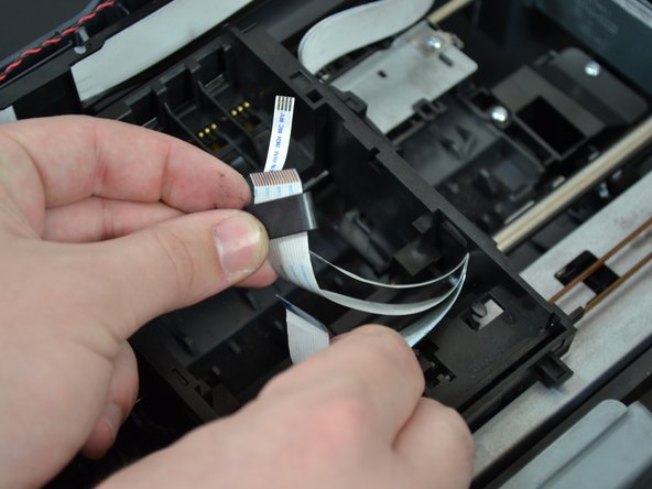

  21. HP Officejet Pro 6835 Carriage Replacement: crwdns2935265:021crwdnd2935265:01crwdnd2935265:02crwdne2935265:0 HP Officejet Pro 6835 Carriage Replacement: crwdns2935265:021crwdnd2935265:02crwdnd2935265:02crwdne2935265:0
    • Pull the cables out of the carrier by gripping the carrier with one hand and pulling all of the cables together with your other hand in the opposite direction.

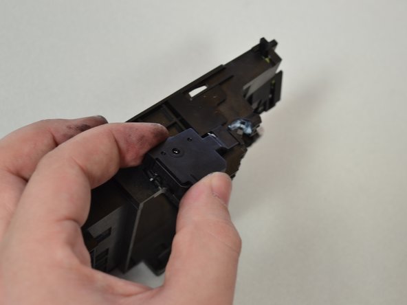

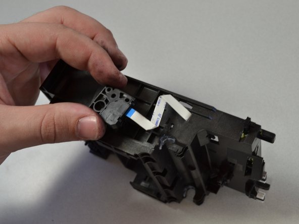

  22. HP Officejet Pro 6835 Carriage Replacement: crwdns2935265:022crwdnd2935265:01crwdnd2935265:03crwdne2935265:0 HP Officejet Pro 6835 Carriage Replacement: crwdns2935265:022crwdnd2935265:02crwdnd2935265:03crwdne2935265:0 HP Officejet Pro 6835 Carriage Replacement: crwdns2935265:022crwdnd2935265:03crwdnd2935265:03crwdne2935265:0
    • Flip the carrier on the side.
    • Remove the screw (T6 6mm) on the side of the carrier by turning the screwdriver counterclockwise.
    • Lift off the plastic cover by pulling it up off the carrier.
    • Remove the black latch by pulling the ribbon cable out of the carrier by pulling straight up.
