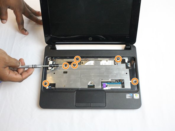

  4. HP Mini 110-3131dx Touchpad Replacement, Keyboard Bezel: crwdns2935265:05crwdnd2935265:01crwdnd2935265:02crwdne2935265:0 HP Mini 110-3131dx Touchpad Replacement, Keyboard Bezel: crwdns2935265:05crwdnd2935265:02crwdnd2935265:02crwdne2935265:0
    • Remove the six black screws around the perimeter of the laptop using a Phillips #1 screwdriver.
    • Be sure to keep track of which screws go where as they are not all the same size.
    • Flip the laptop over and remove the six black screws.

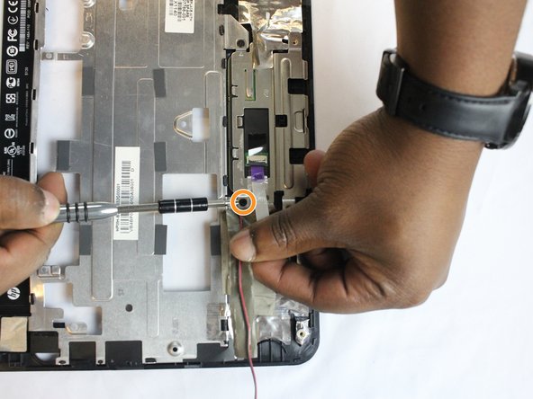

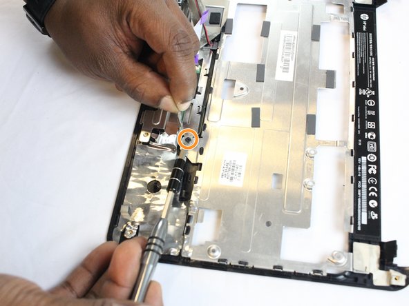

  7. HP Mini 110-3131dx Touchpad Replacement, Touchpad: crwdns2935265:08crwdnd2935265:01crwdnd2935265:03crwdne2935265:0 HP Mini 110-3131dx Touchpad Replacement, Touchpad: crwdns2935265:08crwdnd2935265:02crwdnd2935265:03crwdne2935265:0 HP Mini 110-3131dx Touchpad Replacement, Touchpad: crwdns2935265:08crwdnd2935265:03crwdnd2935265:03crwdne2935265:0
    • Turn the keyboard so that the touchpad is close to you.
    • Detach the ribbon cable from the connector on the touchpad circuit board using your fingernail or an opening tool.
    • Remove the four 2.9 mm screws from the bracket using a Phillips #0 screwdriver.
    • Remove the touchpad from the top of the keyboard bezel on the touch-sensitive side.
