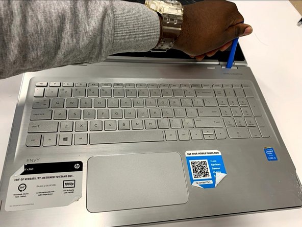

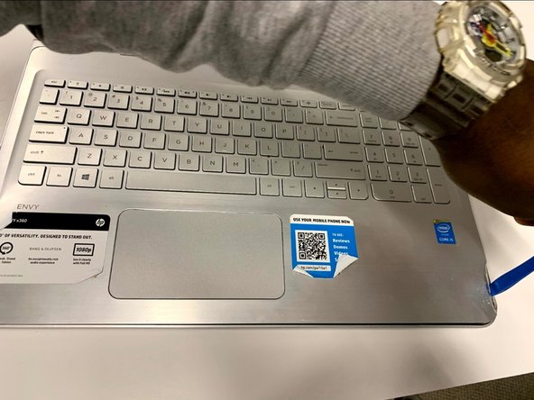

  4. HP Envy x360 m6-w101dx Keyboard Panel Replacement: crwdns2935265:04crwdnd2935265:01crwdnd2935265:03crwdne2935265:0 HP Envy x360 m6-w101dx Keyboard Panel Replacement: crwdns2935265:04crwdnd2935265:02crwdnd2935265:03crwdne2935265:0 HP Envy x360 m6-w101dx Keyboard Panel Replacement: crwdns2935265:04crwdnd2935265:03crwdnd2935265:03crwdne2935265:0
    • Pry open a gap in the edge of the keyboard with an iFixit opening tool.
  5. HP Envy x360 m6-w101dx Keyboard Panel Replacement: crwdns2935265:05crwdnd2935265:01crwdnd2935265:01crwdne2935265:0
    • Remove the keyboard from the laptop.
