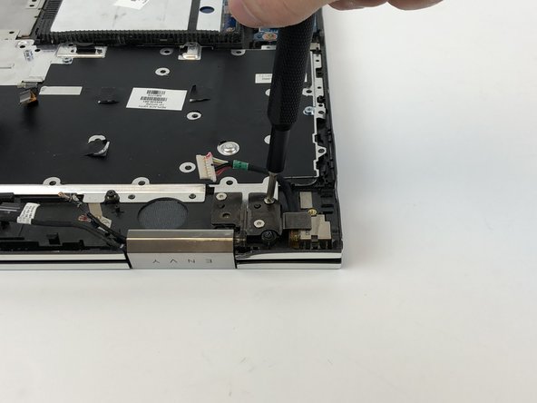

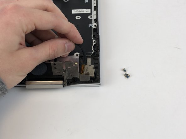

  14. HP Envy x360 15m-bq021dx Power Input Replacement, Power Input: crwdns2935265:014crwdnd2935265:01crwdnd2935265:03crwdne2935265:0 HP Envy x360 15m-bq021dx Power Input Replacement, Power Input: crwdns2935265:014crwdnd2935265:02crwdnd2935265:03crwdne2935265:0 HP Envy x360 15m-bq021dx Power Input Replacement, Power Input: crwdns2935265:014crwdnd2935265:03crwdnd2935265:03crwdne2935265:0

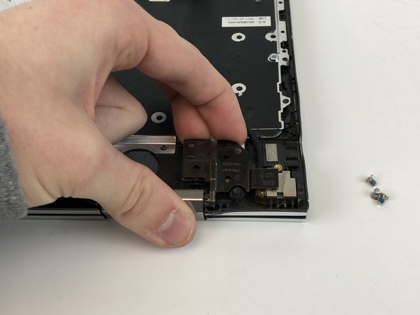

    • Remove the three M2.0x3.2 hinge screws next to the power input cord using a Philips #0 screwdriver.
    • Pry the hinge up so that it is out of the way.

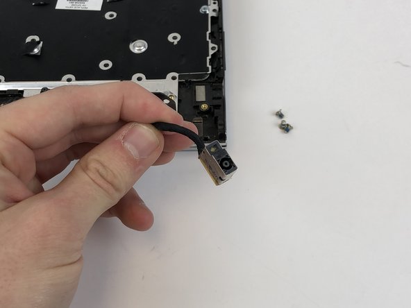

  15. HP Envy x360 15m-bq021dx Power Input Replacement: crwdns2935265:015crwdnd2935265:01crwdnd2935265:03crwdne2935265:0 HP Envy x360 15m-bq021dx Power Input Replacement: crwdns2935265:015crwdnd2935265:02crwdnd2935265:03crwdne2935265:0 HP Envy x360 15m-bq021dx Power Input Replacement: crwdns2935265:015crwdnd2935265:03crwdnd2935265:03crwdne2935265:0
    • Lift out the power input.
