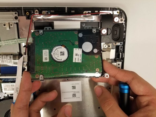

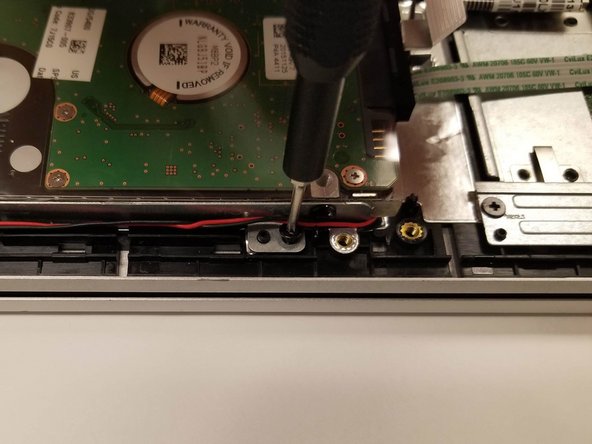

  9. HP Envy m6-p114dx Hard drive Replacement, Hard drive: crwdns2935265:09crwdnd2935265:01crwdnd2935265:03crwdne2935265:0 HP Envy m6-p114dx Hard drive Replacement, Hard drive: crwdns2935265:09crwdnd2935265:02crwdnd2935265:03crwdne2935265:0 HP Envy m6-p114dx Hard drive Replacement, Hard drive: crwdns2935265:09crwdnd2935265:03crwdnd2935265:03crwdne2935265:0
    • There are wires over some of the screws, use a thin implement to get the wires out of their track.
    • Unplug the SATA cable from the motherboard (covered in the teardown for the battery).
    • Remove the 4 screws
    • Remove the Hard drive from the unit
