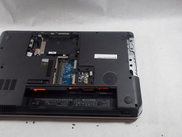

    • Flip the device upside-down so that its bottom is facing up.
  2. HP Envy dv6-7363cl Fan Replacement: crwdns2935265:02crwdnd2935265:01crwdnd2935265:01crwdne2935265:0
    • Push the lever underneath the battery to the left.
  3. HP Envy dv6-7363cl Fan Replacement: crwdns2935265:03crwdnd2935265:01crwdnd2935265:02crwdne2935265:0 HP Envy dv6-7363cl Fan Replacement: crwdns2935265:03crwdnd2935265:02crwdnd2935265:02crwdne2935265:0
    • Lift the battery up out of its socket.
  4. HP Envy dv6-7363cl Fan Replacement, Fan: crwdns2935265:04crwdnd2935265:01crwdnd2935265:01crwdne2935265:0
    • Remove the circled screws from the back panel.

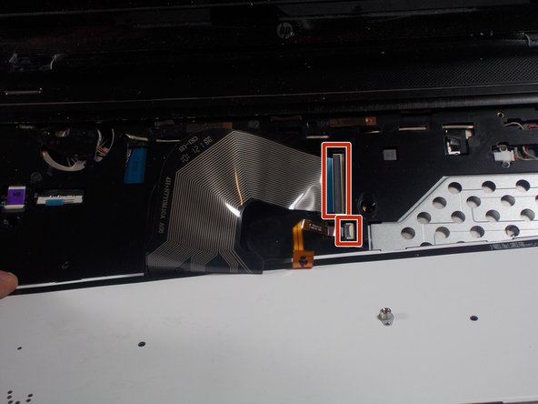

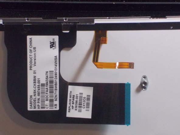

    • Flip the laptop back over and carefully pry the keyboard frame out of the device.
  7. HP Envy dv6-7363cl Fan Replacement: crwdns2935265:07crwdnd2935265:01crwdnd2935265:03crwdne2935265:0 HP Envy dv6-7363cl Fan Replacement: crwdns2935265:07crwdnd2935265:02crwdnd2935265:03crwdne2935265:0 HP Envy dv6-7363cl Fan Replacement: crwdns2935265:07crwdnd2935265:03crwdnd2935265:03crwdne2935265:0
    • Lift the keyboard out of the device
    • Carefully remove ribbon cables.
  8. HP Envy dv6-7363cl Fan Replacement: crwdns2935265:08crwdnd2935265:01crwdnd2935265:03crwdne2935265:0 HP Envy dv6-7363cl Fan Replacement: crwdns2935265:08crwdnd2935265:02crwdnd2935265:03crwdne2935265:0 HP Envy dv6-7363cl Fan Replacement: crwdns2935265:08crwdnd2935265:03crwdnd2935265:03crwdne2935265:0

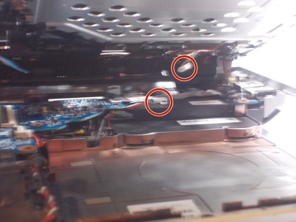

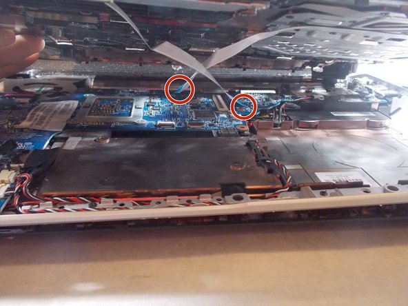

    • Disconnect red and white cords from blue circuit board.
  13. HP Envy dv6-7363cl Fan Replacement: crwdns2935265:013crwdnd2935265:01crwdnd2935265:03crwdne2935265:0 HP Envy dv6-7363cl Fan Replacement: crwdns2935265:013crwdnd2935265:02crwdnd2935265:03crwdne2935265:0 HP Envy dv6-7363cl Fan Replacement: crwdns2935265:013crwdnd2935265:03crwdnd2935265:03crwdne2935265:0
    • Gently pull circled pieces from their holsters.
  14. HP Envy dv6-7363cl Fan Replacement: crwdns2935265:014crwdnd2935265:01crwdnd2935265:02crwdne2935265:0 HP Envy dv6-7363cl Fan Replacement: crwdns2935265:014crwdnd2935265:02crwdnd2935265:02crwdne2935265:0

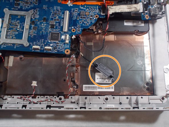

    • Turn device onto its back and remove circled screws from Wi-Fi card.
    • Flip device back over and unscrew disk reader

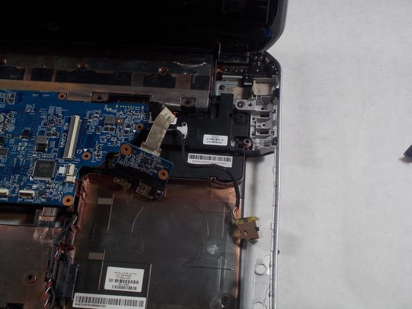

  15. HP Envy dv6-7363cl Fan Replacement: crwdns2935265:015crwdnd2935265:01crwdnd2935265:01crwdne2935265:0
    • Remove circled screws from blue circuit board and lift fan assembly out of device.
