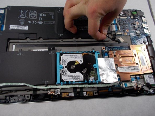

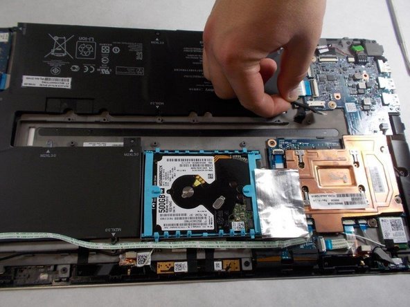

  11. HP Envy X2-15-C001Dx Battery Replacement, Battery: crwdns2935265:011crwdnd2935265:01crwdnd2935265:03crwdne2935265:0 HP Envy X2-15-C001Dx Battery Replacement, Battery: crwdns2935265:011crwdnd2935265:02crwdnd2935265:03crwdne2935265:0 HP Envy X2-15-C001Dx Battery Replacement, Battery: crwdns2935265:011crwdnd2935265:03crwdnd2935265:03crwdne2935265:0
    • Gently unplug the battery connector from the motherboard by carefully gripping the connector and pulling it straight out. Avoid tugging on the wires to prevent damage. Ensure the connector is fully detached before proceeding with any further steps.

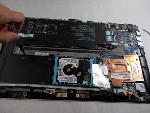

  12. HP Envy X2-15-C001Dx Battery Replacement: crwdns2935265:012crwdnd2935265:01crwdnd2935265:02crwdne2935265:0 HP Envy X2-15-C001Dx Battery Replacement: crwdns2935265:012crwdnd2935265:02crwdnd2935265:02crwdne2935265:0
    • Using a functioning screwdriver i.e Phillips #1 screwdriver, carefully remove the eight screws securing the battery to the device. Unscrew each one slowly and set them aside in a safe spot, like a small container, to prevent loss. Ensure all screws are completely removed and that the battery is fully detached before proceeding to lift it out.

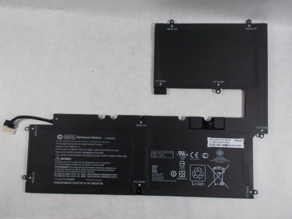

  13. HP Envy X2-15-C001Dx Battery Replacement: crwdns2935265:013crwdnd2935265:01crwdnd2935265:02crwdne2935265:0 HP Envy X2-15-C001Dx Battery Replacement: crwdns2935265:013crwdnd2935265:02crwdnd2935265:02crwdne2935265:0
    • Carefully remove the battery by gently lifting it out of the device. Ensure there are no remaining screws or cables attached before lifting. Hold the battery securely with both hands to avoid dropping or damaging it, and place it on a clean, static-free surface for safety.
