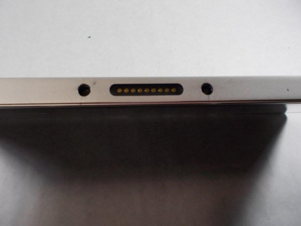

    • Remove two side screws using a Phillips #1 screwdriver.
  9. HP Envy X2-15-C001Dx Audio Board Replacement: crwdns2935265:09crwdnd2935265:01crwdnd2935265:02crwdne2935265:0 HP Envy X2-15-C001Dx Audio Board Replacement: crwdns2935265:09crwdnd2935265:02crwdnd2935265:02crwdne2935265:0

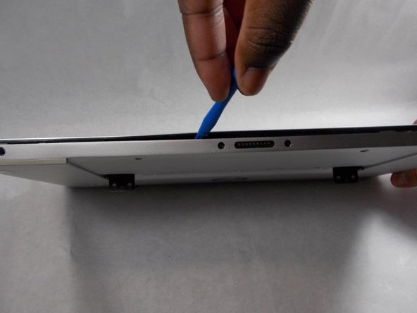

    • Pry apart the base from the screen by going around the entire perimeter with an opening tool.
  10. HP Envy X2-15-C001Dx Audio Board Replacement: crwdns2935265:010crwdnd2935265:01crwdnd2935265:02crwdne2935265:0 HP Envy X2-15-C001Dx Audio Board Replacement: crwdns2935265:010crwdnd2935265:02crwdnd2935265:02crwdne2935265:0
    • Remove the back panel from the laptop.

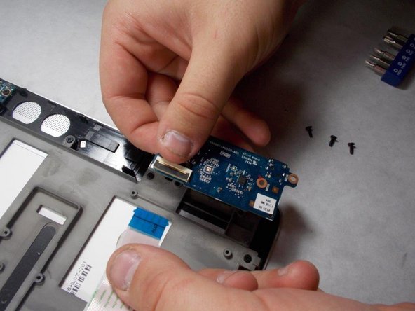

  11. HP Envy X2-15-C001Dx Audio Board Replacement, Audio Board: crwdns2935265:011crwdnd2935265:01crwdnd2935265:02crwdne2935265:0 HP Envy X2-15-C001Dx Audio Board Replacement, Audio Board: crwdns2935265:011crwdnd2935265:02crwdnd2935265:02crwdne2935265:0
    • Remove the three 6 mm screws from the audio board using a Phillips #1 screwdriver.

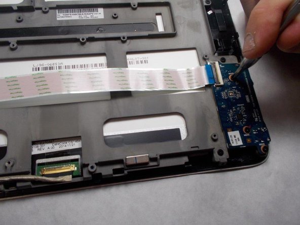

  12. HP Envy X2-15-C001Dx Audio Board Replacement: crwdns2935265:012crwdnd2935265:01crwdnd2935265:02crwdne2935265:0 HP Envy X2-15-C001Dx Audio Board Replacement: crwdns2935265:012crwdnd2935265:02crwdnd2935265:02crwdne2935265:0
    • Flip up the black retaining flap securing the audio board's ribbon cable.
    • Slide the ribbon cable out of its connector on the audio board.
  13. HP Envy X2-15-C001Dx Audio Board Replacement: crwdns2935265:013crwdnd2935265:01crwdnd2935265:01crwdne2935265:0
    • Remove the audio board from the laptop.
