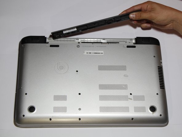

    • Pivot the loose edge of the battery closes to you by pushing it toward the back of the computer.
    • The battery should slide out freely.
    • If battery is not pivoted before sliding out, you risk breaking interlocking tabs on the battery or computer.

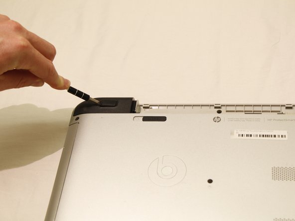

  4. HP Envy TouchSmart m7 k010dx KeyBoard Replacement, Keyboard: crwdns2935265:04crwdnd2935265:01crwdnd2935265:03crwdne2935265:0 HP Envy TouchSmart m7 k010dx KeyBoard Replacement, Keyboard: crwdns2935265:04crwdnd2935265:02crwdnd2935265:03crwdne2935265:0 HP Envy TouchSmart m7 k010dx KeyBoard Replacement, Keyboard: crwdns2935265:04crwdnd2935265:03crwdnd2935265:03crwdne2935265:0

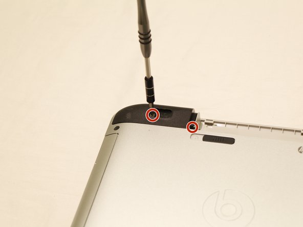

    • With the computer turned over use a nylon spudger to pry the rectangular pads off to reveal two hidden screws.
    • Using a Phillips #0 screwdriver, remove the screw that is beneath the black rubber pad, as well as the other holding down the black corner plastic pieces on both the left and right sides.

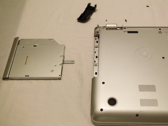

    • Using the Phillips #0 screwdriver, remove the screw in the center of the computer, and to the right of the Beats logo.
    • Use your fingernails to pull out the optical drive. It will have some resistance to start, but will come out easily afterwards.

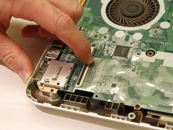

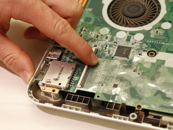

    • The two panels are connected with 4 flexible electrical ribbon strips. The ribbon strips have a locking tab that will need to be disengaged prior to removal. Using fingers, begin by removing the two strips nearest to the opening.
    • Picture 3 shows the tab unlocked

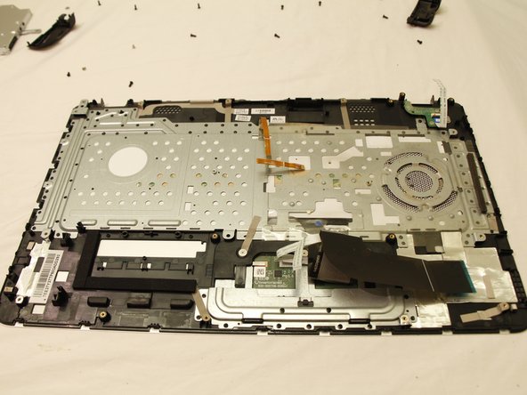

  11. HP Envy TouchSmart m7 k010dx KeyBoard Replacement: crwdns2935265:011crwdnd2935265:01crwdnd2935265:02crwdne2935265:0 HP Envy TouchSmart m7 k010dx KeyBoard Replacement: crwdns2935265:011crwdnd2935265:02crwdnd2935265:02crwdne2935265:0
    • With the two panels now separated, you can see the other two strips towards the back of the computer. With finger, carefully release each strip from the locking tab.
    • Once all are unplugged, carefully remove the top case.
