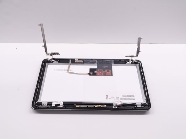

    • Close the laptop so the front is facing you.
    • Remove the four 3 mm screws from the two brackets at the front using a Phillips #0 screwdriver.
    • Remove the brackets.
  4. HP Envy TouchSmart 4-1215dx Display Replacement: crwdns2935265:04crwdnd2935265:01crwdnd2935265:03crwdne2935265:0 HP Envy TouchSmart 4-1215dx Display Replacement: crwdns2935265:04crwdnd2935265:02crwdnd2935265:03crwdne2935265:0 HP Envy TouchSmart 4-1215dx Display Replacement: crwdns2935265:04crwdnd2935265:03crwdnd2935265:03crwdne2935265:0
    • Remove the 3 mm screws from the back brackets using a Phillips #0 screwdriver.
    • Remove the 1 mm screws with a Phillips #00 screwdriver.
    • Lift up the display until the brackets are sticking straight up.

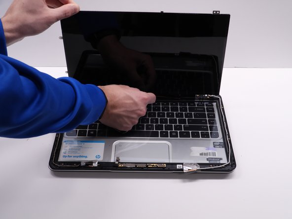

    • Peel off the aluminum tape located at the top of the display.
  6. HP Envy TouchSmart 4-1215dx Display Replacement: crwdns2935265:06crwdnd2935265:01crwdnd2935265:02crwdne2935265:0 HP Envy TouchSmart 4-1215dx Display Replacement: crwdns2935265:06crwdnd2935265:02crwdnd2935265:02crwdne2935265:0
    • Disconnect the ribbon cable and peel off the connected tape from the display.
  7. HP Envy TouchSmart 4-1215dx Display Replacement: crwdns2935265:07crwdnd2935265:01crwdnd2935265:02crwdne2935265:0 HP Envy TouchSmart 4-1215dx Display Replacement: crwdns2935265:07crwdnd2935265:02crwdnd2935265:02crwdne2935265:0

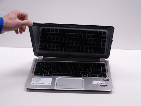

    • Lift the display up separately from the screen.
    • Peel off the orange tape at the bottom of the display connecting to the laptop.
  8. HP Envy TouchSmart 4-1215dx Display Replacement: crwdns2935265:08crwdnd2935265:01crwdnd2935265:01crwdne2935265:0
    • Lift up the display.
    • If your display is cracked or shattered, you should tape up the effected parts in order to avoid injury.
