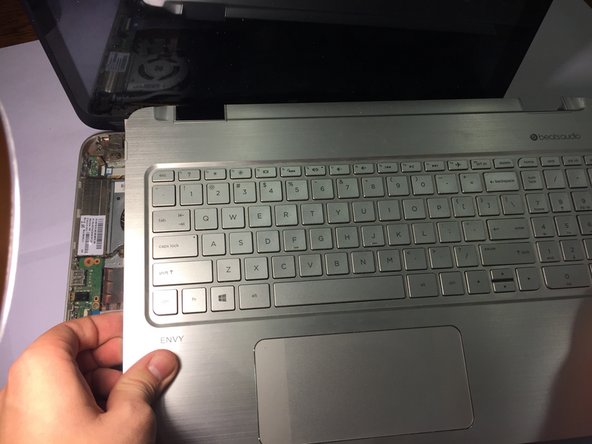

    • Once all of the screws have come out, flip the laptop over and open the lid so that the keyboard is face up.
    • Pop the keyboard from the sides and carefully lift it off of the parts underneath.
    • DO NOT pull the keyboard away from the rest of the laptop too quickly. There are various cords and wires connecting the keyboard section to the rest of the computer that should remain plugged in.
  6. HP Envy Battery Replacement: crwdns2935265:06crwdnd2935265:01crwdnd2935265:01crwdne2935265:0
    • Carefully lay the keyboard section against the open screen of your laptop without unplugging anything.

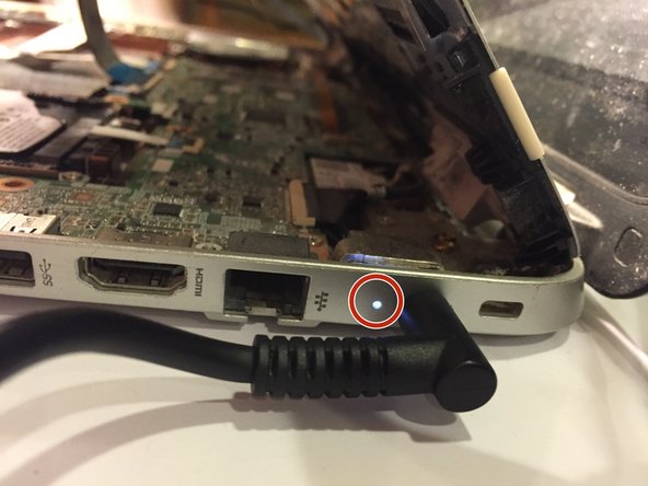

    • Once the battery is safely removed, plug the charging cord into the charging port on the side and plug the other end into the wall.
    • DO NOT turn the computer on or touch any of the internal components during this step.
    • If the light is on after plugging it in, you have just confirmed that something is wrong with the battery, which means you're on the right track!
    • If the light on the side blinks upon plugging it in, the battery is not the problem. If that is the case, put your laptop back together and consult an expert.
    • Unplug the charging cable.

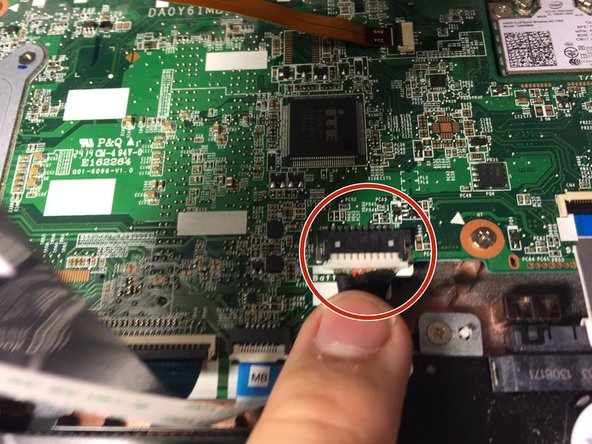

    • Place the battery back where it was previously and find where it was plugged in.
    • Due to general wear and tear, often this will become slightly unplugged, causing the laptop to fail to charge properly.
    • Plug the cable on the battery back into the port on the motherboard and make sure it is secured.
  10. HP Envy Battery Replacement: crwdns2935265:010crwdnd2935265:01crwdnd2935265:01crwdne2935265:0
    • Run the earlier test from Step 7 that you performed on the laptop with the battery inside.
    • If the light comes on and doesn't blink, you have fixed the problem! Congratulations!
    • If the light still blinks, you may have to purchase a new battery for your laptop.
