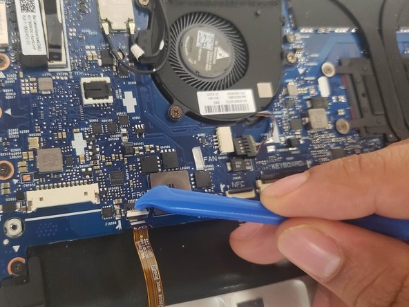

  6. HP Elitebook x360 1040 G5 Motherboard Replacement: crwdns2935265:06crwdnd2935265:01crwdnd2935265:03crwdne2935265:0 HP Elitebook x360 1040 G5 Motherboard Replacement: crwdns2935265:06crwdnd2935265:02crwdnd2935265:03crwdne2935265:0 HP Elitebook x360 1040 G5 Motherboard Replacement: crwdns2935265:06crwdnd2935265:03crwdnd2935265:03crwdne2935265:0
    • Remove the three white and two brown ribbon cables located on the bottom of the motherboard.
    • Use a spudger to carefully push on each side of the connector in order to release the cable.

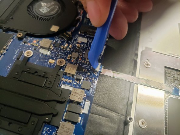

  8. HP Elitebook x360 1040 G5 Motherboard Replacement: crwdns2935265:08crwdnd2935265:01crwdnd2935265:02crwdne2935265:0 HP Elitebook x360 1040 G5 Motherboard Replacement: crwdns2935265:08crwdnd2935265:02crwdnd2935265:02crwdne2935265:0
    • Remove the foil protector from the right side of the motherboard by gently peeling it back with the opening tool.
    • Remove the ribbon connector underneath using the spudger.
