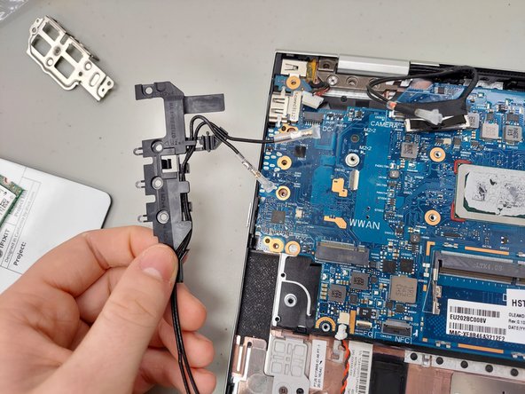

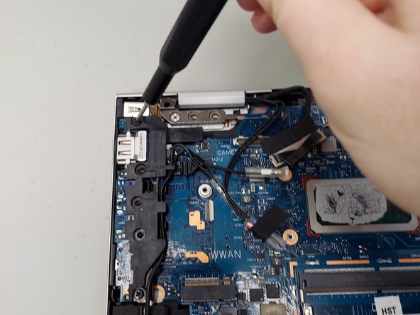

  19. HP EliteBook x360 830 G7 Motherboard Replacement: crwdns2935265:019crwdnd2935265:01crwdnd2935265:03crwdne2935265:0 HP EliteBook x360 830 G7 Motherboard Replacement: crwdns2935265:019crwdnd2935265:02crwdnd2935265:03crwdne2935265:0 HP EliteBook x360 830 G7 Motherboard Replacement: crwdns2935265:019crwdnd2935265:03crwdnd2935265:03crwdne2935265:0
    • Use a JIS #1 screwdrivers to remove five screws securing the plastic bracket.
    • Remove plastic bracket.

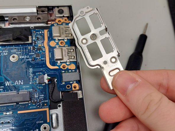

  20. HP EliteBook x360 830 G7 Motherboard Replacement: crwdns2935265:020crwdnd2935265:01crwdnd2935265:02crwdne2935265:0 HP EliteBook x360 830 G7 Motherboard Replacement: crwdns2935265:020crwdnd2935265:02crwdnd2935265:02crwdne2935265:0
    • Use the JIS #1 screwdriver to remove four screws securing the metal bracket.
    • Remove metal bracket.

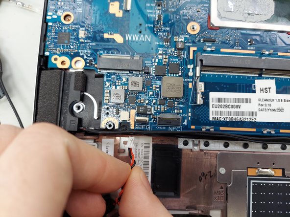

  22. HP EliteBook x360 830 G7 Motherboard Replacement: crwdns2935265:022crwdnd2935265:01crwdnd2935265:02crwdne2935265:0 HP EliteBook x360 830 G7 Motherboard Replacement: crwdns2935265:022crwdnd2935265:02crwdnd2935265:02crwdne2935265:0
    • Use the point of a spudger to push on alternating sides of the speaker connector to "walk" it out of its socket.
    • Don't pull on the cables.
    • Disconnecting these cables is a two-step process.
    • Gently push the tip of a spudger under the metal buckle to unclip it, then swing it over the socket.
    • Hold the buckle and cable together and gently pull the connector straight out of its socket.
    • To reconnect, grip the cable and buckle together and insert the connector fully into its socket.
    • Aligning the connector can be tricky. Reposition it as necessary and don't try to force it into the socket, or you may damage both the connector and its socket.
    • Flip the buckle over the socket and use a spudger to press the buckle down until it clicks into place.
