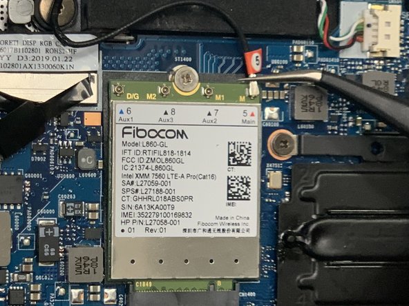

  6. HP EliteBook x360 830 G6 Wi-Fi Card Replacement, Wi-Fi Card: crwdns2935265:06crwdnd2935265:01crwdnd2935265:02crwdne2935265:0 HP EliteBook x360 830 G6 Wi-Fi Card Replacement, Wi-Fi Card: crwdns2935265:06crwdnd2935265:02crwdnd2935265:02crwdne2935265:0
    • Remove the two antenna cable with tweezers.
    • The blue tagged antenna will be on the left side. The red tagged antenna will be on the right side.

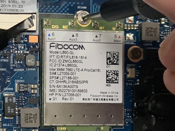

  7. HP EliteBook x360 830 G6 Wi-Fi Card Replacement: crwdns2935265:07crwdnd2935265:01crwdnd2935265:02crwdne2935265:0 HP EliteBook x360 830 G6 Wi-Fi Card Replacement: crwdns2935265:07crwdnd2935265:02crwdnd2935265:02crwdne2935265:0
    • Use a Phillips #0 screwdriver to remove the 3 mm screw securing the Wi-Fi card.
    • The card will pop up at a slight angle once the screw is removed.

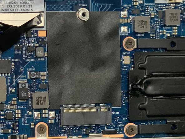

  8. HP EliteBook x360 830 G6 Wi-Fi Card Replacement: crwdns2935265:08crwdnd2935265:01crwdnd2935265:02crwdne2935265:0 HP EliteBook x360 830 G6 Wi-Fi Card Replacement: crwdns2935265:08crwdnd2935265:02crwdnd2935265:02crwdne2935265:0
    • Grasp the sides of the Wi-Fi card to slide it out of the socket to remove.
    • Gently remove the Wi-Fi card. There is risk of damage to the socket if removed forcefully.
