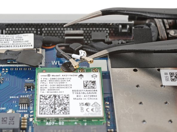

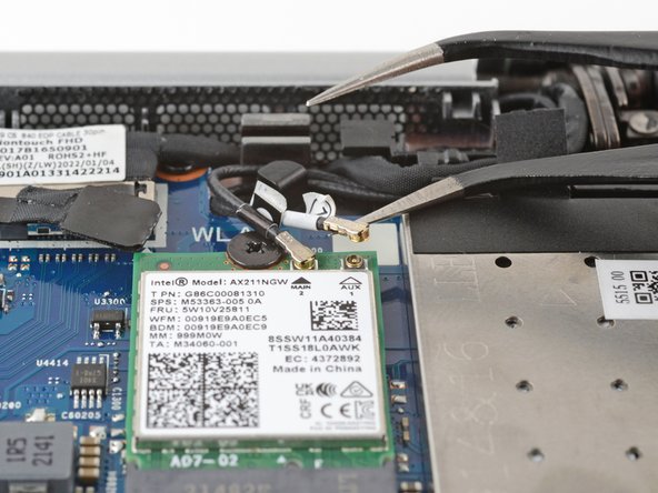

  8. HP EliteBook 845 G9 Wi-Fi Module Replacement, Disconnect the WLAN module cables: crwdns2935265:08crwdnd2935265:01crwdnd2935265:03crwdne2935265:0 HP EliteBook 845 G9 Wi-Fi Module Replacement, Disconnect the WLAN module cables: crwdns2935265:08crwdnd2935265:02crwdnd2935265:03crwdne2935265:0 HP EliteBook 845 G9 Wi-Fi Module Replacement, Disconnect the WLAN module cables: crwdns2935265:08crwdnd2935265:03crwdnd2935265:03crwdne2935265:0
    • Slide an arm of a pair of angled tweezers under the metal neck of one of the coaxial connectors on the WLAN (Wi-Fi) module, near the right hinge.
    • Lift straight up to disconnect the cable.
    • Repeat the process to disconnect the remaining coaxial connector.
    • During reassembly:
    • Connect the cable with black tape to the socket with a black arrow below it, and the white cable to the socket with a white arrow.
    • Use tweezers to hold a connector in place over its socket and gently press down with your finger or a spudger—the connector should "snap" into place. If you're having trouble, reposition the head and try again. Don't use excessive force.

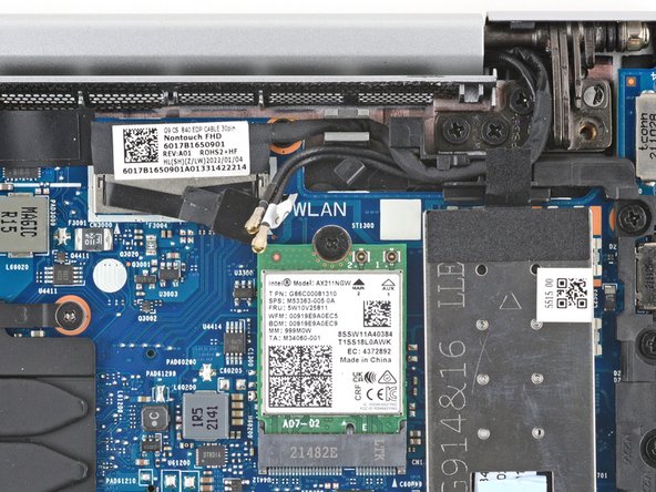

  9. HP EliteBook 845 G9 Wi-Fi Module Replacement, Remove the Wi-Fi module screw: crwdns2935265:09crwdnd2935265:01crwdnd2935265:02crwdne2935265:0 HP EliteBook 845 G9 Wi-Fi Module Replacement, Remove the Wi-Fi module screw: crwdns2935265:09crwdnd2935265:02crwdnd2935265:02crwdne2935265:0
    • Use a Phillips screwdriver to remove the 2.5 mm‑long screw securing the Wi-Fi module.

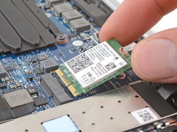

  10. HP EliteBook 845 G9 Wi-Fi Module Replacement, Remove the Wi-Fi module: crwdns2935265:010crwdnd2935265:01crwdnd2935265:02crwdne2935265:0 HP EliteBook 845 G9 Wi-Fi Module Replacement, Remove the Wi-Fi module: crwdns2935265:010crwdnd2935265:02crwdnd2935265:02crwdne2935265:0
    • Don't pull up at a sharp angle, or you may damage the Wi-Fi module and its socket.
    • Grip the Wi-Fi module by its edges and pull it straight out of its socket to remove it.
Compare your new replacement part to the original part—you may need to transfer remaining components or remove adhesive backings from the new part before you install it.
