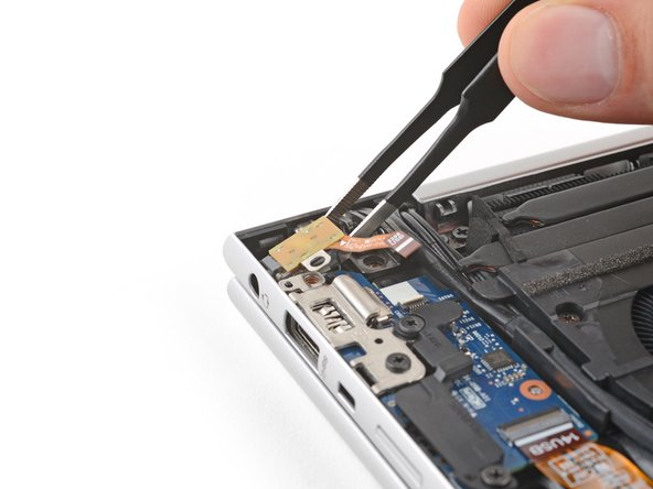

  8. HP EliteBook 845 G9 USB Board Replacement, Disconnect the audio jack: crwdns2935265:08crwdnd2935265:01crwdnd2935265:03crwdne2935265:0 HP EliteBook 845 G9 USB Board Replacement, Disconnect the audio jack: crwdns2935265:08crwdnd2935265:02crwdnd2935265:03crwdne2935265:0 HP EliteBook 845 G9 USB Board Replacement, Disconnect the audio jack: crwdns2935265:08crwdnd2935265:03crwdnd2935265:03crwdne2935265:0

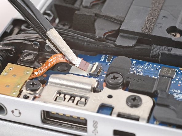

    • Use a spudger to lift the hinged locking flap on the audio jack ZIF connector, located near the top left corner of your laptop.
    • Use tweezers to gently pull the cable straight out of its socket.
  9. HP EliteBook 845 G9 USB Board Replacement, Remove the audio jack screw: crwdns2935265:09crwdnd2935265:01crwdnd2935265:02crwdne2935265:0 HP EliteBook 845 G9 USB Board Replacement, Remove the audio jack screw: crwdns2935265:09crwdnd2935265:02crwdnd2935265:02crwdne2935265:0
    • Use a Phillips screwdriver to remove the 4.6 mm‑long screw securing the audio jack.

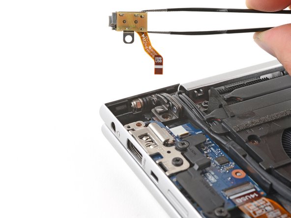

  10. HP EliteBook 845 G9 USB Board Replacement, Remove the audio jack: crwdns2935265:010crwdnd2935265:01crwdnd2935265:03crwdne2935265:0 HP EliteBook 845 G9 USB Board Replacement, Remove the audio jack: crwdns2935265:010crwdnd2935265:02crwdnd2935265:03crwdne2935265:0 HP EliteBook 845 G9 USB Board Replacement, Remove the audio jack: crwdns2935265:010crwdnd2935265:03crwdnd2935265:03crwdne2935265:0
    • Use tweezers or your fingers to pull the audio jack away from the edge to dislodge it.
    • Lift the audio jack out of its recess and remove it.
    • During reassembly, insert the audio jack at a slight downward angle so the socket goes into its cutout on the edge of your laptop—make sure the jack is fully inserted before securing it.

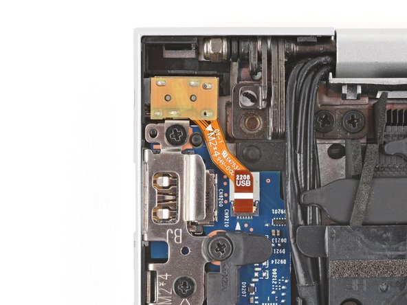

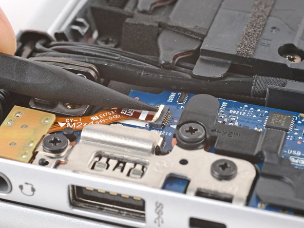

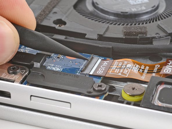

  11. HP EliteBook 845 G9 USB Board Replacement, Disconnect the connector board: crwdns2935265:011crwdnd2935265:01crwdnd2935265:03crwdne2935265:0 HP EliteBook 845 G9 USB Board Replacement, Disconnect the connector board: crwdns2935265:011crwdnd2935265:02crwdnd2935265:03crwdne2935265:0 HP EliteBook 845 G9 USB Board Replacement, Disconnect the connector board: crwdns2935265:011crwdnd2935265:03crwdnd2935265:03crwdne2935265:0

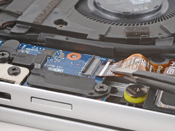

    • Use a spudger to lift the hinged locking flap on the connector board ZIF connector, to the left of the fan.

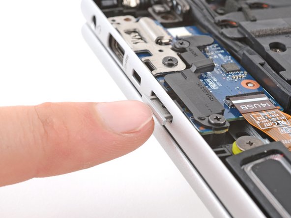

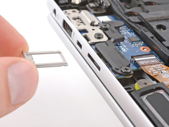

  12. HP EliteBook 845 G9 USB Board Replacement, Remove the SIM card tray: crwdns2935265:012crwdnd2935265:01crwdnd2935265:03crwdne2935265:0 HP EliteBook 845 G9 USB Board Replacement, Remove the SIM card tray: crwdns2935265:012crwdnd2935265:02crwdnd2935265:03crwdne2935265:0 HP EliteBook 845 G9 USB Board Replacement, Remove the SIM card tray: crwdns2935265:012crwdnd2935265:03crwdnd2935265:03crwdne2935265:0
    • Use a clean fingernail or the flat end of a spudger to push in the SIM card tray to eject it.
    • Remove the SIM card tray.

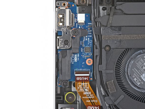

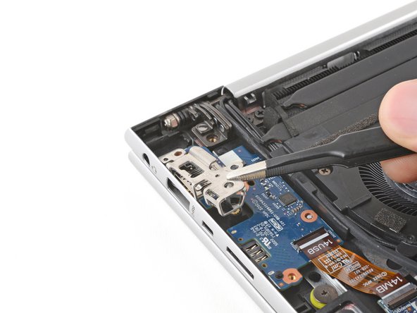

  13. HP EliteBook 845 G9 USB Board Replacement, Remove the connector board screws: crwdns2935265:013crwdnd2935265:01crwdnd2935265:02crwdne2935265:0 HP EliteBook 845 G9 USB Board Replacement, Remove the connector board screws: crwdns2935265:013crwdnd2935265:02crwdnd2935265:02crwdne2935265:0
    • Use a Phillips #1 screwdriver to remove the three 4.5 mm‑long screws securing the connector board and its brackets.

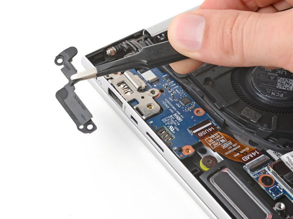

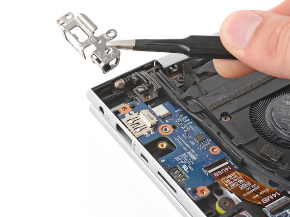

  14. HP EliteBook 845 G9 USB Board Replacement, Remove the brackets: crwdns2935265:014crwdnd2935265:01crwdnd2935265:02crwdne2935265:0 HP EliteBook 845 G9 USB Board Replacement, Remove the brackets: crwdns2935265:014crwdnd2935265:02crwdnd2935265:02crwdne2935265:0
    • Use tweezers or your fingers to remove the black plastic bracket.
  15. HP EliteBook 845 G9 USB Board Replacement: crwdns2935265:015crwdnd2935265:01crwdnd2935265:03crwdne2935265:0 HP EliteBook 845 G9 USB Board Replacement: crwdns2935265:015crwdnd2935265:02crwdnd2935265:03crwdne2935265:0 HP EliteBook 845 G9 USB Board Replacement: crwdns2935265:015crwdnd2935265:03crwdnd2935265:03crwdne2935265:0
    • Use tweezers or your fingers to lift the bottom edge of the metal bracket and remove it.

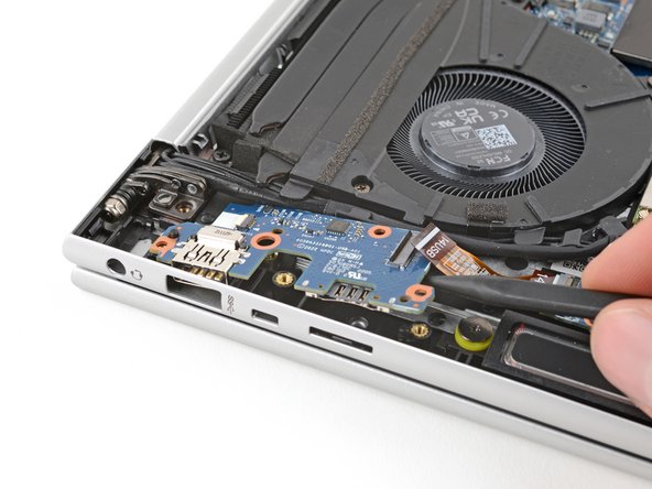

  16. HP EliteBook 845 G9 USB Board Replacement, Remove the connector board: crwdns2935265:016crwdnd2935265:01crwdnd2935265:03crwdne2935265:0 HP EliteBook 845 G9 USB Board Replacement, Remove the connector board: crwdns2935265:016crwdnd2935265:02crwdnd2935265:03crwdne2935265:0 HP EliteBook 845 G9 USB Board Replacement, Remove the connector board: crwdns2935265:016crwdnd2935265:03crwdnd2935265:03crwdne2935265:0

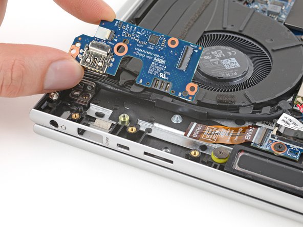

    • Use a spudger to lift the connector board out of its recess until you can grip it with your fingers.
    • Use your fingers to lift and remove the connector board.
