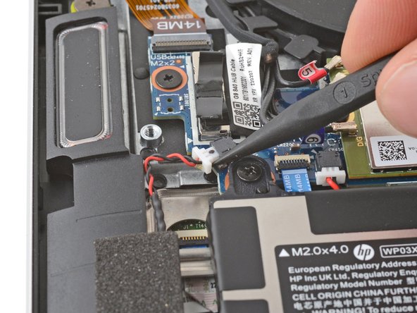

    • The right speaker will be on your left‑hand side while working, as the laptop is laying upside down.

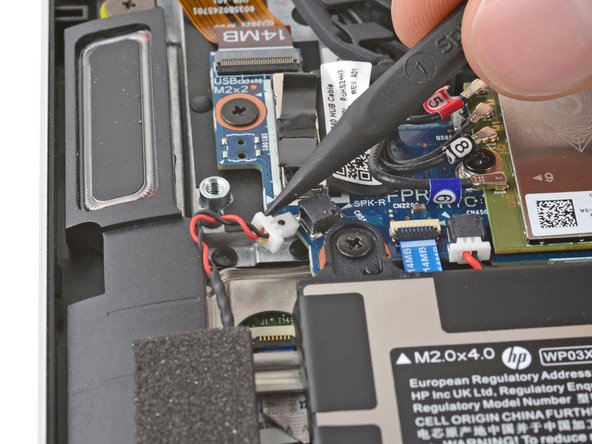

    • Use the point of a spudger to push on alternating sides of the right speaker's sliding connector to walk it completely out of its socket.

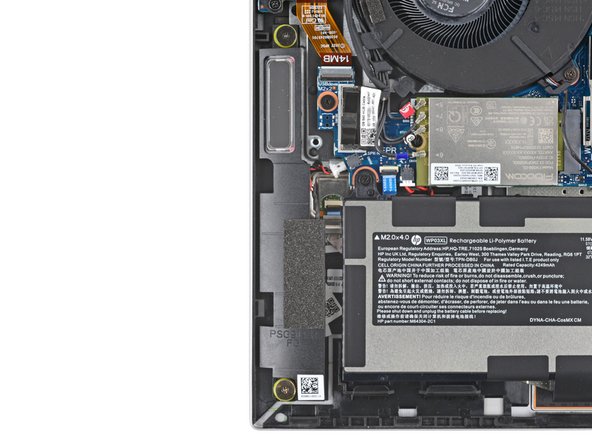

    • Use a Phillips screwdriver to remove the two 2.5 mm‑long screws securing the right speaker.
  10. HP EliteBook 845 G9 Right Speaker Replacement, Remove the right speaker: crwdns2935265:010crwdnd2935265:01crwdnd2935265:03crwdne2935265:0 HP EliteBook 845 G9 Right Speaker Replacement, Remove the right speaker: crwdns2935265:010crwdnd2935265:02crwdnd2935265:03crwdne2935265:0 HP EliteBook 845 G9 Right Speaker Replacement, Remove the right speaker: crwdns2935265:010crwdnd2935265:03crwdnd2935265:03crwdne2935265:0

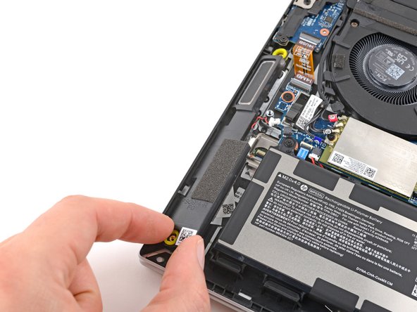

    • Grommets secure the top and bottom of the speaker.

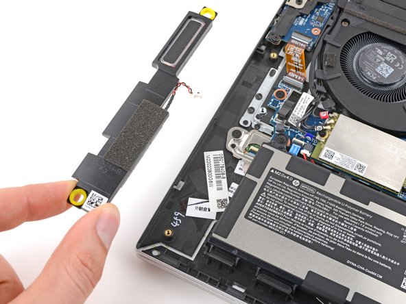

    • Lift the speaker straight up and off its posts to remove it.
    • During reassembly:
    • Make sure the new speaker has grommets. If it doesn't, transfer over the original grommets.
    • Align the grommets over their screw posts and press down gently to secure the speaker in place.
    • Don't press down on the rectangular rubber diaphragm on the top edge, or you'll damage the speaker.
