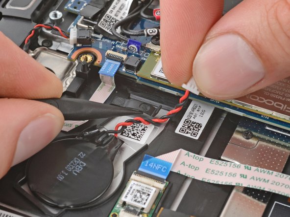

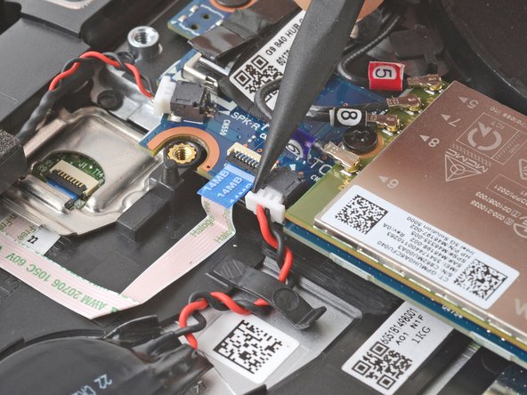

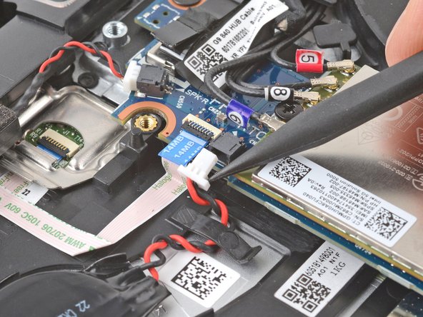

  10. HP EliteBook 845 G9 RTC Battery Replacement, Disconnect the RTC battery: crwdns2935265:010crwdnd2935265:01crwdnd2935265:03crwdne2935265:0 HP EliteBook 845 G9 RTC Battery Replacement, Disconnect the RTC battery: crwdns2935265:010crwdnd2935265:02crwdnd2935265:03crwdne2935265:0 HP EliteBook 845 G9 RTC Battery Replacement, Disconnect the RTC battery: crwdns2935265:010crwdnd2935265:03crwdnd2935265:03crwdne2935265:0
    • Use the point of a spudger to push on alternating sides of the RTC battery's sliding connector to walk it completely out of its socket on the bottom left corner of the motherboard.
  11. HP EliteBook 845 G9 RTC Battery Replacement: crwdns2935265:011crwdnd2935265:01crwdnd2935265:02crwdne2935265:0 HP EliteBook 845 G9 RTC Battery Replacement: crwdns2935265:011crwdnd2935265:02crwdnd2935265:02crwdne2935265:0
    • While holding up the plastic battery cable clip, pull the cable out from underneath.

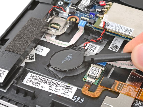

  12. HP EliteBook 845 G9 RTC Battery Replacement, Remove the RTC battery: crwdns2935265:012crwdnd2935265:01crwdnd2935265:03crwdne2935265:0 HP EliteBook 845 G9 RTC Battery Replacement, Remove the RTC battery: crwdns2935265:012crwdnd2935265:02crwdnd2935265:03crwdne2935265:0 HP EliteBook 845 G9 RTC Battery Replacement, Remove the RTC battery: crwdns2935265:012crwdnd2935265:03crwdnd2935265:03crwdne2935265:0
    Tesa 61395 Tape
    $2.99

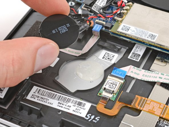

    • Use the flat end of a spudger to gently pry up the RTC battery, separating the adhesive securing it to the frame.
    • Remove the RTC battery.
    • During reassembly:
    • When installing a new RTC battery, make sure the cable is facing its socket on the motherboard.
    • If your replacement battery comes with adhesive pre‑installed, remove the old adhesive from the frame before installing the new battery.
    • If it doesn't, you can reuse the adhesive if it's still sticky. If you need to replace the adhesive, use thin, double‑sided tape to secure your new battery.
