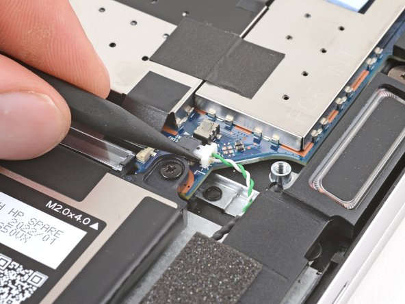

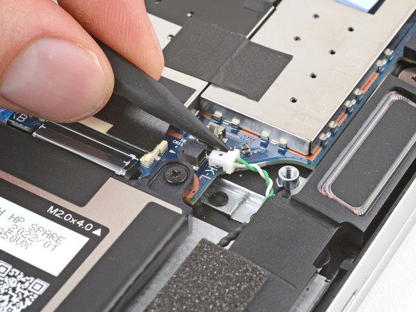

  8. HP EliteBook 845 G9 Left Speaker Replacement, Disconnect the speaker: crwdns2935265:08crwdnd2935265:01crwdnd2935265:03crwdne2935265:0 HP EliteBook 845 G9 Left Speaker Replacement, Disconnect the speaker: crwdns2935265:08crwdnd2935265:02crwdnd2935265:03crwdne2935265:0 HP EliteBook 845 G9 Left Speaker Replacement, Disconnect the speaker: crwdns2935265:08crwdnd2935265:03crwdnd2935265:03crwdne2935265:0
    • The left speaker will be on your right‑hand side while working, as the laptop is laying upside down.
    • Use the point of a spudger to push on alternating sides of the left speaker's sliding connector to walk it completely out of its socket.

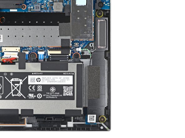

  9. HP EliteBook 845 G9 Left Speaker Replacement, Remove the speaker screws: crwdns2935265:09crwdnd2935265:01crwdnd2935265:02crwdne2935265:0 HP EliteBook 845 G9 Left Speaker Replacement, Remove the speaker screws: crwdns2935265:09crwdnd2935265:02crwdnd2935265:02crwdne2935265:0
    • Use a Phillips screwdriver to remove the two 2.5 mm‑long screws securing the left speaker.

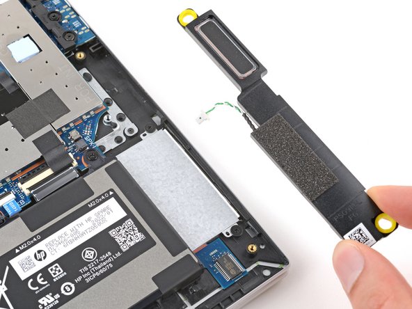

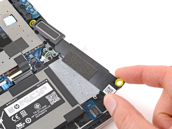

  10. HP EliteBook 845 G9 Left Speaker Replacement, Remove the left speaker: crwdns2935265:010crwdnd2935265:01crwdnd2935265:03crwdne2935265:0 HP EliteBook 845 G9 Left Speaker Replacement, Remove the left speaker: crwdns2935265:010crwdnd2935265:02crwdnd2935265:03crwdne2935265:0 HP EliteBook 845 G9 Left Speaker Replacement, Remove the left speaker: crwdns2935265:010crwdnd2935265:03crwdnd2935265:03crwdne2935265:0
    • Grommets secure the top and bottom of the speaker.
    • Lift the speaker straight up and off its posts to remove it.
    • During reassembly:
    • Make sure the new speaker has grommets. If it doesn't, transfer over the original grommets.
    • Align the grommets over their screw posts and press down gently to secure the speaker in place.
    • Don't press down on the rectangular rubber diaphragm on the top edge, or you'll damage the speaker.
