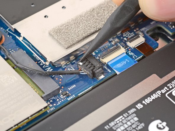

  7. HP EliteBook 845 G9 Fan Replacement, Disconnect the battery: crwdns2935265:07crwdnd2935265:01crwdnd2935265:03crwdne2935265:0 HP EliteBook 845 G9 Fan Replacement, Disconnect the battery: crwdns2935265:07crwdnd2935265:02crwdnd2935265:03crwdne2935265:0 HP EliteBook 845 G9 Fan Replacement, Disconnect the battery: crwdns2935265:07crwdnd2935265:03crwdnd2935265:03crwdne2935265:0
    • Position your laptop so the front edge (opposite the screen hinges) is closest to you.
    • Use the point of a spudger to push on alternating sides of the battery's sliding connector to walk it completely out of its socket.

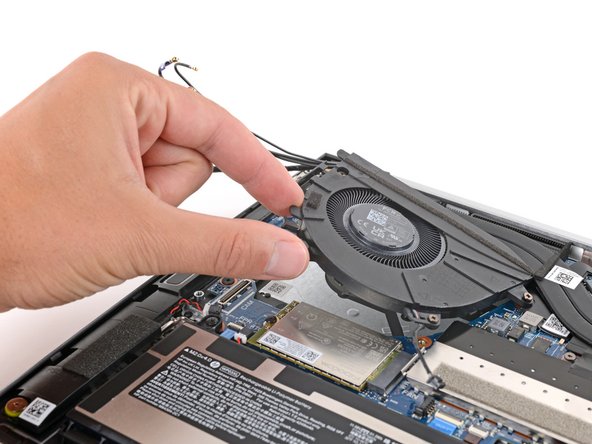

  10. HP EliteBook 845 G9 Fan Replacement, De‑route the cables: crwdns2935265:010crwdnd2935265:01crwdnd2935265:03crwdne2935265:0 HP EliteBook 845 G9 Fan Replacement, De‑route the cables: crwdns2935265:010crwdnd2935265:02crwdnd2935265:03crwdne2935265:0 HP EliteBook 845 G9 Fan Replacement, De‑route the cables: crwdns2935265:010crwdnd2935265:03crwdnd2935265:03crwdne2935265:0
    • Use your fingers to pull the display cable and four coaxial cables out of their clips on the left side of the fan.
    • During reassembly, use this photo as a reference to properly route the cables into their clips.

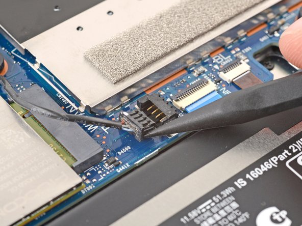

    • Use the point of a spudger to push on alternating sides of the fan's sliding connector to walk it completely out of its socket.

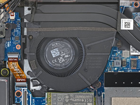

  12. HP EliteBook 845 G9 Fan Replacement, Unfasten the fan: crwdns2935265:012crwdnd2935265:01crwdnd2935265:02crwdne2935265:0 HP EliteBook 845 G9 Fan Replacement, Unfasten the fan: crwdns2935265:012crwdnd2935265:02crwdnd2935265:02crwdne2935265:0
    • Use a Phillips screwdriver to fully loosen (not remove) the three captive screws securing the fan.

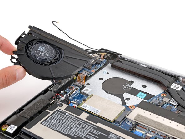

  13. HP EliteBook 845 G9 Fan Replacement, Remove the fan: crwdns2935265:013crwdnd2935265:01crwdnd2935265:03crwdne2935265:0 HP EliteBook 845 G9 Fan Replacement, Remove the fan: crwdns2935265:013crwdnd2935265:02crwdnd2935265:03crwdne2935265:0 HP EliteBook 845 G9 Fan Replacement, Remove the fan: crwdns2935265:013crwdnd2935265:03crwdnd2935265:03crwdne2935265:0
    • Lift up the left edge of the fan.
    • Pull the fan towards the laptop's left edge to slide the top right corner out from under the heat sink.
    • Remove the fan.
    • During reassembly, make sure the top right corner of the fan slides under the heat sink.
