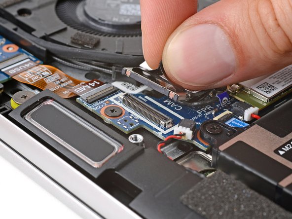

  8. HP EliteBook 845 G9 Display Assembly Replacement, Disconnect the display cable: crwdns2935265:08crwdnd2935265:01crwdnd2935265:03crwdne2935265:0 HP EliteBook 845 G9 Display Assembly Replacement, Disconnect the display cable: crwdns2935265:08crwdnd2935265:02crwdnd2935265:03crwdne2935265:0 HP EliteBook 845 G9 Display Assembly Replacement, Disconnect the display cable: crwdns2935265:08crwdnd2935265:03crwdnd2935265:03crwdne2935265:0
    • Use your fingers to grip the plastic pull tab on the left display cable press connector, located below the fan.
    • Pull straight up to disconnect the connector.
    • During reassembly, align the connector carefully over its socket and press down with your fingertip—first on one side, then the other—until it clicks into place. Don't try to force the connector into place. If you're having trouble, reposition it and try again. Don't use excessive force.

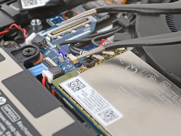

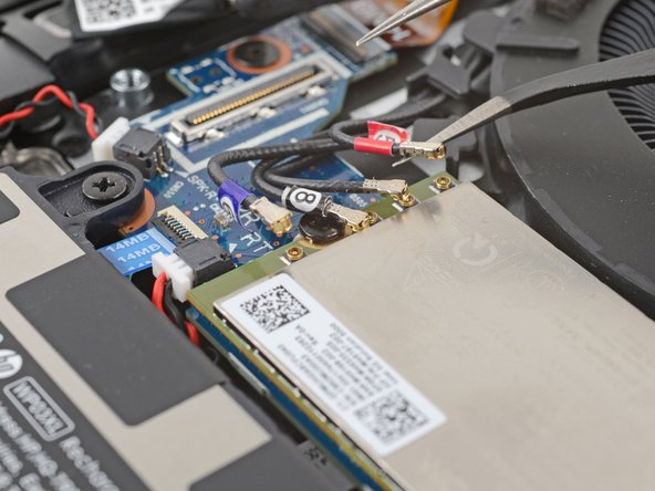

  9. HP EliteBook 845 G9 Display Assembly Replacement, Disconnect the WWAN cables: crwdns2935265:09crwdnd2935265:01crwdnd2935265:03crwdne2935265:0 HP EliteBook 845 G9 Display Assembly Replacement, Disconnect the WWAN cables: crwdns2935265:09crwdnd2935265:02crwdnd2935265:03crwdne2935265:0 HP EliteBook 845 G9 Display Assembly Replacement, Disconnect the WWAN cables: crwdns2935265:09crwdnd2935265:03crwdnd2935265:03crwdne2935265:0
    • Slide one arm of a pair of angled tweezers under the metal neck of one of the coaxial connectors on the WWAN (cellular) module.
    • Lift straight up to disconnect the cable.
    • Repeat the process to disconnect the three remaining coaxial connectors.
    • During reassembly:
    • Use the numbered pieces of tape on the cables and their corresponding markings on the WWAN module to correctly connect each cable.
    • Use tweezers to hold a connector in place over its socket and gently press down with your finger or a spudger—the connector should "snap" into place. If you're having trouble, reposition the head and try again. Don't use excessive force.

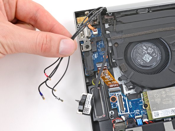

  10. HP EliteBook 845 G9 Display Assembly Replacement, De‑route the cables: crwdns2935265:010crwdnd2935265:01crwdnd2935265:03crwdne2935265:0 HP EliteBook 845 G9 Display Assembly Replacement, De‑route the cables: crwdns2935265:010crwdnd2935265:02crwdnd2935265:03crwdne2935265:0 HP EliteBook 845 G9 Display Assembly Replacement, De‑route the cables: crwdns2935265:010crwdnd2935265:03crwdnd2935265:03crwdne2935265:0
    • Use your fingers to pull the display cable and four coaxial cables out of their clips on the left side of the fan.
    • During reassembly, use this photo as a reference to properly route the cables into their clips.

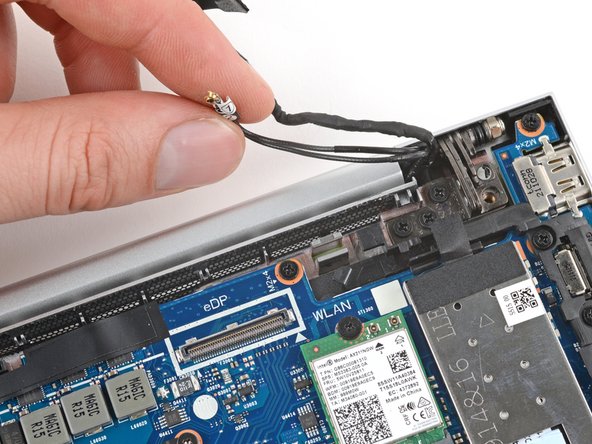

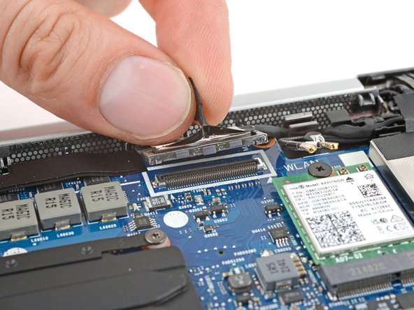

  11. HP EliteBook 845 G9 Display Assembly Replacement, Disconnect the WLAN module cables: crwdns2935265:011crwdnd2935265:01crwdnd2935265:03crwdne2935265:0 HP EliteBook 845 G9 Display Assembly Replacement, Disconnect the WLAN module cables: crwdns2935265:011crwdnd2935265:02crwdnd2935265:03crwdne2935265:0 HP EliteBook 845 G9 Display Assembly Replacement, Disconnect the WLAN module cables: crwdns2935265:011crwdnd2935265:03crwdnd2935265:03crwdne2935265:0
    • Slide an arm of a pair of angled tweezers under the metal neck of one of the coaxial connectors on the WLAN (Wi-Fi) module, near the right hinge.
    • Repeat the process to disconnect the remaining coaxial connector.
    • Connect the cable with black tape to the socket with a black arrow below it, and the white cable to the socket with a white arrow.

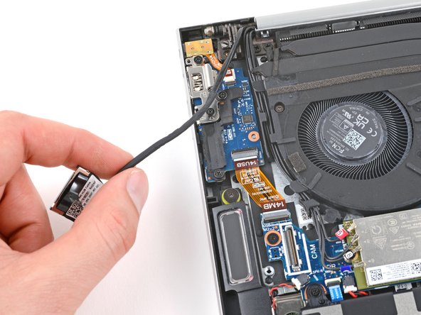

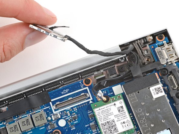

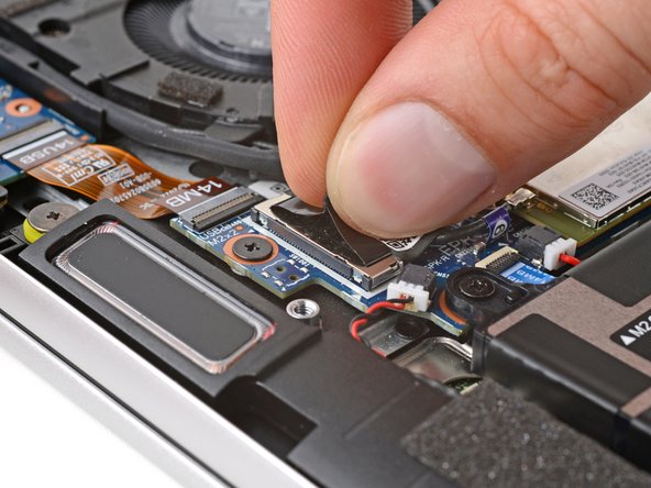

  12. HP EliteBook 845 G9 Display Assembly Replacement, Disconnect the display cable: crwdns2935265:012crwdnd2935265:01crwdnd2935265:02crwdne2935265:0 HP EliteBook 845 G9 Display Assembly Replacement, Disconnect the display cable: crwdns2935265:012crwdnd2935265:02crwdnd2935265:02crwdne2935265:0
    • Use your fingers to grip the plastic pull tab on the right display cable press connector, located near the right hinge.
  13. HP EliteBook 845 G9 Display Assembly Replacement: crwdns2935265:013crwdnd2935265:01crwdnd2935265:03crwdne2935265:0 HP EliteBook 845 G9 Display Assembly Replacement: crwdns2935265:013crwdnd2935265:02crwdnd2935265:03crwdne2935265:0 HP EliteBook 845 G9 Display Assembly Replacement: crwdns2935265:013crwdnd2935265:03crwdnd2935265:03crwdne2935265:0
    • Use your fingers to pull the display cable and two coaxial cables out of their clips along the top edge of your laptop.

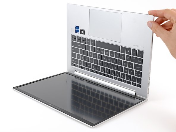

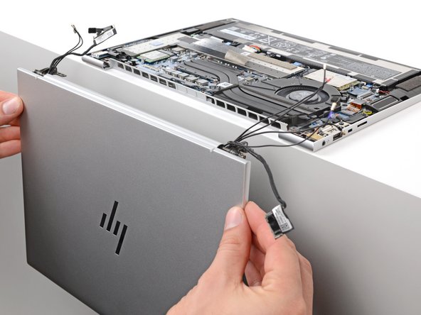

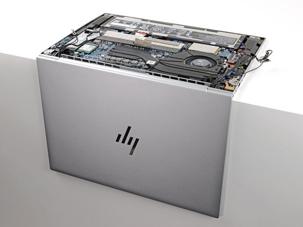

  14. HP EliteBook 845 G9 Display Assembly Replacement, Hang the screen over an edge: crwdns2935265:014crwdnd2935265:01crwdnd2935265:03crwdne2935265:0 HP EliteBook 845 G9 Display Assembly Replacement, Hang the screen over an edge: crwdns2935265:014crwdnd2935265:02crwdnd2935265:03crwdne2935265:0 HP EliteBook 845 G9 Display Assembly Replacement, Hang the screen over an edge: crwdns2935265:014crwdnd2935265:03crwdnd2935265:03crwdne2935265:0
    • Make sure there aren't any loose components or rogue screws that might fall out of your laptop when you open it.
    • Grab the main body of your laptop and open it to a 90-degree angle.
    • Lay your laptop keyboard-side down on the edge of a flat, clean work surface, with the screen hanging over the edge, straight down.
    • During reassembly, if your screen clicks or snaps when it's opened or closed, loosen the screws and re‑align the screen.

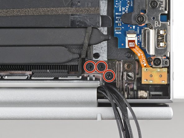

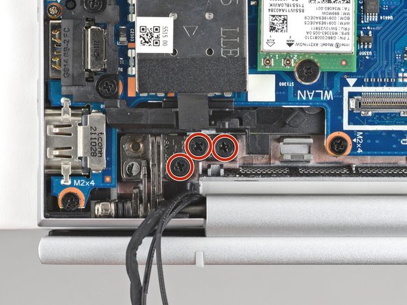

  15. HP EliteBook 845 G9 Display Assembly Replacement, Remove the hinge screws: crwdns2935265:015crwdnd2935265:01crwdnd2935265:03crwdne2935265:0 HP EliteBook 845 G9 Display Assembly Replacement, Remove the hinge screws: crwdns2935265:015crwdnd2935265:02crwdnd2935265:03crwdne2935265:0 HP EliteBook 845 G9 Display Assembly Replacement, Remove the hinge screws: crwdns2935265:015crwdnd2935265:03crwdnd2935265:03crwdne2935265:0
    • Hold your laptop steady with your free hand while removing or installing hinge screws—don't let it fall off of your work surface.
    • Use a Phillips screwdriver to remove the six 4.6 mm‑long hinge screws—three in each hinge.
    • During reassembly, make sure the display is properly aligned before tightening the hinge screws.

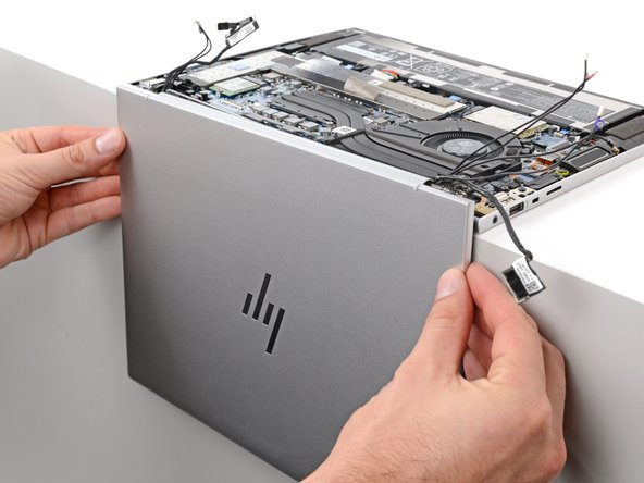

  16. HP EliteBook 845 G9 Display Assembly Replacement, Remove the screen: crwdns2935265:016crwdnd2935265:01crwdnd2935265:03crwdne2935265:0 HP EliteBook 845 G9 Display Assembly Replacement, Remove the screen: crwdns2935265:016crwdnd2935265:02crwdnd2935265:03crwdne2935265:0 HP EliteBook 845 G9 Display Assembly Replacement, Remove the screen: crwdns2935265:016crwdnd2935265:03crwdnd2935265:03crwdne2935265:0
    • Lift the screen hinges out of their recesses one at a time to remove the screen.
    • During reassembly, make sure both hinges on your replacement display assembly are open to a 90‑degree angle before lowering them into their recesses.
