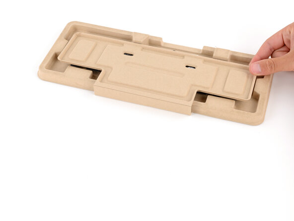

  8. HP EliteBook 845 G9 Battery Replacement, Prepare the battery removal kit: crwdns2935265:08crwdnd2935265:01crwdnd2935265:03crwdne2935265:0 HP EliteBook 845 G9 Battery Replacement, Prepare the battery removal kit: crwdns2935265:08crwdnd2935265:02crwdnd2935265:03crwdne2935265:0 HP EliteBook 845 G9 Battery Replacement, Prepare the battery removal kit: crwdns2935265:08crwdnd2935265:03crwdnd2935265:03crwdne2935265:0
    • Open your Revivekit and grab the empty cardboard tray.
    • This tray will be used to remove and safely store your old battery.
    • Open the cardboard tray.
  9. HP EliteBook 845 G9 Battery Replacement: crwdns2935265:09crwdnd2935265:01crwdnd2935265:03crwdne2935265:0 HP EliteBook 845 G9 Battery Replacement: crwdns2935265:09crwdnd2935265:02crwdnd2935265:03crwdne2935265:0 HP EliteBook 845 G9 Battery Replacement: crwdns2935265:09crwdnd2935265:03crwdnd2935265:03crwdne2935265:0
    • Remove the plastic liners from both adhesive strips.

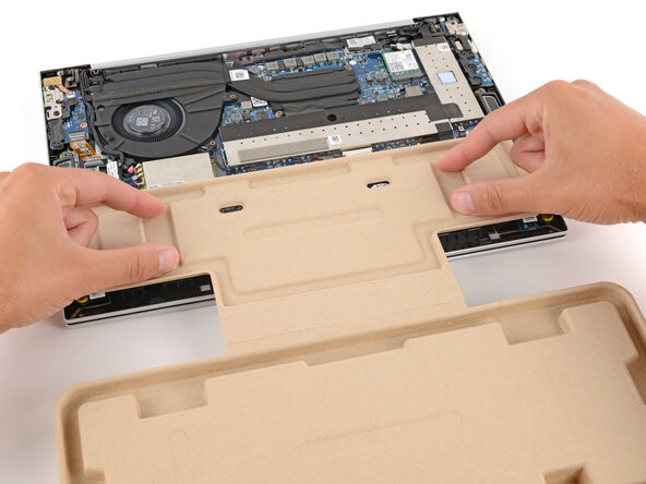

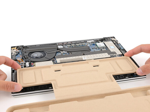

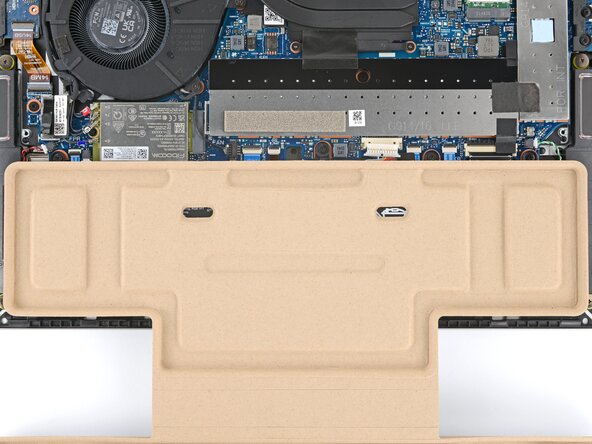

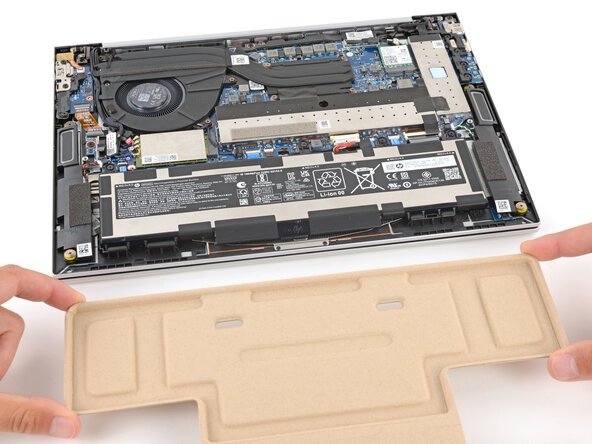

  10. HP EliteBook 845 G9 Battery Replacement, Adhere the cardboard to the battery: crwdns2935265:010crwdnd2935265:01crwdnd2935265:03crwdne2935265:0 HP EliteBook 845 G9 Battery Replacement, Adhere the cardboard to the battery: crwdns2935265:010crwdnd2935265:02crwdnd2935265:03crwdne2935265:0 HP EliteBook 845 G9 Battery Replacement, Adhere the cardboard to the battery: crwdns2935265:010crwdnd2935265:03crwdnd2935265:03crwdne2935265:0
    • Align the top edge of the cardboard with the top edge of the battery, without covering the battery screws. Make sure the battery is fully covered.
    • Once properly aligned, secure the cardboard to the battery with the adhesive strips by firmly pressing it into place with your fingers.

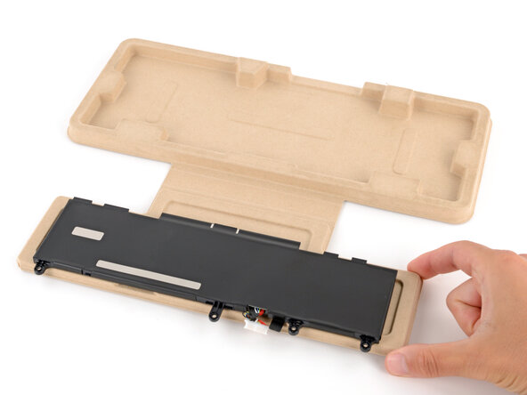

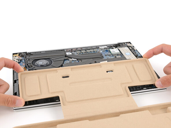

  12. HP EliteBook 845 G9 Battery Replacement, Remove the battery: crwdns2935265:012crwdnd2935265:01crwdnd2935265:03crwdne2935265:0 HP EliteBook 845 G9 Battery Replacement, Remove the battery: crwdns2935265:012crwdnd2935265:02crwdnd2935265:03crwdne2935265:0 HP EliteBook 845 G9 Battery Replacement, Remove the battery: crwdns2935265:012crwdnd2935265:03crwdnd2935265:03crwdne2935265:0
    • The battery should stay adhered to the cardboard tray—be gentle when removing it.
    • Lift the top edge of that battery and slide the tabs on the bottom edge out of their slots.
    • Remove the battery.
  13. HP EliteBook 845 G9 Battery Replacement: crwdns2935265:013crwdnd2935265:01crwdnd2935265:02crwdne2935265:0 HP EliteBook 845 G9 Battery Replacement: crwdns2935265:013crwdnd2935265:02crwdnd2935265:02crwdne2935265:0
    • Close the cardboard tray so the old battery is safely enclosed, then set it aside.

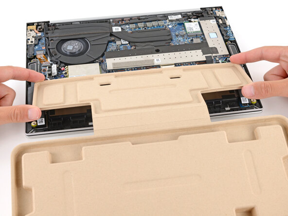

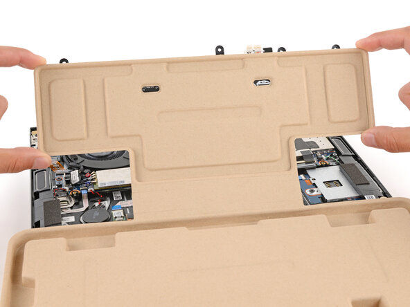

  14. HP EliteBook 845 G9 Battery Replacement, Remove the replacement battery: crwdns2935265:014crwdnd2935265:01crwdnd2935265:03crwdne2935265:0 HP EliteBook 845 G9 Battery Replacement, Remove the replacement battery: crwdns2935265:014crwdnd2935265:02crwdnd2935265:03crwdne2935265:0 HP EliteBook 845 G9 Battery Replacement, Remove the replacement battery: crwdns2935265:014crwdnd2935265:03crwdnd2935265:03crwdne2935265:0
    • Remove the cardboard tray with your replacement battery enclosed and carefully open the tray.

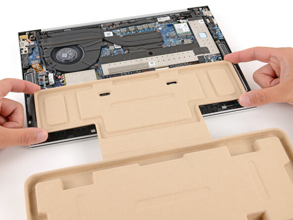

  15. HP EliteBook 845 G9 Battery Replacement, Install the replacement battery: crwdns2935265:015crwdnd2935265:01crwdnd2935265:03crwdne2935265:0 HP EliteBook 845 G9 Battery Replacement, Install the replacement battery: crwdns2935265:015crwdnd2935265:02crwdnd2935265:03crwdne2935265:0 HP EliteBook 845 G9 Battery Replacement, Install the replacement battery: crwdns2935265:015crwdnd2935265:03crwdnd2935265:03crwdne2935265:0

  17. HP EliteBook 845 G9 Battery Replacement, Remove the cardboard: crwdns2935265:017crwdnd2935265:01crwdnd2935265:03crwdne2935265:0 HP EliteBook 845 G9 Battery Replacement, Remove the cardboard: crwdns2935265:017crwdnd2935265:02crwdnd2935265:03crwdne2935265:0 HP EliteBook 845 G9 Battery Replacement, Remove the cardboard: crwdns2935265:017crwdnd2935265:03crwdnd2935265:03crwdne2935265:0
    • Slowly peel the cardboard away from the battery and remove it.
