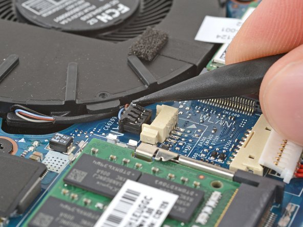

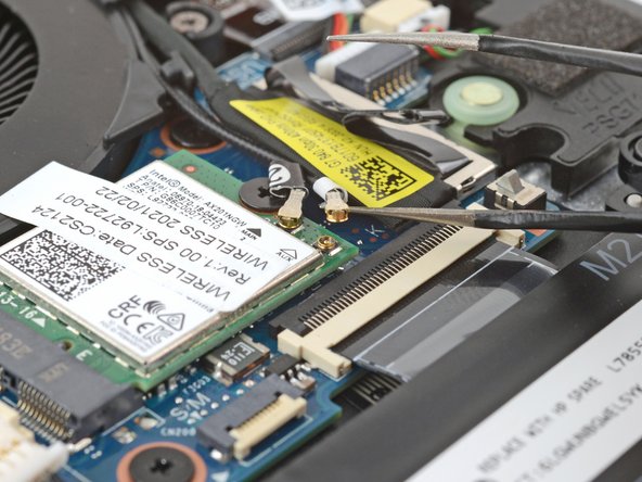

  8. HP EliteBook 845 G8 Fan Replacement, Disconnect the WLAN module cables: crwdns2935265:08crwdnd2935265:01crwdnd2935265:03crwdne2935265:0 HP EliteBook 845 G8 Fan Replacement, Disconnect the WLAN module cables: crwdns2935265:08crwdnd2935265:02crwdnd2935265:03crwdne2935265:0 HP EliteBook 845 G8 Fan Replacement, Disconnect the WLAN module cables: crwdns2935265:08crwdnd2935265:03crwdnd2935265:03crwdne2935265:0
    • Slide an arm of a pair of angled tweezers under the metal neck of one of the coaxial connectors on the WLAN (Wi-Fi) module, located just below the fan.
    • Lift straight up to disconnect the cable.
    • Repeat to disconnect the second connector.
    • During reassembly:
    • Connect the cable with black tape to the socket with a black arrow below it, and the cable with white tape to the socket with a white arrow.
    • Use tweezers to hold a connector in place over its socket and gently press down with your finger or a spudger—the connector should "snap" into place. If you're having trouble, reposition the head and try again. Don't use excessive force.

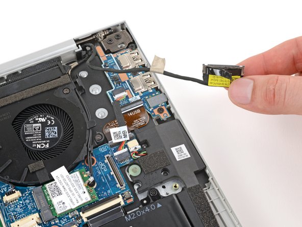

  9. HP EliteBook 845 G8 Fan Replacement, Disconnect the display cable: crwdns2935265:09crwdnd2935265:01crwdnd2935265:02crwdne2935265:0 HP EliteBook 845 G8 Fan Replacement, Disconnect the display cable: crwdns2935265:09crwdnd2935265:02crwdnd2935265:02crwdne2935265:0
    • Use your fingers to grip the plastic pull tab on the right display cable press connector, below the fan.
    • Pull straight up to disconnect the connector.
    • During reassembly, align the connector carefully over its socket and press down with your fingertip—first on one side, then the other—until it clicks into place. Don't try to force the connector into place. If you're having trouble, reposition it and try again. Don't use excessive force.

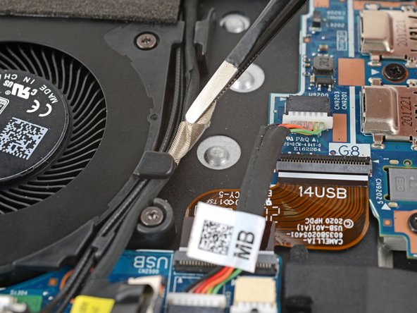

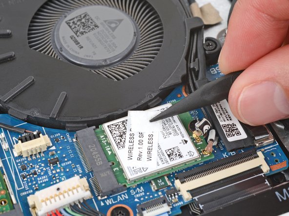

  10. HP EliteBook 845 G8 Fan Replacement, Peel up the fan tape: crwdns2935265:010crwdnd2935265:01crwdnd2935265:02crwdne2935265:0 HP EliteBook 845 G8 Fan Replacement, Peel up the fan tape: crwdns2935265:010crwdnd2935265:02crwdnd2935265:02crwdne2935265:0
    • Use tweezers or your fingers to peel up the cable tape near the right side of the fan.
    • You don't need to fully remove the tape—it can stay on the cable.

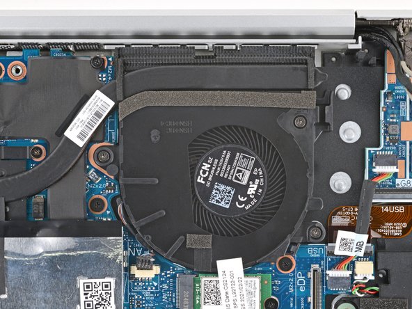

  11. HP EliteBook 845 G8 Fan Replacement, De‑route the fan cables: crwdns2935265:011crwdnd2935265:01crwdnd2935265:03crwdne2935265:0 HP EliteBook 845 G8 Fan Replacement, De‑route the fan cables: crwdns2935265:011crwdnd2935265:02crwdnd2935265:03crwdne2935265:0 HP EliteBook 845 G8 Fan Replacement, De‑route the fan cables: crwdns2935265:011crwdnd2935265:03crwdnd2935265:03crwdne2935265:0
    • Use your fingers to pull the display cable and two coaxial cables out from their clips on the right side of the fan.
    • During reassembly, use this photo as a reference to properly route the cables into their clips.

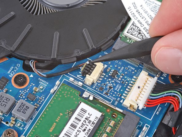

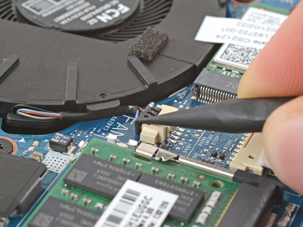

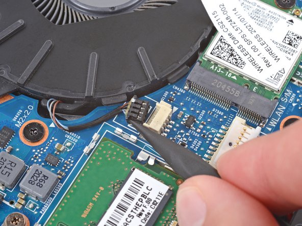

  12. HP EliteBook 845 G8 Fan Replacement, Disconnect the fan cable: crwdns2935265:012crwdnd2935265:01crwdnd2935265:03crwdne2935265:0 HP EliteBook 845 G8 Fan Replacement, Disconnect the fan cable: crwdns2935265:012crwdnd2935265:02crwdnd2935265:03crwdne2935265:0 HP EliteBook 845 G8 Fan Replacement, Disconnect the fan cable: crwdns2935265:012crwdnd2935265:03crwdnd2935265:03crwdne2935265:0
    • Use the point of a spudger to push on alternating sides of the fan's sliding connector to walk it completely out of its socket.

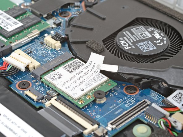

  13. HP EliteBook 845 G8 Fan Replacement, Peel up the fan tape: crwdns2935265:013crwdnd2935265:01crwdnd2935265:02crwdne2935265:0 HP EliteBook 845 G8 Fan Replacement, Peel up the fan tape: crwdns2935265:013crwdnd2935265:02crwdnd2935265:02crwdne2935265:0
    • Use a spudger or tweezers to peel up any tape stuck to the fan body.
    • You don't need to fully remove the tape—it can stay on the WLAN module.

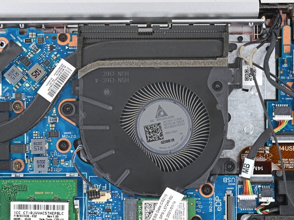

    • Use a Phillips driver to fully loosen (not remove) the three captive screws securing the fan.

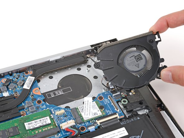

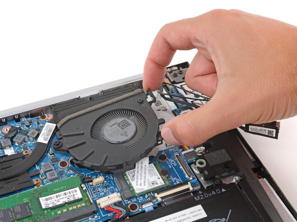

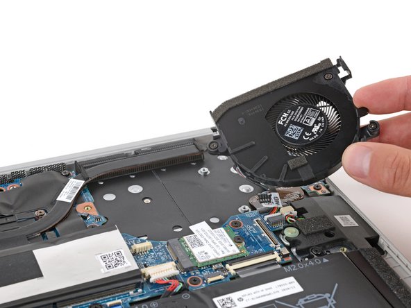

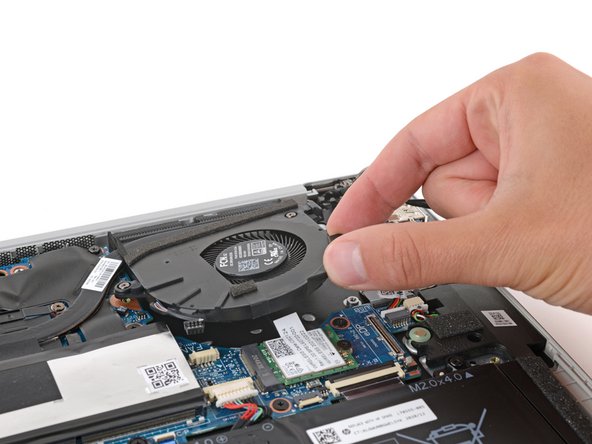

  15. HP EliteBook 845 G8 Fan Replacement, Remove the fan: crwdns2935265:015crwdnd2935265:01crwdnd2935265:03crwdne2935265:0 HP EliteBook 845 G8 Fan Replacement, Remove the fan: crwdns2935265:015crwdnd2935265:02crwdnd2935265:03crwdne2935265:0 HP EliteBook 845 G8 Fan Replacement, Remove the fan: crwdns2935265:015crwdnd2935265:03crwdnd2935265:03crwdne2935265:0
    • Lift up the right edge of the fan.
    • Slide the fan towards the right edge of the laptop to pull the top left corner out from under the heat sink.
    • Remove the fan.
    • During reassembly, make sure the top left corner of the fan slides under the heat sink.
