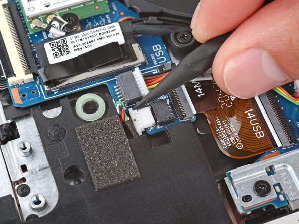

  7. HP EliteBook 845 G7 Smart Card Reader Replacement, Disconnect the battery: crwdns2935265:07crwdnd2935265:01crwdnd2935265:03crwdne2935265:0 HP EliteBook 845 G7 Smart Card Reader Replacement, Disconnect the battery: crwdns2935265:07crwdnd2935265:02crwdnd2935265:03crwdne2935265:0 HP EliteBook 845 G7 Smart Card Reader Replacement, Disconnect the battery: crwdns2935265:07crwdnd2935265:03crwdnd2935265:03crwdne2935265:0
    • Position your laptop so the front edge (opposite the screen hinges) is closest to you.
    • Use the point of a spudger or your fingernail to push on alternating sides of the battery's sliding connector to walk it completely out of its socket.

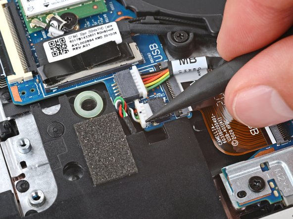

  10. HP EliteBook 845 G7 Smart Card Reader Replacement, Disconnect the left speaker: crwdns2935265:010crwdnd2935265:01crwdnd2935265:03crwdne2935265:0 HP EliteBook 845 G7 Smart Card Reader Replacement, Disconnect the left speaker: crwdns2935265:010crwdnd2935265:02crwdnd2935265:03crwdne2935265:0 HP EliteBook 845 G7 Smart Card Reader Replacement, Disconnect the left speaker: crwdns2935265:010crwdnd2935265:03crwdnd2935265:03crwdne2935265:0
    • Use the point of a spudger to push on alternating sides of the speakers' sliding connector to walk it completely out of its socket.

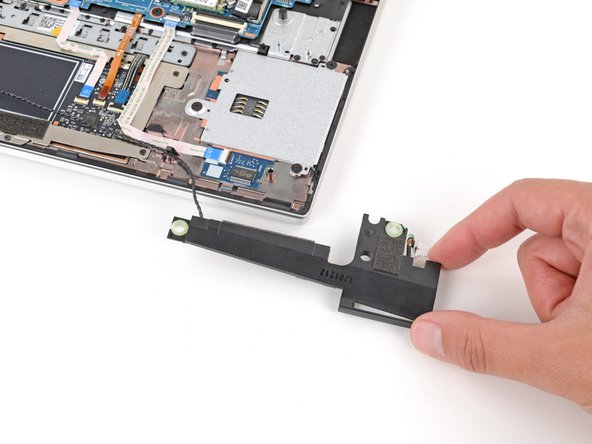

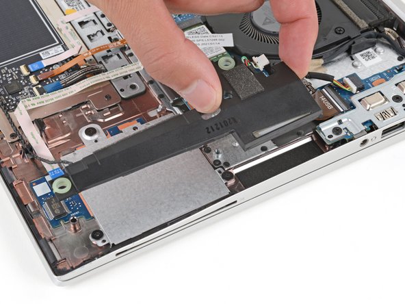

  11. HP EliteBook 845 G7 Smart Card Reader Replacement, Reposition the speaker: crwdns2935265:011crwdnd2935265:01crwdnd2935265:03crwdne2935265:0 HP EliteBook 845 G7 Smart Card Reader Replacement, Reposition the speaker: crwdns2935265:011crwdnd2935265:02crwdnd2935265:03crwdne2935265:0 HP EliteBook 845 G7 Smart Card Reader Replacement, Reposition the speaker: crwdns2935265:011crwdnd2935265:03crwdnd2935265:03crwdne2935265:0
    • Rubber grommets secure the top and bottom of the speaker.
    • Gently lift the speaker on the right side (the one covering the smart card reader) straight up and off its posts.
    • Don't try to fully remove the speaker—it's still tethered.
    • Place the speaker on your work surface, out of the way of the smart card reader.
    • Don't strain the speaker cable, and watch out for any screws that may stick to the speaker's internal magnet.
    • During reassembly, align the speaker grommets over their screw posts and press down gently to secure the speaker.

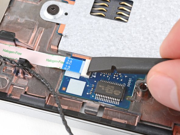

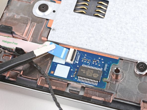

  12. HP EliteBook 845 G7 Smart Card Reader Replacement, Disconnect the smart card reader: crwdns2935265:012crwdnd2935265:01crwdnd2935265:03crwdne2935265:0 HP EliteBook 845 G7 Smart Card Reader Replacement, Disconnect the smart card reader: crwdns2935265:012crwdnd2935265:02crwdnd2935265:03crwdne2935265:0 HP EliteBook 845 G7 Smart Card Reader Replacement, Disconnect the smart card reader: crwdns2935265:012crwdnd2935265:03crwdnd2935265:03crwdne2935265:0
    • Use a spudger to lift the hinged locking flap on the smart card reader ZIF connector.
    • Use tweezers to gently pull the cable straight out of its socket.

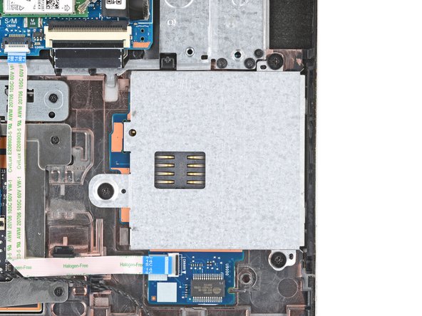

  13. HP EliteBook 845 G7 Smart Card Reader Replacement, Remove the smart card reader screws: crwdns2935265:013crwdnd2935265:01crwdnd2935265:02crwdne2935265:0 HP EliteBook 845 G7 Smart Card Reader Replacement, Remove the smart card reader screws: crwdns2935265:013crwdnd2935265:02crwdnd2935265:02crwdne2935265:0
    • Use a Phillips screwdriver to remove the three 2.4 mm‑long screws securing the smart card reader.

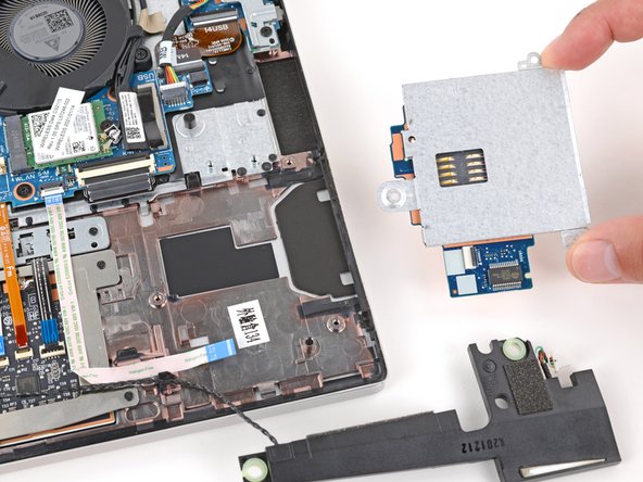

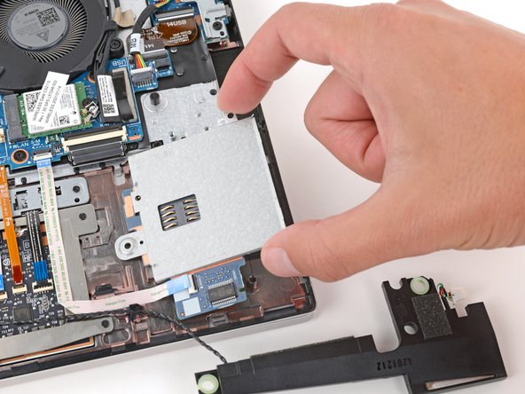

  14. HP EliteBook 845 G7 Smart Card Reader Replacement, Remove the smart card reader: crwdns2935265:014crwdnd2935265:01crwdnd2935265:03crwdne2935265:0 HP EliteBook 845 G7 Smart Card Reader Replacement, Remove the smart card reader: crwdns2935265:014crwdnd2935265:02crwdnd2935265:03crwdne2935265:0 HP EliteBook 845 G7 Smart Card Reader Replacement, Remove the smart card reader: crwdns2935265:014crwdnd2935265:03crwdnd2935265:03crwdne2935265:0
    • Use your fingers to lift and remove the smart card reader.
    • During reassembly, hold the smart card reader cable out of the way so it doesn't get stuck under the card reader when setting it into place.
