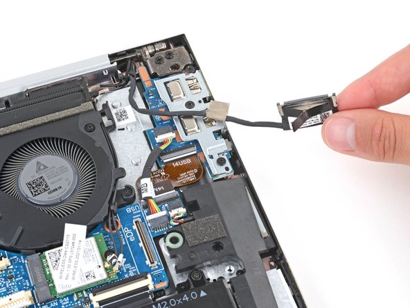

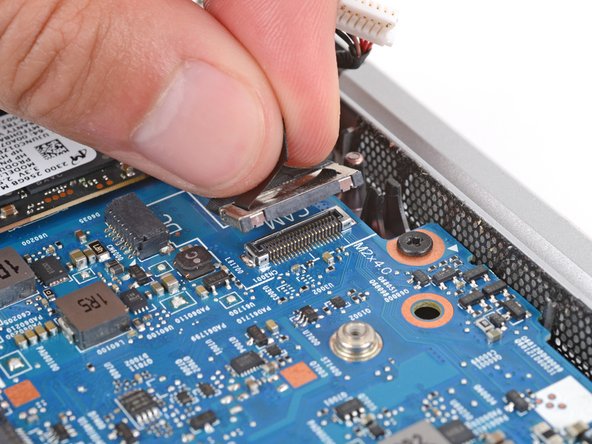

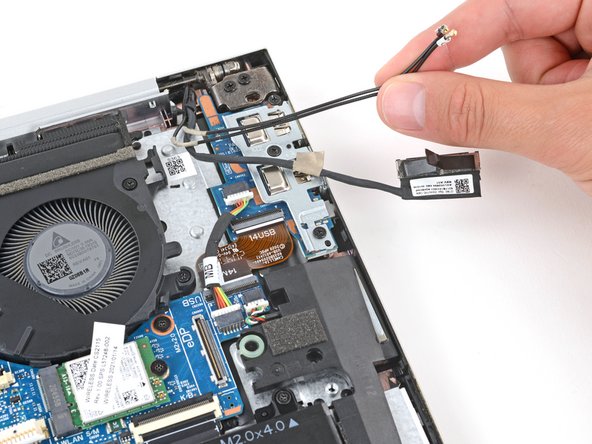

  9. HP EliteBook 845 G7 Display Panel Replacement, Disconnect the display cable: crwdns2935265:09crwdnd2935265:01crwdnd2935265:02crwdne2935265:0 HP EliteBook 845 G7 Display Panel Replacement, Disconnect the display cable: crwdns2935265:09crwdnd2935265:02crwdnd2935265:02crwdne2935265:0
    • Use your fingers to grip the plastic pull tab on the right display cable press connector, below the fan.
    • Pull straight up to disconnect the connector.
    • During reassembly, align the connector carefully over its socket and press down with your fingertip—first on one side, then the other—until it clicks into place. Don't try to force the connector into place. If you're having trouble, reposition it and try again. Don't use excessive force.

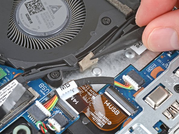

  10. HP EliteBook 845 G7 Display Panel Replacement, Peel up the fan tape: crwdns2935265:010crwdnd2935265:01crwdnd2935265:02crwdne2935265:0 HP EliteBook 845 G7 Display Panel Replacement, Peel up the fan tape: crwdns2935265:010crwdnd2935265:02crwdnd2935265:02crwdne2935265:0
    • Use tweezers or your fingers to peel up the cable tape near the right side of the fan.
    • You don't need to fully remove the tape—it can stay on the cable.

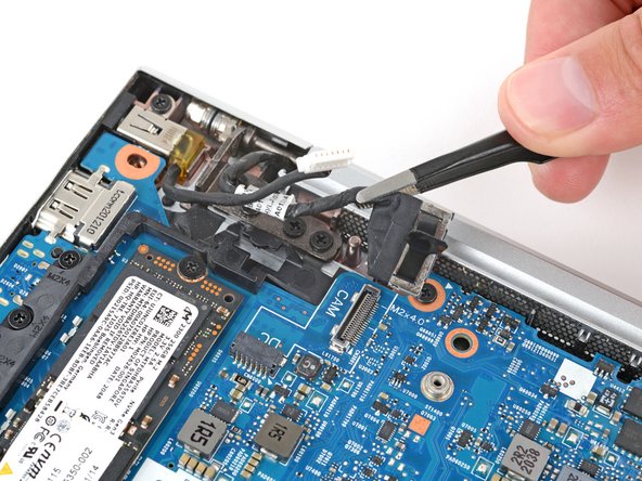

  11. HP EliteBook 845 G7 Display Panel Replacement, De‑route the fan cables: crwdns2935265:011crwdnd2935265:01crwdnd2935265:03crwdne2935265:0 HP EliteBook 845 G7 Display Panel Replacement, De‑route the fan cables: crwdns2935265:011crwdnd2935265:02crwdnd2935265:03crwdne2935265:0 HP EliteBook 845 G7 Display Panel Replacement, De‑route the fan cables: crwdns2935265:011crwdnd2935265:03crwdnd2935265:03crwdne2935265:0
    • Use your fingers to pull the display cable and two coaxial cables out from their clips on the right side of the fan.
    • During reassembly, use this photo as a reference to properly route the cables into their clips.

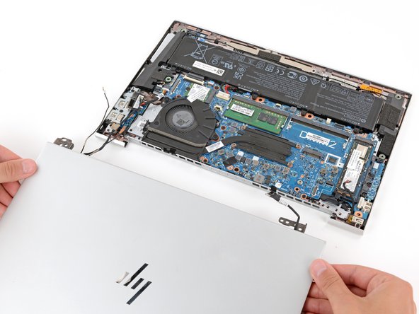

  17. HP EliteBook 845 G7 Display Panel Replacement, Fully open your laptop: crwdns2935265:017crwdnd2935265:01crwdnd2935265:01crwdne2935265:0
    • Fully open your laptop and set it keyboard-side down on a flat, clean work surface, with the display closest you.
    • During reassembly, if your screen clicks or snaps when it's opened or closed, loosen the screws and realign the screen.

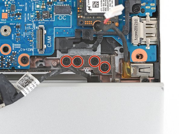

  18. HP EliteBook 845 G7 Display Panel Replacement, Remove the hinge screws: crwdns2935265:018crwdnd2935265:01crwdnd2935265:02crwdne2935265:0 HP EliteBook 845 G7 Display Panel Replacement, Remove the hinge screws: crwdns2935265:018crwdnd2935265:02crwdnd2935265:02crwdne2935265:0
    • Use a Phillips screwdriver to remove the six 4.6 mm‑long hinge screws—four in one hinge and two in the other.
    • During reassembly:
    • Before installing any hinge screws, make sure the display is properly aligned.
    • Tighten the hinge screws in ascending order based on the number stamped next to each screw hole.

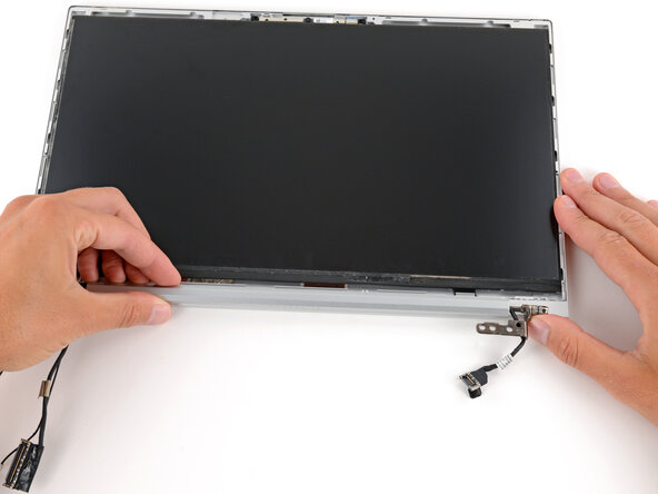

  19. HP EliteBook 845 G7 Display Panel Replacement, Remove the display: crwdns2935265:019crwdnd2935265:01crwdnd2935265:03crwdne2935265:0 HP EliteBook 845 G7 Display Panel Replacement, Remove the display: crwdns2935265:019crwdnd2935265:02crwdnd2935265:03crwdne2935265:0 HP EliteBook 845 G7 Display Panel Replacement, Remove the display: crwdns2935265:019crwdnd2935265:03crwdnd2935265:03crwdne2935265:0
    • Grip the display assembly near the hinges and lift straight up to remove it.
    • You may need to hold down the main body while guiding the hinges out of their recesses.
    • During reassembly, make sure both hinges on your replacement display assembly are fully open before lowering them into their recesses.

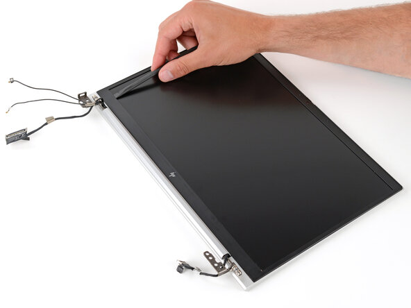

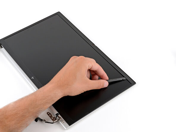

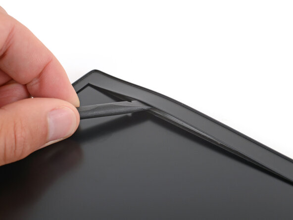

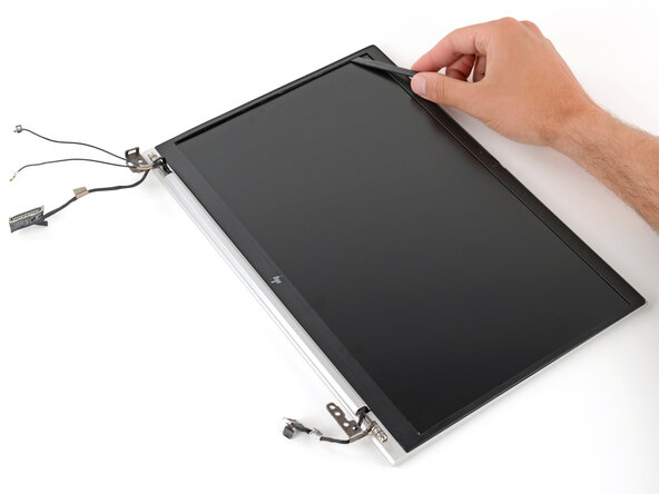

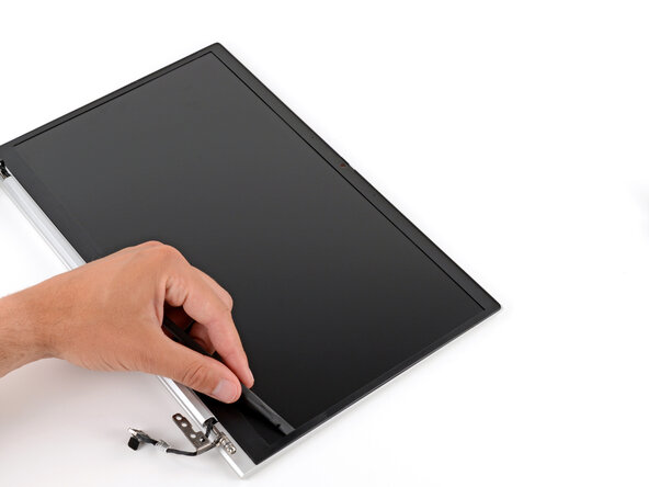

  20. HP EliteBook 845 G7 Display Panel Replacement, Separate the bezel: crwdns2935265:020crwdnd2935265:01crwdnd2935265:02crwdne2935265:0 HP EliteBook 845 G7 Display Panel Replacement, Separate the bezel: crwdns2935265:020crwdnd2935265:02crwdnd2935265:02crwdne2935265:0
    • Push the flat end of a spudger underneath the top edge of the display's plastic bezel, near the top left corner.
    • The plastic bezel is bendable and secures to the display with light adhesive.

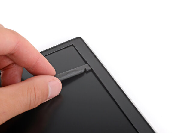

  21. HP EliteBook 845 G7 Display Panel Replacement: crwdns2935265:021crwdnd2935265:01crwdnd2935265:03crwdne2935265:0 HP EliteBook 845 G7 Display Panel Replacement: crwdns2935265:021crwdnd2935265:02crwdnd2935265:03crwdne2935265:0 HP EliteBook 845 G7 Display Panel Replacement: crwdns2935265:021crwdnd2935265:03crwdnd2935265:03crwdne2935265:0
    • Slide the spudger across the top edge, around the top right corner, and down the right edge to separate the adhesive securing the bezel.
  22. HP EliteBook 845 G7 Display Panel Replacement: crwdns2935265:022crwdnd2935265:01crwdnd2935265:03crwdne2935265:0 HP EliteBook 845 G7 Display Panel Replacement: crwdns2935265:022crwdnd2935265:02crwdnd2935265:03crwdne2935265:0 HP EliteBook 845 G7 Display Panel Replacement: crwdns2935265:022crwdnd2935265:03crwdnd2935265:03crwdne2935265:0
    • Slide the spudger across the bottom edge, around the bottom left corner, and up the left edge to separate the adhesive securing the bezel.
  23. HP EliteBook 845 G7 Display Panel Replacement: crwdns2935265:023crwdnd2935265:01crwdnd2935265:03crwdne2935265:0 HP EliteBook 845 G7 Display Panel Replacement: crwdns2935265:023crwdnd2935265:02crwdnd2935265:03crwdne2935265:0 HP EliteBook 845 G7 Display Panel Replacement: crwdns2935265:023crwdnd2935265:03crwdnd2935265:03crwdne2935265:0

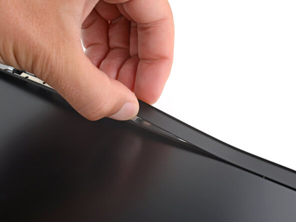

    • Re-insert the flat end of the spudger underneath the top edge of the display's plastic bezel, near the top left corner.
    • Lift up to peel the bezel away from the display, until you can grip it with your fingers.

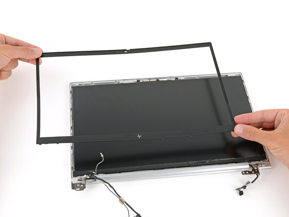

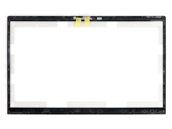

  24. HP EliteBook 845 G7 Display Panel Replacement, Remove the bezel: crwdns2935265:024crwdnd2935265:01crwdnd2935265:03crwdne2935265:0 HP EliteBook 845 G7 Display Panel Replacement, Remove the bezel: crwdns2935265:024crwdnd2935265:02crwdnd2935265:03crwdne2935265:0 HP EliteBook 845 G7 Display Panel Replacement, Remove the bezel: crwdns2935265:024crwdnd2935265:03crwdnd2935265:03crwdne2935265:0
    • Once a portion of the bezel lifts to where you can grip it with your fingers, peel the bezel up around the entire perimeter, using the spudger to separate any sections still adhered.
    • Remove the plastic bezel.
    • During reassembly, make sure to remove all the plastic liners and pieces of tape from your replacement bezel. Check thoroughly around the entire perimeter.

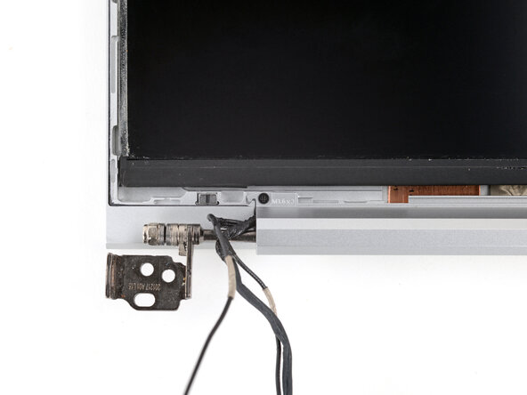

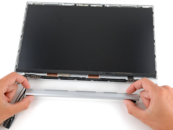

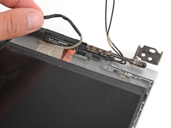

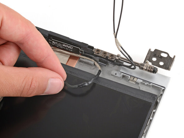

  25. HP EliteBook 845 G7 Display Panel Replacement, Unscrew the chin cover: crwdns2935265:025crwdnd2935265:01crwdnd2935265:02crwdne2935265:0 HP EliteBook 845 G7 Display Panel Replacement, Unscrew the chin cover: crwdns2935265:025crwdnd2935265:02crwdnd2935265:02crwdne2935265:0
    • Use a Phillips screwdriver to remove the 2.0 mm-long screw securing the chin cover.

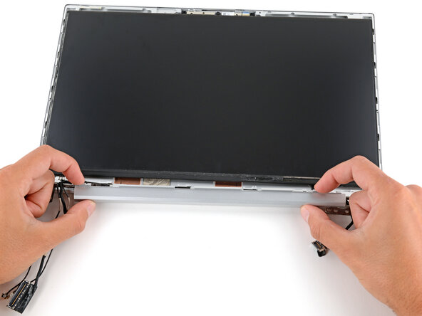

  26. HP EliteBook 845 G7 Display Panel Replacement, Unlock the chin cover: crwdns2935265:026crwdnd2935265:01crwdnd2935265:02crwdne2935265:0 HP EliteBook 845 G7 Display Panel Replacement, Unlock the chin cover: crwdns2935265:026crwdnd2935265:02crwdnd2935265:02crwdne2935265:0
    • Slide the entire chin cover to the right to unlock it.
  27. HP EliteBook 845 G7 Display Panel Replacement, Remove the chin cover: crwdns2935265:027crwdnd2935265:01crwdnd2935265:03crwdne2935265:0 HP EliteBook 845 G7 Display Panel Replacement, Remove the chin cover: crwdns2935265:027crwdnd2935265:02crwdnd2935265:03crwdne2935265:0 HP EliteBook 845 G7 Display Panel Replacement, Remove the chin cover: crwdns2935265:027crwdnd2935265:03crwdnd2935265:03crwdne2935265:0
    • Rotate the chin cover down and away from the display.
    • Remove the chin cover.
    • Before reinstalling the chin cover, make sure all of the cables along the bottom of the screen are tucked into their recess and over the screen hinges. Use this photo as a reference.

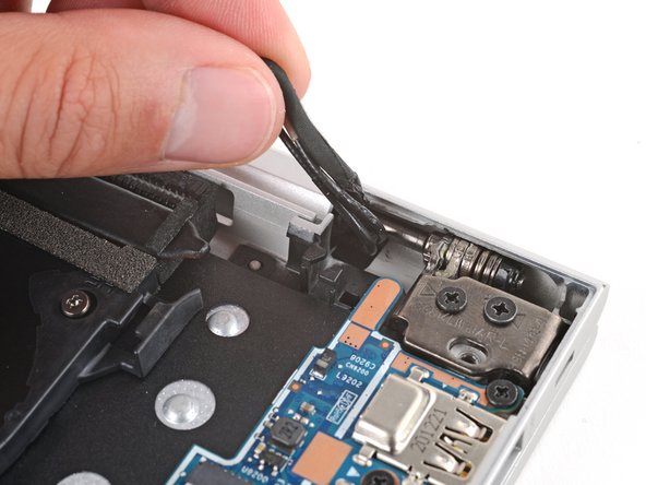

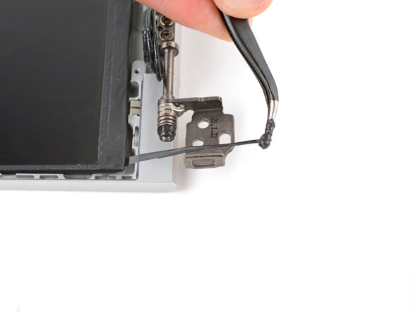

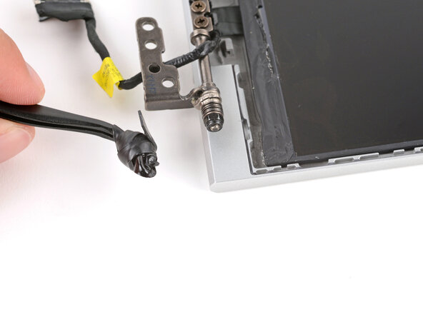

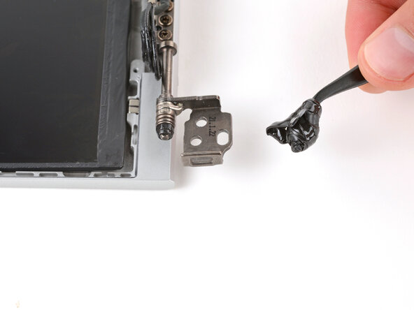

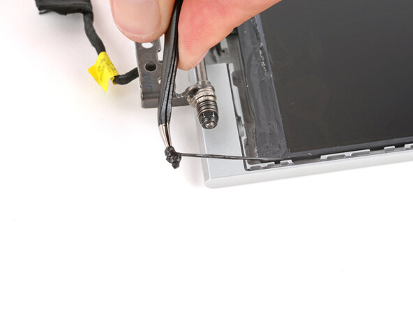

  28. HP EliteBook 845 G7 Display Panel Replacement, Remove the screen adhesive strips: crwdns2935265:028crwdnd2935265:01crwdnd2935265:02crwdne2935265:0 HP EliteBook 845 G7 Display Panel Replacement, Remove the screen adhesive strips: crwdns2935265:028crwdnd2935265:02crwdnd2935265:02crwdne2935265:0
    • The display panel attaches to the shell with two stretch-release adhesive strips.
    • Near the bottom right side of the screen, use a pair of tweezers to peel back the black pull tab on the stretch-release adhesive strip until you can grip it with your fingers.
  29. HP EliteBook 845 G7 Display Panel Replacement: crwdns2935265:029crwdnd2935265:01crwdnd2935265:03crwdne2935265:0 HP EliteBook 845 G7 Display Panel Replacement: crwdns2935265:029crwdnd2935265:02crwdnd2935265:03crwdne2935265:0 HP EliteBook 845 G7 Display Panel Replacement: crwdns2935265:029crwdnd2935265:03crwdnd2935265:03crwdne2935265:0
    • Grab an adhesive strip's pull tab and slowly pull it out from underneath the screen.
    • If using a pair of tweezers, spin the tweezers to wrap the strip up as it releases, pulling as you go.
    • Keep the angle of the adhesive strip as parallel to the display as you can.
    • Pull the adhesive strip until it's freed from under the screen.

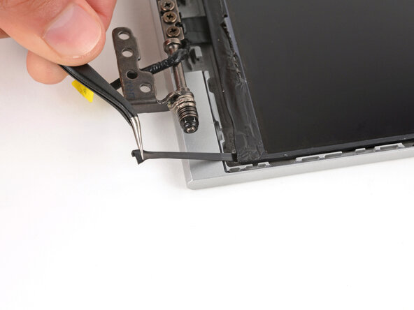

  30. HP EliteBook 845 G7 Display Panel Replacement: crwdns2935265:030crwdnd2935265:01crwdnd2935265:03crwdne2935265:0 HP EliteBook 845 G7 Display Panel Replacement: crwdns2935265:030crwdnd2935265:02crwdnd2935265:03crwdne2935265:0 HP EliteBook 845 G7 Display Panel Replacement: crwdns2935265:030crwdnd2935265:03crwdnd2935265:03crwdne2935265:0
    • Repeat and remove the adhesive strip from the left side of the screen.

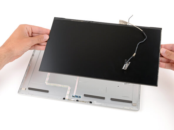

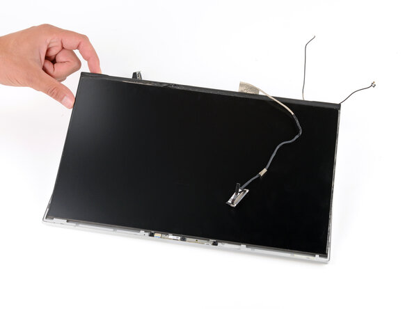

  32. HP EliteBook 845 G7 Display Panel Replacement, Remove the display panel: crwdns2935265:032crwdnd2935265:01crwdnd2935265:03crwdne2935265:0 HP EliteBook 845 G7 Display Panel Replacement, Remove the display panel: crwdns2935265:032crwdnd2935265:02crwdnd2935265:03crwdne2935265:0 HP EliteBook 845 G7 Display Panel Replacement, Remove the display panel: crwdns2935265:032crwdnd2935265:03crwdnd2935265:03crwdne2935265:0
    • Lift and remove the display panel from the shell.

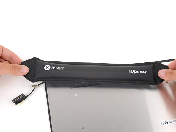

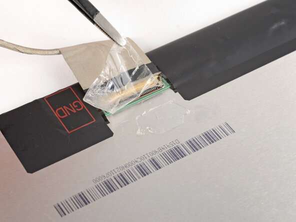

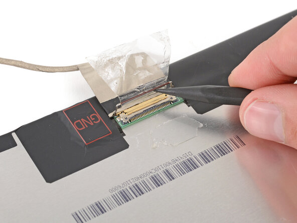

  33. HP EliteBook 845 G7 Display Panel Replacement, Transfer the display cable: crwdns2935265:033crwdnd2935265:01crwdnd2935265:02crwdne2935265:0 HP EliteBook 845 G7 Display Panel Replacement, Transfer the display cable: crwdns2935265:033crwdnd2935265:02crwdnd2935265:02crwdne2935265:0
    • Replacement display panels may or may not come with an included display cable. If it's missing on the replacement, you'll need to transfer the old one over from your original panel.
    • A thin layer of tape covers and protects the display cable connector.
    • Prepare an iOpener and apply it to the screen-side display connector tape for one minute to soften the adhesive.
    • A hair dryer may also be used, but be careful not to overheat the components—keep the hair dryer well above the connector and moving at all times.

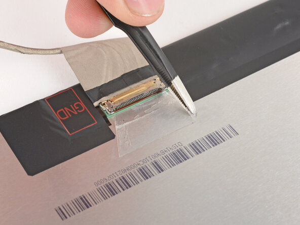

  34. HP EliteBook 845 G7 Display Panel Replacement, Peel up the tape: crwdns2935265:034crwdnd2935265:01crwdnd2935265:03crwdne2935265:0 HP EliteBook 845 G7 Display Panel Replacement, Peel up the tape: crwdns2935265:034crwdnd2935265:02crwdnd2935265:03crwdne2935265:0 HP EliteBook 845 G7 Display Panel Replacement, Peel up the tape: crwdns2935265:034crwdnd2935265:03crwdnd2935265:03crwdne2935265:0
    • Use the flat end of a spudger to push up a corner of the tape until you can grip it with a pair of tweezers.
    • Use a pair of tweezers to peel the tape back, over the connector.

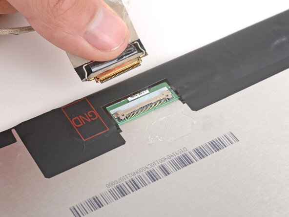

  35. HP EliteBook 845 G7 Display Panel Replacement, Disconnect the display cable: crwdns2935265:035crwdnd2935265:01crwdnd2935265:03crwdne2935265:0 HP EliteBook 845 G7 Display Panel Replacement, Disconnect the display cable: crwdns2935265:035crwdnd2935265:02crwdnd2935265:03crwdne2935265:0 HP EliteBook 845 G7 Display Panel Replacement, Disconnect the display cable: crwdns2935265:035crwdnd2935265:03crwdnd2935265:03crwdne2935265:0
    • Use the point of a spudger to lift up the thin metal locking bar on the display connector.
    • Use your fingers to slide the display cable out of its connector.
