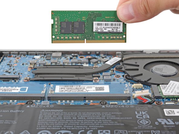

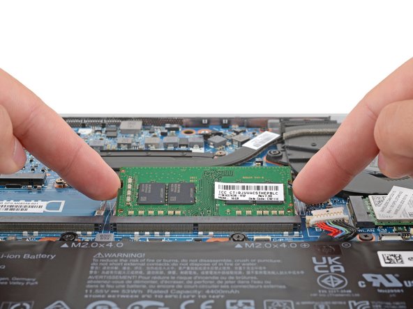

  8. HP EliteBook 840 G7 Memory Module Replacement, Remove the memory module: crwdns2935265:08crwdnd2935265:01crwdnd2935265:03crwdne2935265:0 HP EliteBook 840 G7 Memory Module Replacement, Remove the memory module: crwdns2935265:08crwdnd2935265:02crwdnd2935265:03crwdne2935265:0 HP EliteBook 840 G7 Memory Module Replacement, Remove the memory module: crwdns2935265:08crwdnd2935265:03crwdnd2935265:03crwdne2935265:0
    • Depending on your laptop configuration, you may need to remove a metal shield or plastic cover to access the memory modules.
    • Your laptop has two memory slots, each with a pair of metal arms that secure a memory module. This laptop supports DDR4 SODIMM modules.
    • Simultaneously push out the metal arms on each side of the memory module until they disengage and the module pops up at a slight angle.
    • Pull the module out of its socket to remove it.
    • Use the same process to remove the other memory module.
    • To install a memory module, insert it into its socket at a slight downward angle, then push down firmly until both metal arms lock it in place.
    • If only installing one module, insert it into the slot labeled DIMM 1.
