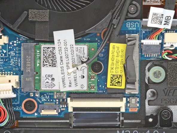

  8. HP EliteBook 840 Aero G8 Wi-Fi Module Replacement, Disconnect the WLAN module cables: crwdns2935265:08crwdnd2935265:01crwdnd2935265:03crwdne2935265:0 HP EliteBook 840 Aero G8 Wi-Fi Module Replacement, Disconnect the WLAN module cables: crwdns2935265:08crwdnd2935265:02crwdnd2935265:03crwdne2935265:0 HP EliteBook 840 Aero G8 Wi-Fi Module Replacement, Disconnect the WLAN module cables: crwdns2935265:08crwdnd2935265:03crwdnd2935265:03crwdne2935265:0
    • Slide an arm of a pair of angled tweezers under the metal neck of one of the coaxial connectors on the WLAN (Wi-Fi) module, located just below the fan.
    • Lift straight up to disconnect the cable.
    • Repeat to disconnect the second connector.
    • During reassembly:
    • Connect the cable with black tape to the socket with a black arrow below it, and the cable with white tape to the socket with a white arrow.
    • Use tweezers to hold a connector in place over its socket and gently press down with your finger or a spudger—the connector should "snap" into place. If you're having trouble, reposition the head and try again. Don't use excessive force.

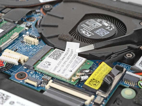

  9. HP EliteBook 840 Aero G8 Wi-Fi Module Replacement, Peel up the Wi-Fi module tape: crwdns2935265:09crwdnd2935265:01crwdnd2935265:02crwdne2935265:0 HP EliteBook 840 Aero G8 Wi-Fi Module Replacement, Peel up the Wi-Fi module tape: crwdns2935265:09crwdnd2935265:02crwdnd2935265:02crwdne2935265:0
    • Use tweezers to peel the tape off the bottom edge of the fan.
    • You don't need to fully remove the tape—it can stay on the Wi-Fi module.
  10. HP EliteBook 840 Aero G8 Wi-Fi Module Replacement, Remove the Wi-Fi module screw: crwdns2935265:010crwdnd2935265:01crwdnd2935265:02crwdne2935265:0 HP EliteBook 840 Aero G8 Wi-Fi Module Replacement, Remove the Wi-Fi module screw: crwdns2935265:010crwdnd2935265:02crwdnd2935265:02crwdne2935265:0
    • Use a Phillips #1 screwdriver to remove the 2.5 mm‑long screw securing the Wi-Fi module.
    • With the screw removed, the module may pop up at a slight angle.
    • During reassembly, gently hold down the module while installing its screw.

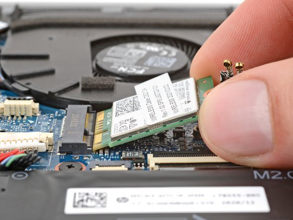

  11. HP EliteBook 840 Aero G8 Wi-Fi Module Replacement, Remove the Wi-Fi module: crwdns2935265:011crwdnd2935265:01crwdnd2935265:02crwdne2935265:0 HP EliteBook 840 Aero G8 Wi-Fi Module Replacement, Remove the Wi-Fi module: crwdns2935265:011crwdnd2935265:02crwdnd2935265:02crwdne2935265:0
    • Don't pull up at a sharp angle, or you may damage the Wi-Fi module and its socket.
    • Grip the Wi-Fi module by its edges and pull it straight out of its socket to remove it.
    • During reassembly, insert the module into its socket at a slight downward angle.
