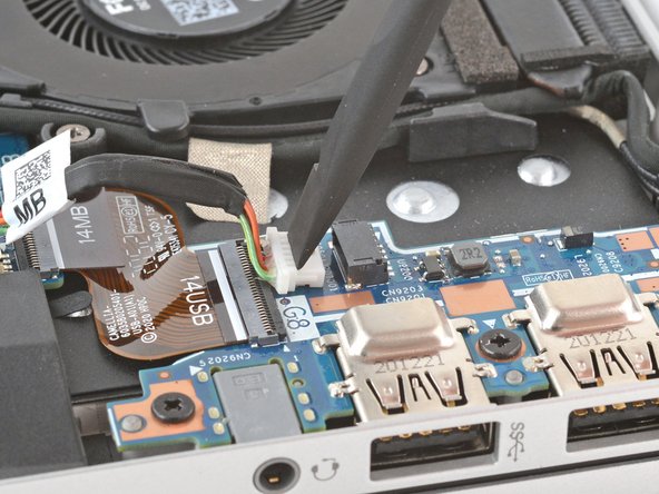

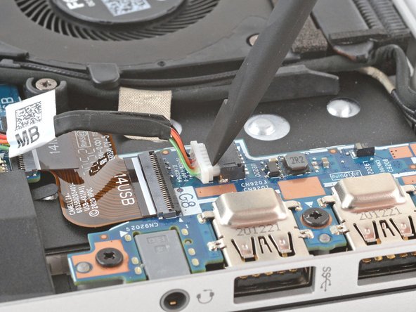

  8. HP EliteBook 840 Aero G8 USB Board Replacement, Disconnect the USB board cables: crwdns2935265:08crwdnd2935265:01crwdnd2935265:03crwdne2935265:0 HP EliteBook 840 Aero G8 USB Board Replacement, Disconnect the USB board cables: crwdns2935265:08crwdnd2935265:02crwdnd2935265:03crwdne2935265:0 HP EliteBook 840 Aero G8 USB Board Replacement, Disconnect the USB board cables: crwdns2935265:08crwdnd2935265:03crwdnd2935265:03crwdne2935265:0
    • Use the flat end of a spudger to push the USB board sliding connector fully out of its socket.
    • Always push or pull the connector, not the cables themselves.

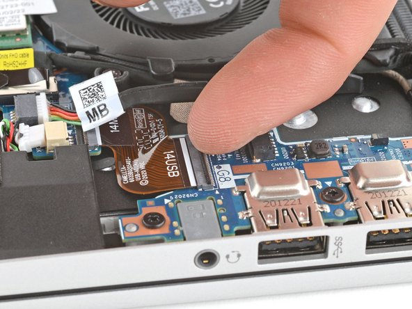

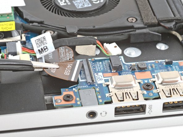

  9. HP EliteBook 840 Aero G8 USB Board Replacement: crwdns2935265:09crwdnd2935265:01crwdnd2935265:03crwdne2935265:0 HP EliteBook 840 Aero G8 USB Board Replacement: crwdns2935265:09crwdnd2935265:02crwdnd2935265:03crwdne2935265:0 HP EliteBook 840 Aero G8 USB Board Replacement: crwdns2935265:09crwdnd2935265:03crwdnd2935265:03crwdne2935265:0
    • Use a clean fingernail or the flat end of a spudger to flip up the hinged locking flap on the USB board ZIF connector.
    • Use tweezers or your fingers to gently pull the cable straight out of its socket.

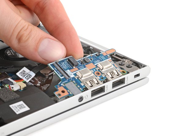

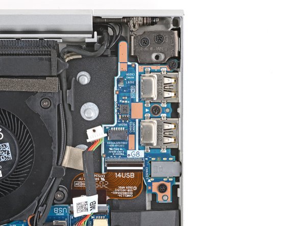

  10. HP EliteBook 840 Aero G8 USB Board Replacement, Remove the USB board screws: crwdns2935265:010crwdnd2935265:01crwdnd2935265:02crwdne2935265:0 HP EliteBook 840 Aero G8 USB Board Replacement, Remove the USB board screws: crwdns2935265:010crwdnd2935265:02crwdnd2935265:02crwdne2935265:0
    • Use a Phillips screwdriver to remove the three 4.5 mm‑long screws securing the USB board.

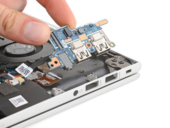

  11. HP EliteBook 840 Aero G8 USB Board Replacement, Remove the USB board: crwdns2935265:011crwdnd2935265:01crwdnd2935265:03crwdne2935265:0 HP EliteBook 840 Aero G8 USB Board Replacement, Remove the USB board: crwdns2935265:011crwdnd2935265:02crwdnd2935265:03crwdne2935265:0 HP EliteBook 840 Aero G8 USB Board Replacement, Remove the USB board: crwdns2935265:011crwdnd2935265:03crwdnd2935265:03crwdne2935265:0
    • Depending on your laptop configuration, there may be a metal bracket on the board you need to remove.
    • Lift the left edge of the USB board and pull it toward the fan to remove the board.
    • During reassembly:
    • Hold the cable out of the way so it doesn't get stuck underneath the board.
    • Slide the ports towards their cutouts in the chassis at a shallow angle, allowing the alignment posts to slot into place.
Compare your new replacement part to the original part—you may need to transfer remaining components or remove adhesive backings from the new part before you install it.
