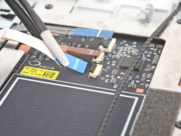

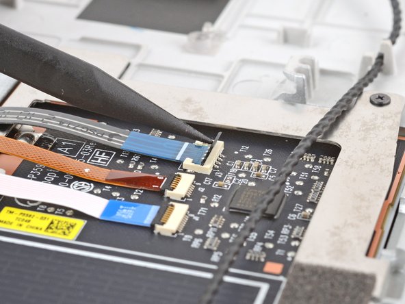

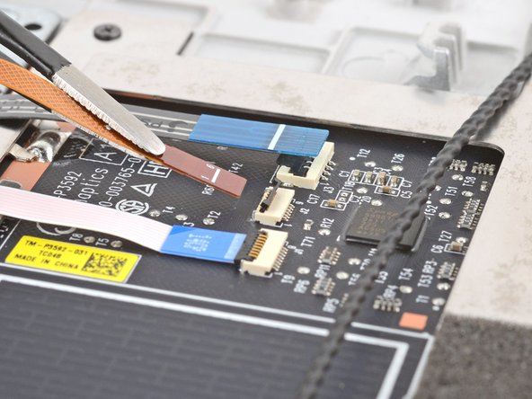

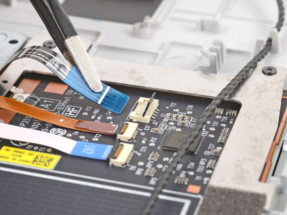

  10. HP EliteBook 840 Aero G8 Touchpad Replacement, Disconnect the touchpad cables: crwdns2935265:010crwdnd2935265:01crwdnd2935265:03crwdne2935265:0 HP EliteBook 840 Aero G8 Touchpad Replacement, Disconnect the touchpad cables: crwdns2935265:010crwdnd2935265:02crwdnd2935265:03crwdne2935265:0 HP EliteBook 840 Aero G8 Touchpad Replacement, Disconnect the touchpad cables: crwdns2935265:010crwdnd2935265:03crwdnd2935265:03crwdne2935265:0
    • Use a spudger to lift the hinged locking flap on one of the three ZIF connectors near the top right corner of the touchpad.
    • Use tweezers to gently pull the cable straight out of its socket.

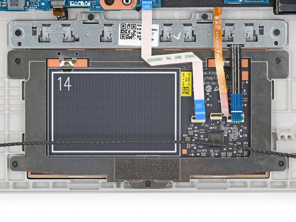

  11. HP EliteBook 840 Aero G8 Touchpad Replacement: crwdns2935265:011crwdnd2935265:01crwdnd2935265:03crwdne2935265:0 HP EliteBook 840 Aero G8 Touchpad Replacement: crwdns2935265:011crwdnd2935265:02crwdnd2935265:03crwdne2935265:0 HP EliteBook 840 Aero G8 Touchpad Replacement: crwdns2935265:011crwdnd2935265:03crwdnd2935265:03crwdne2935265:0
    • Repeat the previous step to disconnect the two remaining touchpad cables.

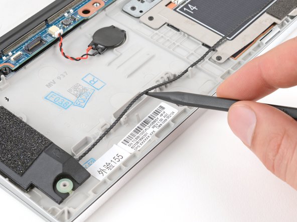

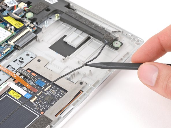

  12. HP EliteBook 840 Aero G8 Touchpad Replacement, De‑route the speaker cable: crwdns2935265:012crwdnd2935265:01crwdnd2935265:03crwdne2935265:0 HP EliteBook 840 Aero G8 Touchpad Replacement, De‑route the speaker cable: crwdns2935265:012crwdnd2935265:02crwdnd2935265:03crwdne2935265:0 HP EliteBook 840 Aero G8 Touchpad Replacement, De‑route the speaker cable: crwdns2935265:012crwdnd2935265:03crwdnd2935265:03crwdne2935265:0
    • Use a spudger or your fingers to lift the entire speaker cable out of its clips on the bottom edge.

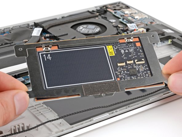

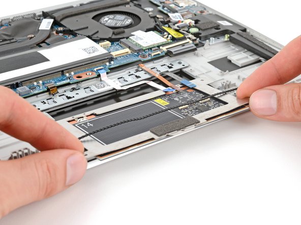

  14. HP EliteBook 840 Aero G8 Touchpad Replacement, Remove the touchpad: crwdns2935265:014crwdnd2935265:01crwdnd2935265:03crwdne2935265:0 HP EliteBook 840 Aero G8 Touchpad Replacement, Remove the touchpad: crwdns2935265:014crwdnd2935265:02crwdnd2935265:03crwdne2935265:0 HP EliteBook 840 Aero G8 Touchpad Replacement, Remove the touchpad: crwdns2935265:014crwdnd2935265:03crwdnd2935265:03crwdne2935265:0
    • Lift the bottom corners of the touchpad with your fingers and slide the top edge out from under the motherboard.
    • Slide the touchpad under the speaker cable and remove it.
    • During reassembly, make sure no cables get stuck under the touchpad when inserting it.
