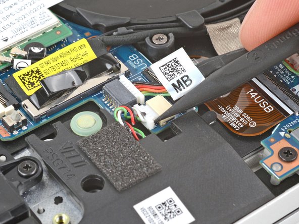

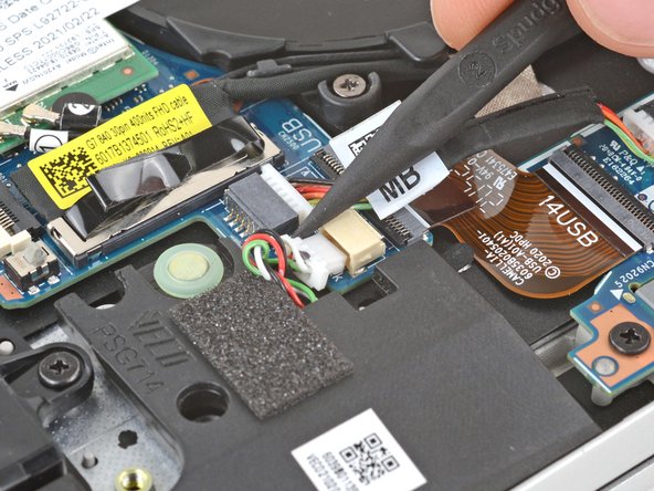

  8. HP EliteBook 840 Aero G8 Speakers Replacement, Disconnect the speakers: crwdns2935265:08crwdnd2935265:01crwdnd2935265:03crwdne2935265:0 HP EliteBook 840 Aero G8 Speakers Replacement, Disconnect the speakers: crwdns2935265:08crwdnd2935265:02crwdnd2935265:03crwdne2935265:0 HP EliteBook 840 Aero G8 Speakers Replacement, Disconnect the speakers: crwdns2935265:08crwdnd2935265:03crwdnd2935265:03crwdne2935265:0
    • Use the point of a spudger to push on alternating sides of the speakers' sliding connector to walk it completely out of its socket.

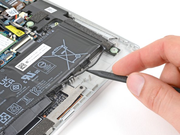

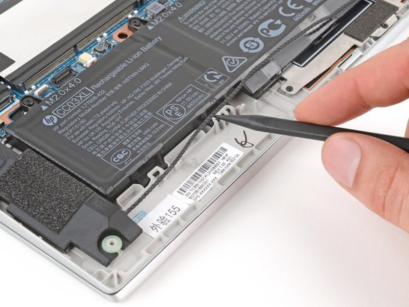

  9. HP EliteBook 840 Aero G8 Speakers Replacement, Unclip the speaker cable: crwdns2935265:09crwdnd2935265:01crwdnd2935265:03crwdne2935265:0 HP EliteBook 840 Aero G8 Speakers Replacement, Unclip the speaker cable: crwdns2935265:09crwdnd2935265:02crwdnd2935265:03crwdne2935265:0 HP EliteBook 840 Aero G8 Speakers Replacement, Unclip the speaker cable: crwdns2935265:09crwdnd2935265:03crwdnd2935265:03crwdne2935265:0
    • Use a spudger or your fingers to lift the entire speaker cable out of its clips on the bottom edge.

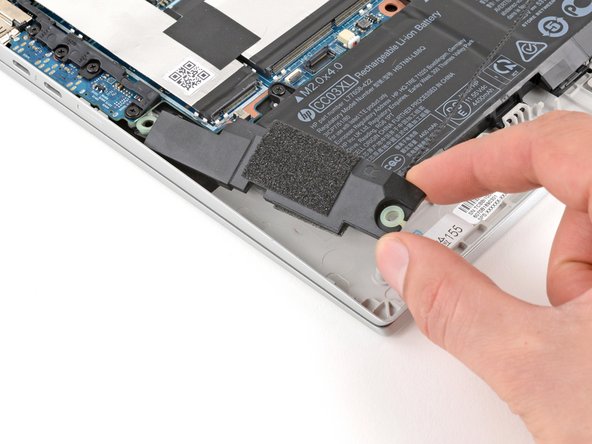

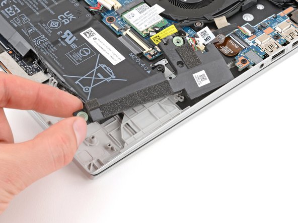

  10. HP EliteBook 840 Aero G8 Speakers Replacement, Remove the speakers: crwdns2935265:010crwdnd2935265:01crwdnd2935265:03crwdne2935265:0 HP EliteBook 840 Aero G8 Speakers Replacement, Remove the speakers: crwdns2935265:010crwdnd2935265:02crwdnd2935265:03crwdne2935265:0 HP EliteBook 840 Aero G8 Speakers Replacement, Remove the speakers: crwdns2935265:010crwdnd2935265:03crwdnd2935265:03crwdne2935265:0
    • Rubber grommets secure the top and bottom of both speakers.
    • Lift the speakers straight up and off their posts to remove them.
    • During reassembly:
    • Make sure both speakers have grommets. If they don't, transfer the grommets from the original speakers to the replacements.
    • Align the grommets over their screw posts and press down gently to secure the speakers in place.
    • The speaker labelled R will go on your left‑hand side since the laptop is laying upside down.
Compare your new replacement part to the original part—you may need to transfer remaining components or remove adhesive backings from the new part before you install it.
