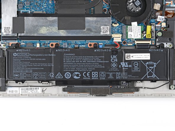

  8. HP EliteBook 840 Aero G8 RTC Battery Replacement, Remove the battery screws: crwdns2935265:08crwdnd2935265:01crwdnd2935265:02crwdne2935265:0 HP EliteBook 840 Aero G8 RTC Battery Replacement, Remove the battery screws: crwdns2935265:08crwdnd2935265:02crwdnd2935265:02crwdne2935265:0
    • Use a Phillips screwdriver to remove the four 4.5 mm‑long screws securing the battery.

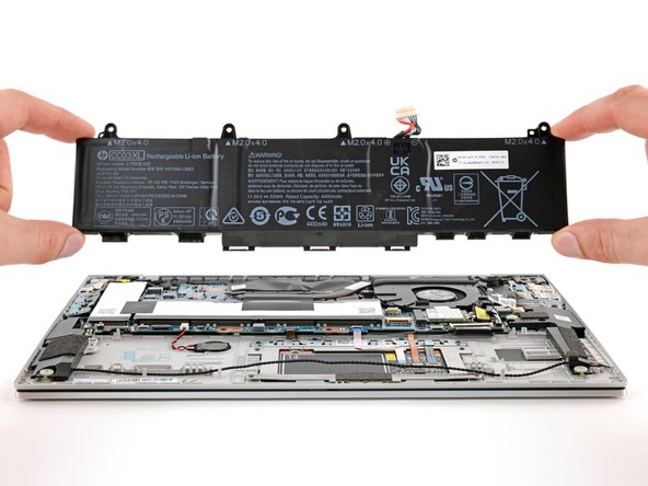

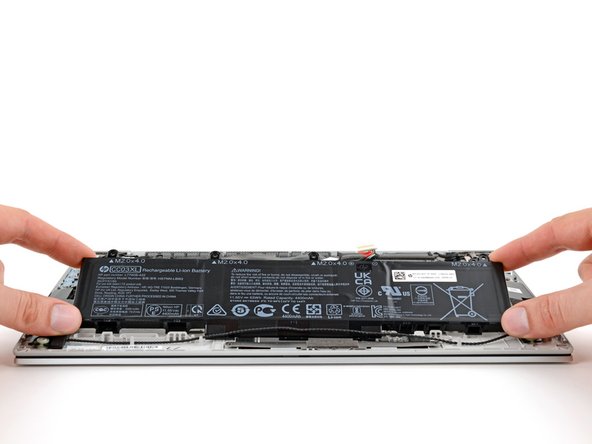

  9. HP EliteBook 840 Aero G8 RTC Battery Replacement, Remove the battery: crwdns2935265:09crwdnd2935265:01crwdnd2935265:03crwdne2935265:0 HP EliteBook 840 Aero G8 RTC Battery Replacement, Remove the battery: crwdns2935265:09crwdnd2935265:02crwdnd2935265:03crwdne2935265:0 HP EliteBook 840 Aero G8 RTC Battery Replacement, Remove the battery: crwdns2935265:09crwdnd2935265:03crwdnd2935265:03crwdne2935265:0
    • Lift the top edge of that battery and slide the tabs on the bottom edge out of their slots.
    • Remove the battery.
    • Never reuse a deformed or damaged battery—it's a fire hazard. Replace it with a new battery.

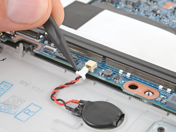

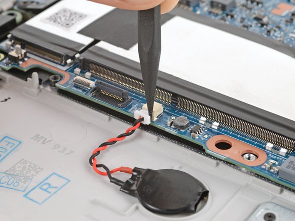

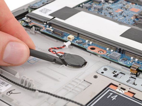

  10. HP EliteBook 840 Aero G8 RTC Battery Replacement, Disconnect the RTC battery: crwdns2935265:010crwdnd2935265:01crwdnd2935265:03crwdne2935265:0 HP EliteBook 840 Aero G8 RTC Battery Replacement, Disconnect the RTC battery: crwdns2935265:010crwdnd2935265:02crwdnd2935265:03crwdne2935265:0 HP EliteBook 840 Aero G8 RTC Battery Replacement, Disconnect the RTC battery: crwdns2935265:010crwdnd2935265:03crwdnd2935265:03crwdne2935265:0
    • Use the point of a spudger to push on alternating sides of the RTC battery's sliding connector to walk it completely out of its socket.
  11. HP EliteBook 840 Aero G8 RTC Battery Replacement, Remove the RTC battery: crwdns2935265:011crwdnd2935265:01crwdnd2935265:03crwdne2935265:0 HP EliteBook 840 Aero G8 RTC Battery Replacement, Remove the RTC battery: crwdns2935265:011crwdnd2935265:02crwdnd2935265:03crwdne2935265:0 HP EliteBook 840 Aero G8 RTC Battery Replacement, Remove the RTC battery: crwdns2935265:011crwdnd2935265:03crwdnd2935265:03crwdne2935265:0

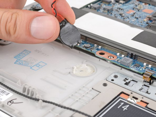

    • Use the flat end of a spudger to gently pry up the RTC battery, separating the adhesive securing it to the frame.
    • Remove the RTC battery.
    • During reassembly:
    • When installing a new RTC battery, make sure the cable is facing its socket on the motherboard.
    • If your replacement battery comes with adhesive pre‑installed, remove the old adhesive from the frame before installing the new battery.
    • If it doesn't, you can reuse the adhesive if it's still sticky. If not, use thin, double‑sided tape to secure your new battery.
Compare your new replacement part to the original part—you may need to transfer remaining components or remove adhesive backings from the new part before you install it.
Take your e-waste to an R2 or e-Stewards certified recycler. Depending on your region, used HP devices and parts can be returned for reuse or recycling through the HP Planet Partners program.
