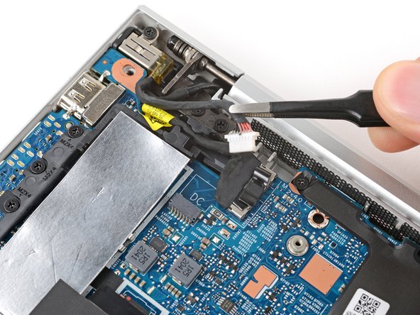

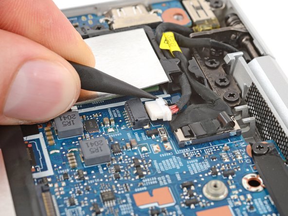

  8. HP EliteBook 840 Aero G8 Power Port Replacement, Disconnect the power connector cable: crwdns2935265:08crwdnd2935265:01crwdnd2935265:03crwdne2935265:0 HP EliteBook 840 Aero G8 Power Port Replacement, Disconnect the power connector cable: crwdns2935265:08crwdnd2935265:02crwdnd2935265:03crwdne2935265:0 HP EliteBook 840 Aero G8 Power Port Replacement, Disconnect the power connector cable: crwdns2935265:08crwdnd2935265:03crwdnd2935265:03crwdne2935265:0
    • Use the point of a spudger or your fingernail to push on alternating sides of the power connector's sliding connector to walk it completely out of its socket near the left hinge.
    • During reassembly, make sure the side of the connector marked with a black dot is facing up before reconnecting the cable.

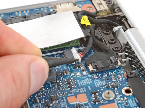

  9. HP EliteBook 840 Aero G8 Power Port Replacement: crwdns2935265:09crwdnd2935265:01crwdnd2935265:02crwdne2935265:0 HP EliteBook 840 Aero G8 Power Port Replacement: crwdns2935265:09crwdnd2935265:02crwdnd2935265:02crwdne2935265:0
    • Use tweezers or your fingers to pull the power connector cable out of its clip.
    • During reassembly, use this photo as a reference to properly route the cable into its clips.

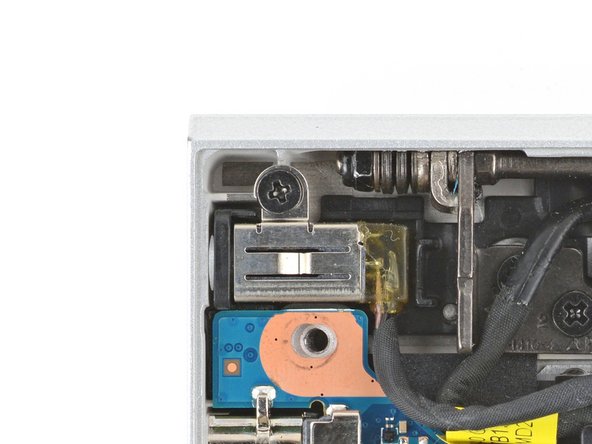

  10. HP EliteBook 840 Aero G8 Power Port Replacement, Remove the power connector port screw: crwdns2935265:010crwdnd2935265:01crwdnd2935265:02crwdne2935265:0 HP EliteBook 840 Aero G8 Power Port Replacement, Remove the power connector port screw: crwdns2935265:010crwdnd2935265:02crwdnd2935265:02crwdne2935265:0
    • Use a Phillips screwdriver to remove the 4.6 mm‑long screw securing the power port.

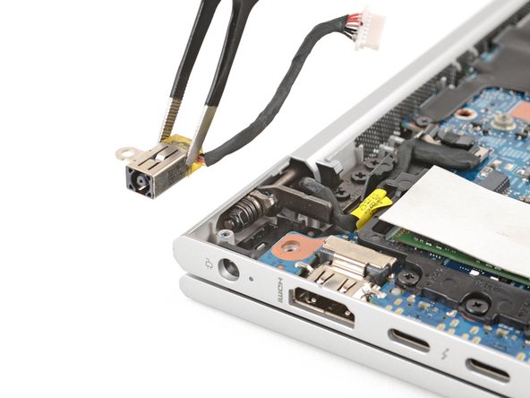

  11. HP EliteBook 840 Aero G8 Power Port Replacement, Remove the power connector port: crwdns2935265:011crwdnd2935265:01crwdnd2935265:02crwdne2935265:0 HP EliteBook 840 Aero G8 Power Port Replacement, Remove the power connector port: crwdns2935265:011crwdnd2935265:02crwdnd2935265:02crwdne2935265:0
    • Use tweezers or your fingers to lift the port out of its recess and remove it.
Compare your new replacement part to the original part—you may need to transfer remaining components or remove adhesive backings from the new part before you install it.
