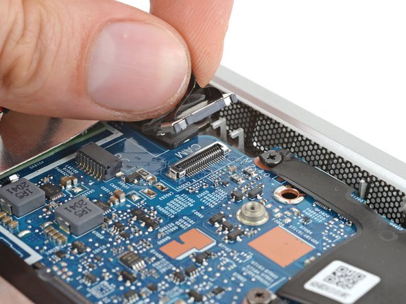

  14. HP EliteBook 840 Aero G8 Display Panel Replacement, Disconnect the display cable: crwdns2935265:014crwdnd2935265:01crwdnd2935265:02crwdne2935265:0 HP EliteBook 840 Aero G8 Display Panel Replacement, Disconnect the display cable: crwdns2935265:014crwdnd2935265:02crwdnd2935265:02crwdne2935265:0
    • Use your fingers to grip the plastic pull tab on the left display cable press connector, near the left hinge.
    • Pull straight up to disconnect the connector.
    • During reassembly, align the connector carefully over its socket and press down with your fingertip—first on one side, then the other—until it clicks into place. Don't try to force the connector into place. If you're having trouble, reposition it and try again. Don't use excessive force.

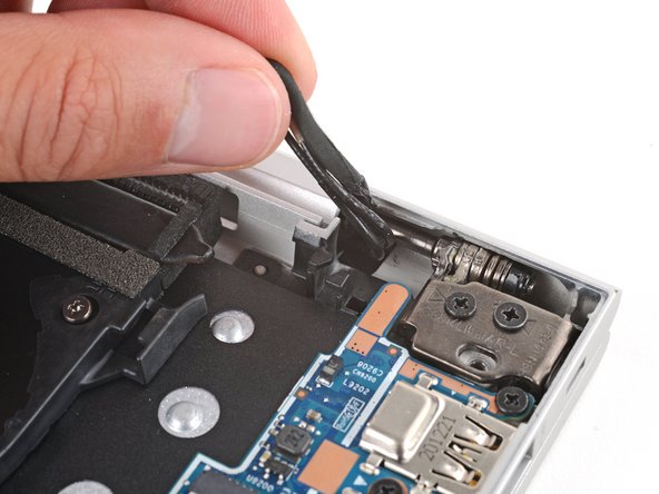

  16. HP EliteBook 840 Aero G8 Display Panel Replacement: crwdns2935265:016crwdnd2935265:01crwdnd2935265:02crwdne2935265:0 HP EliteBook 840 Aero G8 Display Panel Replacement: crwdns2935265:016crwdnd2935265:02crwdnd2935265:02crwdne2935265:0
    • Use your fingers or tweezers to lift the display and antenna cables out of their clip near the right hinge.

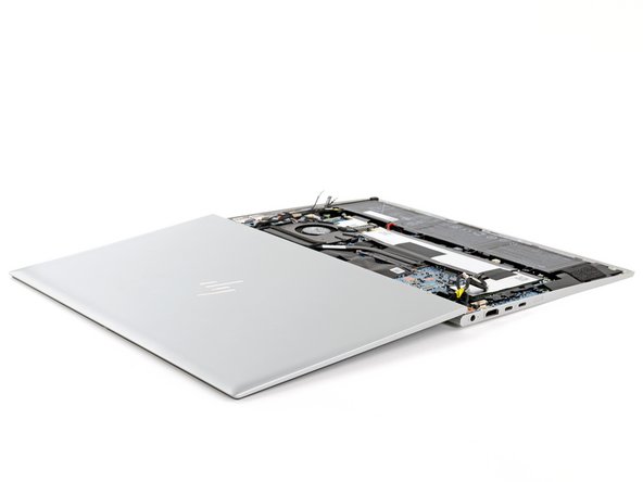

  17. HP EliteBook 840 Aero G8 Display Panel Replacement, Fully open your laptop: crwdns2935265:017crwdnd2935265:01crwdnd2935265:02crwdne2935265:0 HP EliteBook 840 Aero G8 Display Panel Replacement, Fully open your laptop: crwdns2935265:017crwdnd2935265:02crwdnd2935265:02crwdne2935265:0
    • Fully open your laptop and set it keyboard-side down on a flat, clean work surface, with the display closest you.
    • During reassembly, if your screen clicks or snaps when it's opened or closed, loosen the screws and realign the screen.

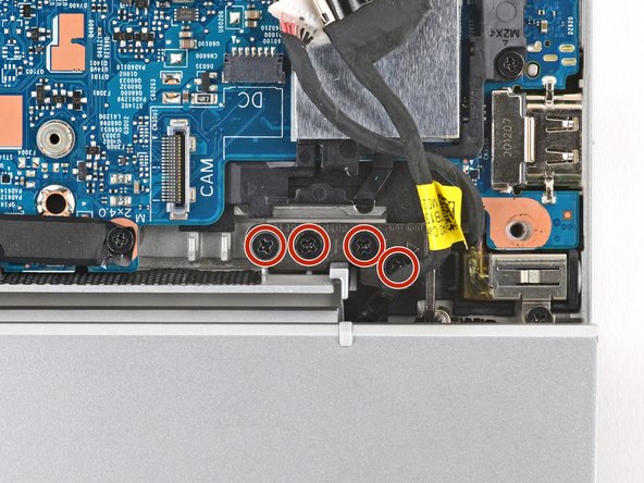

  18. HP EliteBook 840 Aero G8 Display Panel Replacement, Remove the hinge screws: crwdns2935265:018crwdnd2935265:01crwdnd2935265:02crwdne2935265:0 HP EliteBook 840 Aero G8 Display Panel Replacement, Remove the hinge screws: crwdns2935265:018crwdnd2935265:02crwdnd2935265:02crwdne2935265:0
    • Use a Phillips screwdriver to remove the six 4.6 mm‑long hinge screws—four in one hinge and two in the other.
    • During reassembly:
    • Before installing any hinge screws, make sure the display is properly aligned.
    • Tighten the hinge screws in ascending order based on the number stamped next to each screw hole.

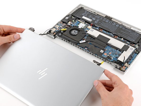

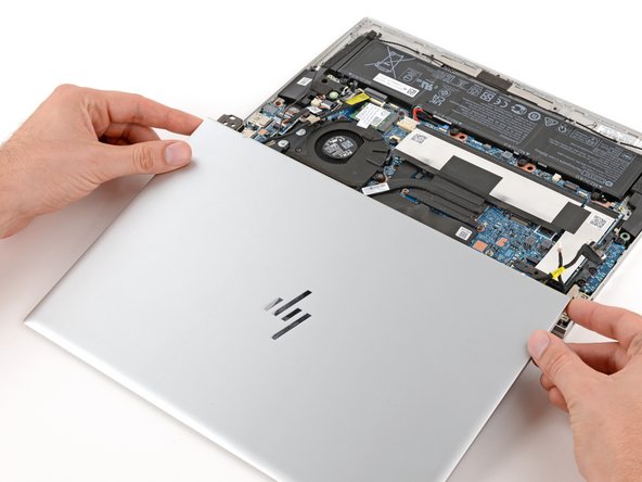

  19. HP EliteBook 840 Aero G8 Display Panel Replacement, Remove the display assembly: crwdns2935265:019crwdnd2935265:01crwdnd2935265:03crwdne2935265:0 HP EliteBook 840 Aero G8 Display Panel Replacement, Remove the display assembly: crwdns2935265:019crwdnd2935265:02crwdnd2935265:03crwdne2935265:0 HP EliteBook 840 Aero G8 Display Panel Replacement, Remove the display assembly: crwdns2935265:019crwdnd2935265:03crwdnd2935265:03crwdne2935265:0
    • Grip the display assembly near the hinges and lift straight up to remove it.
    • You may need to hold down the main body while guiding the hinges out of their recesses.
    • During reassembly, make sure both hinges on your replacement display assembly are fully open before lowering them into their recesses.
