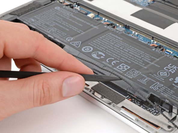

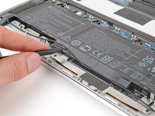

  8. HP EliteBook 840 Aero G8 Battery Replacement, Unclip the speaker cable: crwdns2935265:08crwdnd2935265:01crwdnd2935265:03crwdne2935265:0 HP EliteBook 840 Aero G8 Battery Replacement, Unclip the speaker cable: crwdns2935265:08crwdnd2935265:02crwdnd2935265:03crwdne2935265:0 HP EliteBook 840 Aero G8 Battery Replacement, Unclip the speaker cable: crwdns2935265:08crwdnd2935265:03crwdnd2935265:03crwdne2935265:0
    • Be careful not to bend, crease, deform, poke, or puncture the battery with your tool—a damaged battery is a potential fire hazard.
    • Use a spudger or your fingers to lift the speaker cable out of its clips on the bottom edge of the battery.

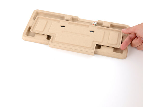

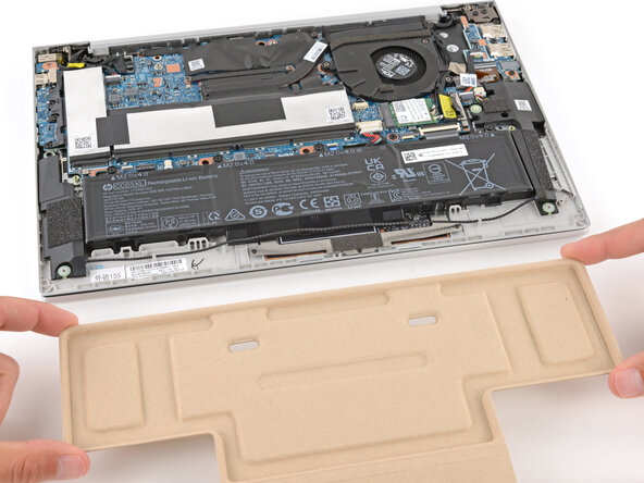

  9. HP EliteBook 840 Aero G8 Battery Replacement, Prepare the battery removal kit: crwdns2935265:09crwdnd2935265:01crwdnd2935265:03crwdne2935265:0 HP EliteBook 840 Aero G8 Battery Replacement, Prepare the battery removal kit: crwdns2935265:09crwdnd2935265:02crwdnd2935265:03crwdne2935265:0 HP EliteBook 840 Aero G8 Battery Replacement, Prepare the battery removal kit: crwdns2935265:09crwdnd2935265:03crwdnd2935265:03crwdne2935265:0
    • Open your Revivekit and grab the empty cardboard tray.
    • This tray will be used to remove and safely store your old battery.
    • Open the cardboard tray.

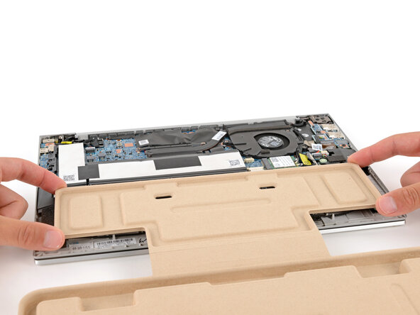

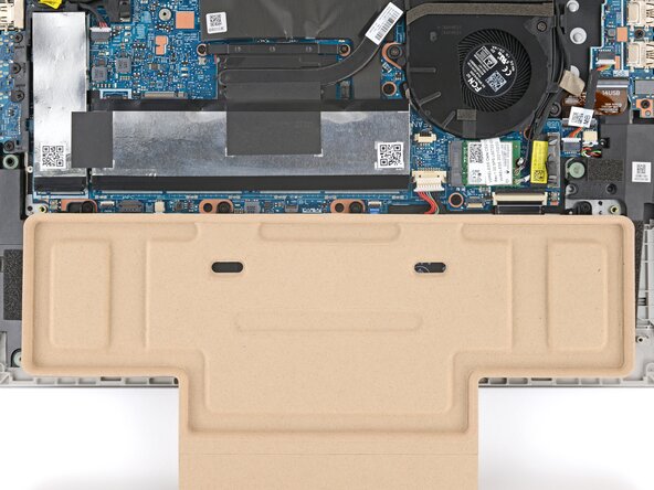

  10. HP EliteBook 840 Aero G8 Battery Replacement: crwdns2935265:010crwdnd2935265:01crwdnd2935265:03crwdne2935265:0 HP EliteBook 840 Aero G8 Battery Replacement: crwdns2935265:010crwdnd2935265:02crwdnd2935265:03crwdne2935265:0 HP EliteBook 840 Aero G8 Battery Replacement: crwdns2935265:010crwdnd2935265:03crwdnd2935265:03crwdne2935265:0
    • Remove the plastic liners from both adhesive strips.
  11. HP EliteBook 840 Aero G8 Battery Replacement, Adhere the cardboard to the battery: crwdns2935265:011crwdnd2935265:01crwdnd2935265:03crwdne2935265:0 HP EliteBook 840 Aero G8 Battery Replacement, Adhere the cardboard to the battery: crwdns2935265:011crwdnd2935265:02crwdnd2935265:03crwdne2935265:0 HP EliteBook 840 Aero G8 Battery Replacement, Adhere the cardboard to the battery: crwdns2935265:011crwdnd2935265:03crwdnd2935265:03crwdne2935265:0
    • Align the top edge of the cardboard with the top edge of the battery, without covering the battery screws. Make sure the battery is fully covered.
    • Once properly aligned, secure the cardboard to the battery with the adhesive strips by firmly pressing it into place with your fingers.

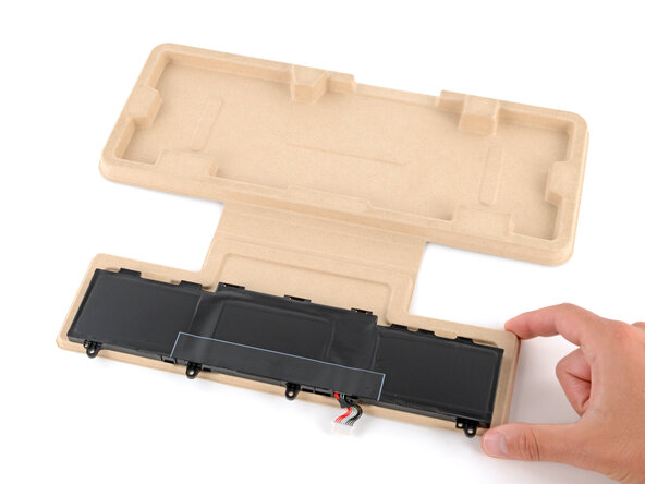

  12. HP EliteBook 840 Aero G8 Battery Replacement, Remove the battery screws: crwdns2935265:012crwdnd2935265:01crwdnd2935265:02crwdne2935265:0 HP EliteBook 840 Aero G8 Battery Replacement, Remove the battery screws: crwdns2935265:012crwdnd2935265:02crwdnd2935265:02crwdne2935265:0
    • Use a Phillips screwdriver to remove the four 4.5 mm‑long screws securing the top edge of the battery.

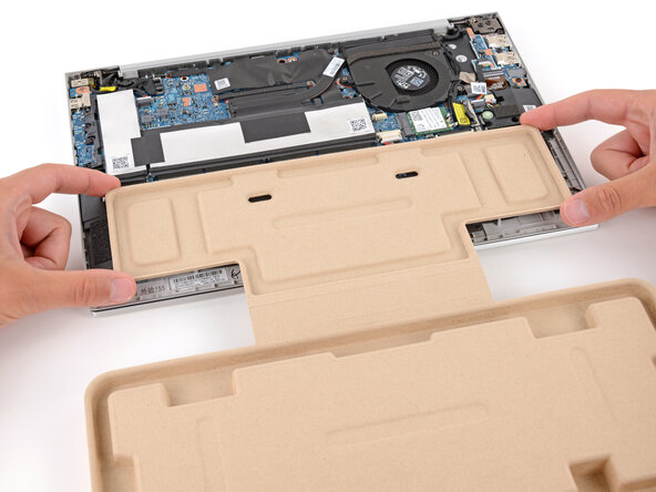

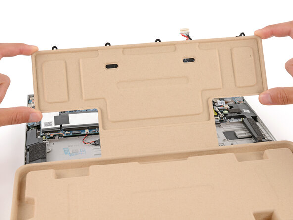

  13. HP EliteBook 840 Aero G8 Battery Replacement, Remove the battery: crwdns2935265:013crwdnd2935265:01crwdnd2935265:03crwdne2935265:0 HP EliteBook 840 Aero G8 Battery Replacement, Remove the battery: crwdns2935265:013crwdnd2935265:02crwdnd2935265:03crwdne2935265:0 HP EliteBook 840 Aero G8 Battery Replacement, Remove the battery: crwdns2935265:013crwdnd2935265:03crwdnd2935265:03crwdne2935265:0
    • The battery should stay adhered to the cardboard tray—be gentle when removing it.
    • Lift the top edge of that battery and slide the tabs on the bottom edge out of their slots.
    • Remove the battery.
  14. HP EliteBook 840 Aero G8 Battery Replacement: crwdns2935265:014crwdnd2935265:01crwdnd2935265:02crwdne2935265:0 HP EliteBook 840 Aero G8 Battery Replacement: crwdns2935265:014crwdnd2935265:02crwdnd2935265:02crwdne2935265:0
    • Close the cardboard tray so the old battery is safely enclosed, then set it aside.
    • Take your old battery to an R2 or e-Stewards certified recycler. Depending on your region, used HP devices and parts can be returned for reuse or recycling through the HP Planet Partners program. Follow any instructions included with your Revivekit.

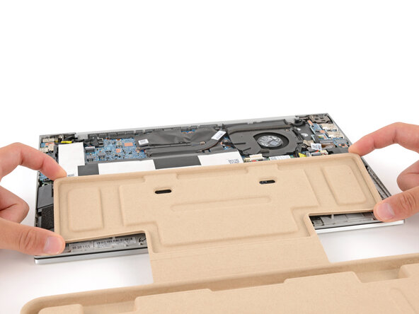

  15. HP EliteBook 840 Aero G8 Battery Replacement, Remove the replacement battery: crwdns2935265:015crwdnd2935265:01crwdnd2935265:03crwdne2935265:0 HP EliteBook 840 Aero G8 Battery Replacement, Remove the replacement battery: crwdns2935265:015crwdnd2935265:02crwdnd2935265:03crwdne2935265:0 HP EliteBook 840 Aero G8 Battery Replacement, Remove the replacement battery: crwdns2935265:015crwdnd2935265:03crwdnd2935265:03crwdne2935265:0
    • Remove the cardboard tray with your replacement battery enclosed and carefully open the tray.

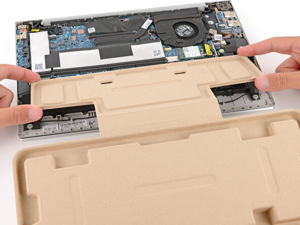

  16. HP EliteBook 840 Aero G8 Battery Replacement, Install the replacement battery: crwdns2935265:016crwdnd2935265:01crwdnd2935265:03crwdne2935265:0 HP EliteBook 840 Aero G8 Battery Replacement, Install the replacement battery: crwdns2935265:016crwdnd2935265:02crwdnd2935265:03crwdne2935265:0 HP EliteBook 840 Aero G8 Battery Replacement, Install the replacement battery: crwdns2935265:016crwdnd2935265:03crwdnd2935265:03crwdne2935265:0
  17. HP EliteBook 840 Aero G8 Battery Replacement: crwdns2935265:017crwdnd2935265:01crwdnd2935265:02crwdne2935265:0 HP EliteBook 840 Aero G8 Battery Replacement: crwdns2935265:017crwdnd2935265:02crwdnd2935265:02crwdne2935265:0
    • Use a Phillips screwdriver to install the four 4.5 mm‑long screws along the top edge of the battery.

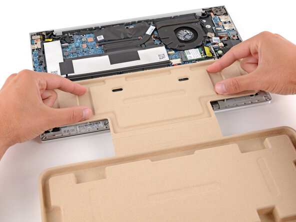

  18. HP EliteBook 840 Aero G8 Battery Replacement, Remove the cardboard: crwdns2935265:018crwdnd2935265:01crwdnd2935265:03crwdne2935265:0 HP EliteBook 840 Aero G8 Battery Replacement, Remove the cardboard: crwdns2935265:018crwdnd2935265:02crwdnd2935265:03crwdne2935265:0 HP EliteBook 840 Aero G8 Battery Replacement, Remove the cardboard: crwdns2935265:018crwdnd2935265:03crwdnd2935265:03crwdne2935265:0
    • Slowly peel the cardboard away from the battery and remove it.
  19. HP EliteBook 840 Aero G8 Battery Replacement, Put your old battery in the box: crwdns2935265:019crwdnd2935265:01crwdnd2935265:01crwdne2935265:0
    • Place the tray with your old battery into the Revivekit's cardboard box.
    • After your repair, ship or bring this box to a certified recycler so the battery can be safely recycled.
