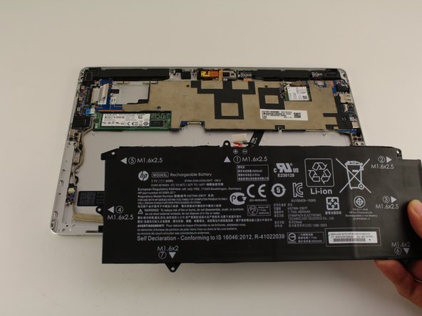

  7. HP Elite x2 G1 1012 Battery Replacement, Battery: crwdns2935265:07crwdnd2935265:01crwdnd2935265:01crwdne2935265:0
    • Use a Phillips #00 screwdriver to remove the seven screws holding the battery in place.
    • Five 1.6x2.5 mm and two 1.6x2 screws should be on the battery.
  8. HP Elite x2 G1 1012 Battery Replacement: crwdns2935265:08crwdnd2935265:01crwdnd2935265:02crwdne2935265:0 HP Elite x2 G1 1012 Battery Replacement: crwdns2935265:08crwdnd2935265:02crwdnd2935265:02crwdne2935265:0
    • Disconnect the red, white, and black wires and remove the battery from the device.
    • Make sure to properly dispose of the dead battery.

One problem that people might run into is the device not recognizing the battery firmware if it is an aftermarket battery and not a genuine HP one. Where the device will work but only if it is plugged into the charger. It even shows the battery charging but very slowly. If you disconnect the charger the device will instantly shut off. What is the fix for that?
