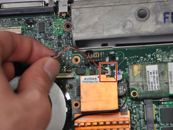

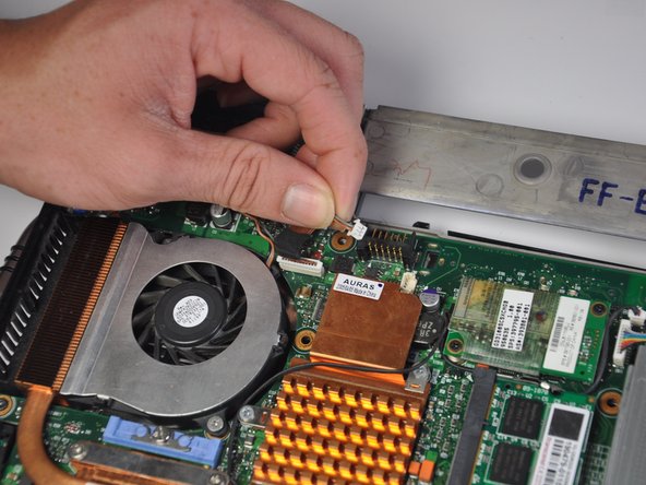

    • Use the point of a spudger to push on alternating sides of the fan connector to "walk" it out of its socket.
    • It may take a lot of alternating before the connector comes out. Be patient, and don't pull on the cables.
    • To reconnect the cable, align the connector and use a spudger or clean fingernail to push it fully into the socket.
    • Don't push on the cables themselves, or you may damage the connector.
    • Place the cable off to the side so that it is out of the way.

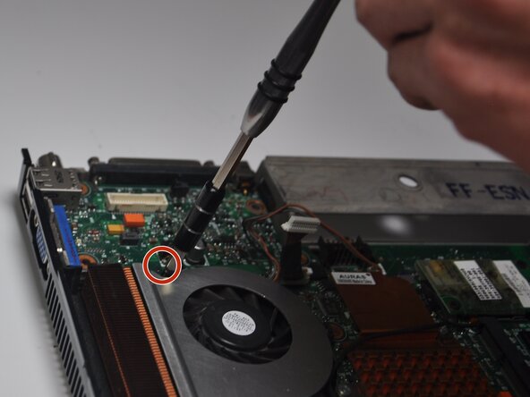

    • Use a Phillips #1 screwdriver to remove the two 7.0 mm screws on the top left and top right corners of the cooling fan.

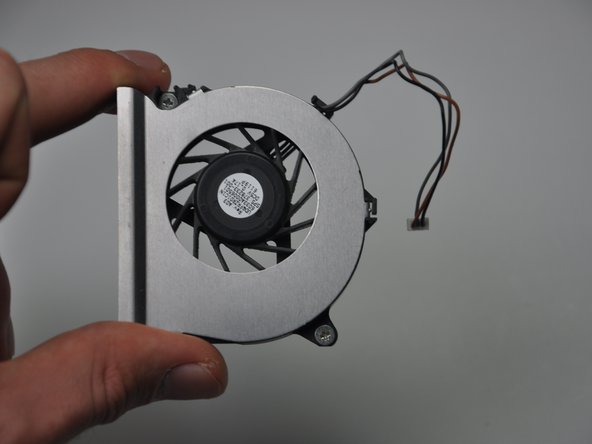

  3. HP Compaq NC6120 Cooling Fan Replacement: crwdns2935265:03crwdnd2935265:01crwdnd2935265:02crwdne2935265:0 HP Compaq NC6120 Cooling Fan Replacement: crwdns2935265:03crwdnd2935265:02crwdnd2935265:02crwdne2935265:0
    • Remove the fan from the laptop.
