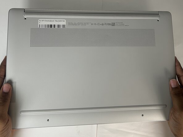

    • For your safety, unplug all peripheries, discharge the battery below 25%, and power down your device before beginning disassembly.
    • Lay the device down so the lower case is facing up.

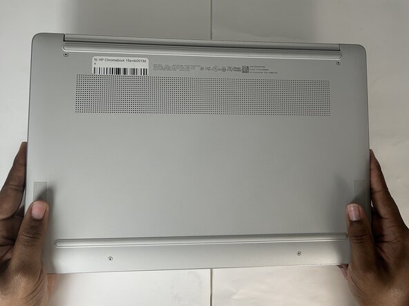

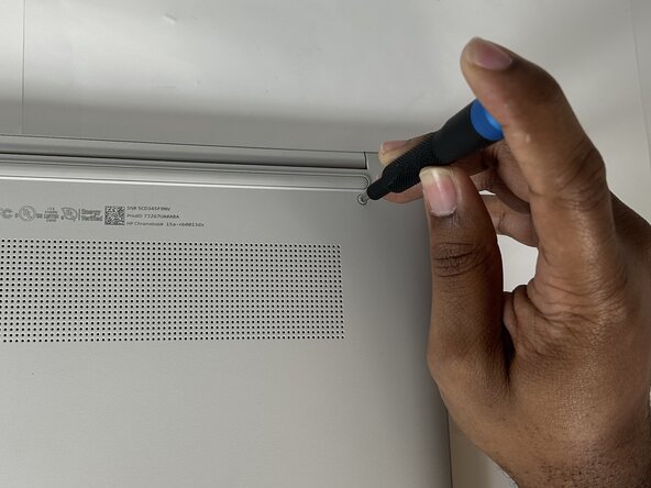

  2. HP Chromebook 15a-nb0013dx Wi-Fi Module Replacement: crwdns2935265:02crwdnd2935265:01crwdnd2935265:03crwdne2935265:0 HP Chromebook 15a-nb0013dx Wi-Fi Module Replacement: crwdns2935265:02crwdnd2935265:02crwdnd2935265:03crwdne2935265:0 HP Chromebook 15a-nb0013dx Wi-Fi Module Replacement: crwdns2935265:02crwdnd2935265:03crwdnd2935265:03crwdne2935265:0

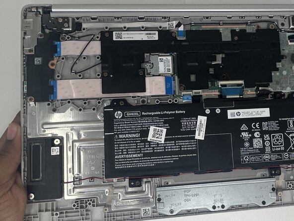

    • Use a Phillips screwdriver to remove four 6.6 mm screws that secure the lower case.
  3. HP Chromebook 15a-nb0013dx Wi-Fi Module Replacement: crwdns2935265:03crwdnd2935265:01crwdnd2935265:03crwdne2935265:0 HP Chromebook 15a-nb0013dx Wi-Fi Module Replacement: crwdns2935265:03crwdnd2935265:02crwdnd2935265:03crwdne2935265:0 HP Chromebook 15a-nb0013dx Wi-Fi Module Replacement: crwdns2935265:03crwdnd2935265:03crwdnd2935265:03crwdne2935265:0

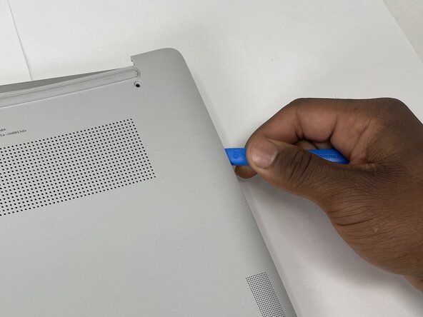

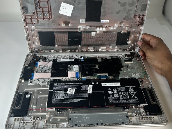

    • Insert an opening tool into the seam between the lower case and the chassis, near the hinge.
    • Pry around the entire perimeter of the lower case until it fully releases.
    • Remove the lower case.

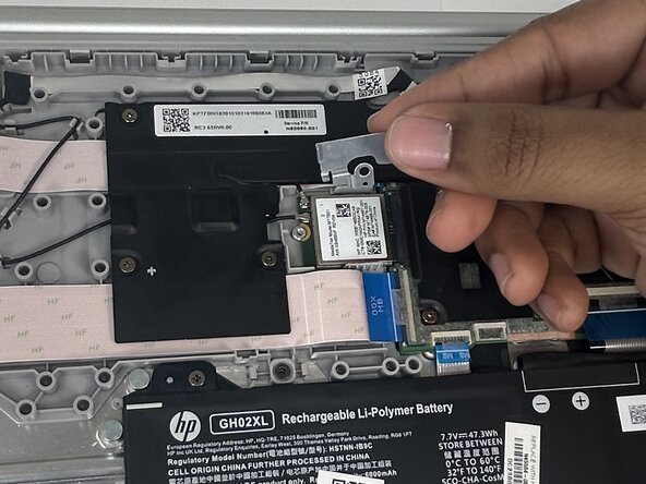

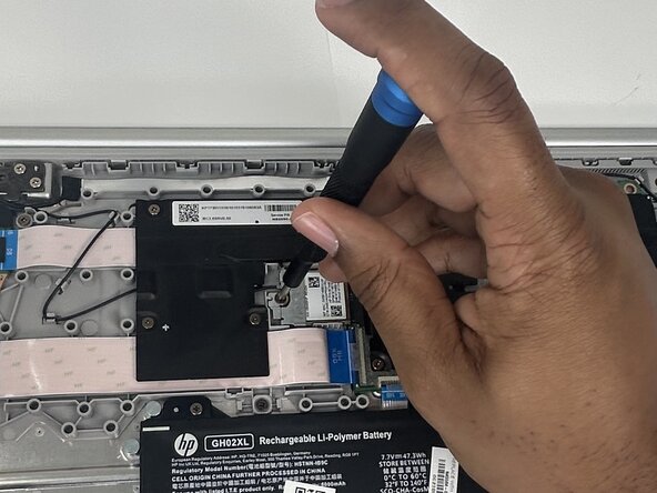

    • Use a Phillips #0 screwdriver to remove the one 4.1 mm screw that secures the metal bracket on top of the Wi-Fi module.
  5. HP Chromebook 15a-nb0013dx Wi-Fi Module Replacement: crwdns2935265:05crwdnd2935265:01crwdnd2935265:02crwdne2935265:0 HP Chromebook 15a-nb0013dx Wi-Fi Module Replacement: crwdns2935265:05crwdnd2935265:02crwdnd2935265:02crwdne2935265:0
    • Grasp and remove the metal bracket.

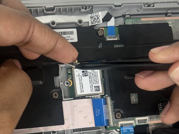

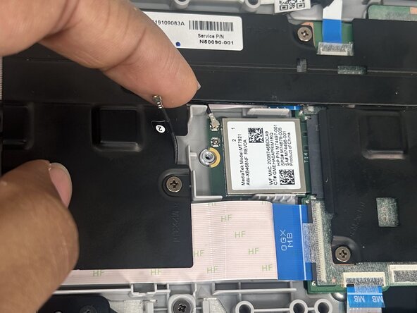

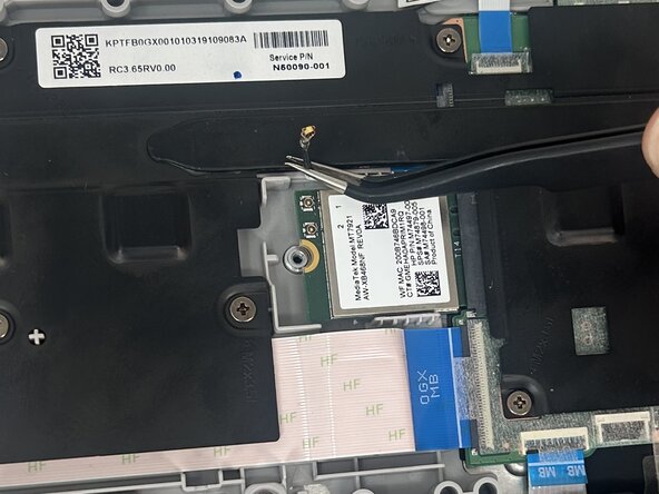

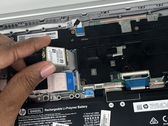

    • Use angled tweezers to lift up and disconnect the lower Wi-Fi module coaxial connector.
  7. HP Chromebook 15a-nb0013dx Wi-Fi Module Replacement: crwdns2935265:07crwdnd2935265:01crwdnd2935265:03crwdne2935265:0 HP Chromebook 15a-nb0013dx Wi-Fi Module Replacement: crwdns2935265:07crwdnd2935265:02crwdnd2935265:03crwdne2935265:0 HP Chromebook 15a-nb0013dx Wi-Fi Module Replacement: crwdns2935265:07crwdnd2935265:03crwdnd2935265:03crwdne2935265:0
    • Use angled tweezers to lift up and disconnect the upper Wi-Fi module coaxial connector.

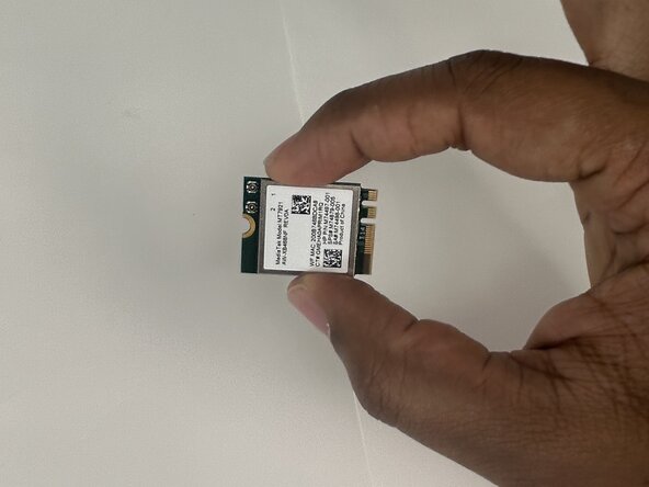

  8. HP Chromebook 15a-nb0013dx Wi-Fi Module Replacement: crwdns2935265:08crwdnd2935265:01crwdnd2935265:03crwdne2935265:0 HP Chromebook 15a-nb0013dx Wi-Fi Module Replacement: crwdns2935265:08crwdnd2935265:02crwdnd2935265:03crwdne2935265:0 HP Chromebook 15a-nb0013dx Wi-Fi Module Replacement: crwdns2935265:08crwdnd2935265:03crwdnd2935265:03crwdne2935265:0
    • Grasp the Wi-Fi module and pull it directly out of its socket.
