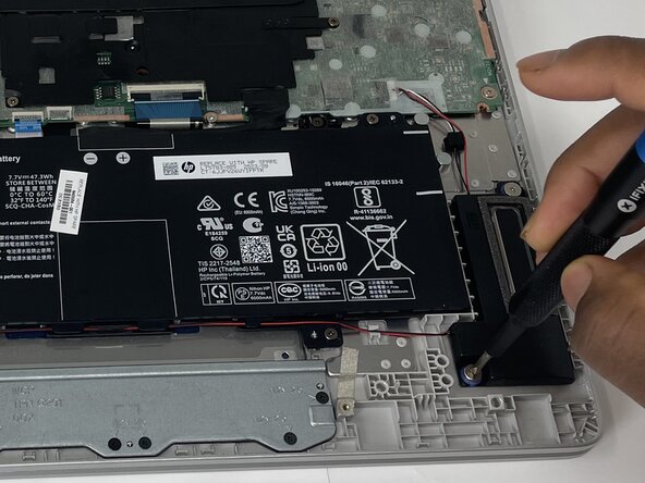

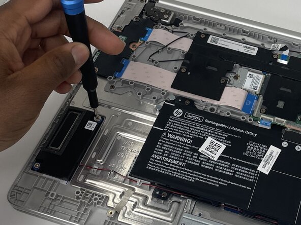

  4. HP Chromebook 15a-nb0013dx Speakers Replacement, Speakers: crwdns2935265:04crwdnd2935265:01crwdnd2935265:03crwdne2935265:0 HP Chromebook 15a-nb0013dx Speakers Replacement, Speakers: crwdns2935265:04crwdnd2935265:02crwdnd2935265:03crwdne2935265:0 HP Chromebook 15a-nb0013dx Speakers Replacement, Speakers: crwdns2935265:04crwdnd2935265:03crwdnd2935265:03crwdne2935265:0
    • Use a Phillips screwdriver to remove four 3.1 mm screws that secure the right and left speakers.

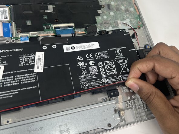

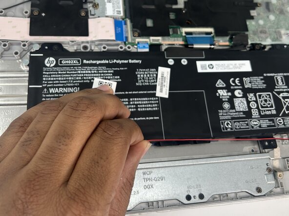

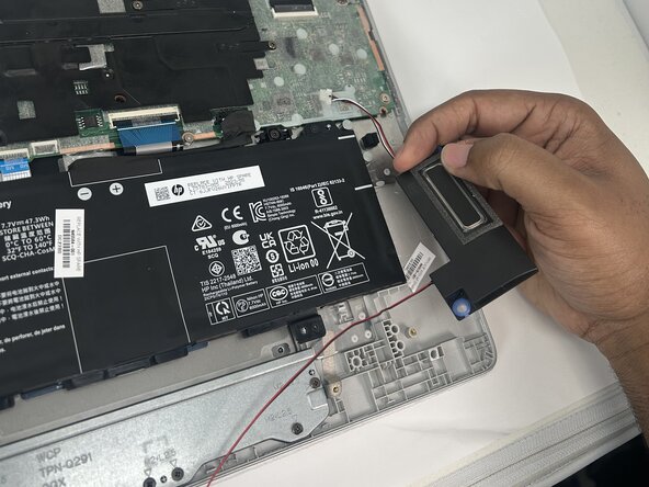

    • Unseat the speaker wires from the retaining hooks on the lower edge of the battery.
  6. HP Chromebook 15a-nb0013dx Speakers Replacement: crwdns2935265:06crwdnd2935265:01crwdnd2935265:03crwdne2935265:0 HP Chromebook 15a-nb0013dx Speakers Replacement: crwdns2935265:06crwdnd2935265:02crwdnd2935265:03crwdne2935265:0 HP Chromebook 15a-nb0013dx Speakers Replacement: crwdns2935265:06crwdnd2935265:03crwdnd2935265:03crwdne2935265:0

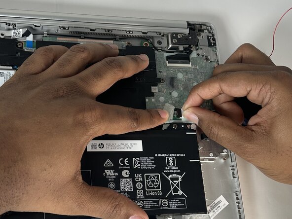

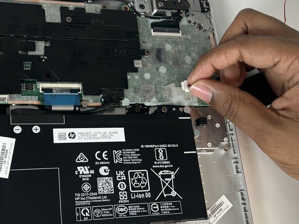

    • Lift back the translucent tape over the speaker connector.
    • Grasp the white speaker connector and pull it directly out of its motherboard socket.
    • Connector is fragile.

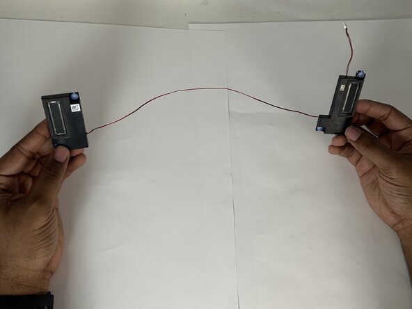

  7. HP Chromebook 15a-nb0013dx Speakers Replacement: crwdns2935265:07crwdnd2935265:01crwdnd2935265:03crwdne2935265:0 HP Chromebook 15a-nb0013dx Speakers Replacement: crwdns2935265:07crwdnd2935265:02crwdnd2935265:03crwdne2935265:0 HP Chromebook 15a-nb0013dx Speakers Replacement: crwdns2935265:07crwdnd2935265:03crwdnd2935265:03crwdne2935265:0
    • Grab the left and right speakers.
    • Lift the speakers up and out of the chassis.
