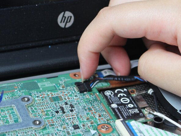

  7. HP Chromebook 14-SMB Fan Replacement, Fan: crwdns2935265:07crwdnd2935265:01crwdnd2935265:01crwdne2935265:0
    • Remove three Phillips screws that secure the fan.
    • Dislodge the cables around the fan from their retaining hooks.
  8. HP Chromebook 14-SMB Fan Replacement: crwdns2935265:08crwdnd2935265:01crwdnd2935265:02crwdne2935265:0 HP Chromebook 14-SMB Fan Replacement: crwdns2935265:08crwdnd2935265:02crwdnd2935265:02crwdne2935265:0
    • Use your fingernail or the flat end of a spudger to disconnect the fan connector from its motherboard socket.
  9. HP Chromebook 14-SMB Fan Replacement: crwdns2935265:09crwdnd2935265:01crwdnd2935265:01crwdne2935265:0
    • Lift the fan up and out of the chassis.
    • Take extra care to not damage the vent towards the front of the fan.
