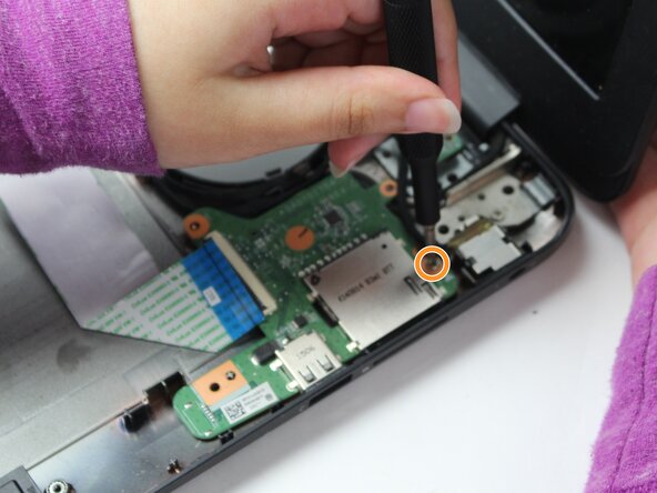

  7. HP Chromebook 14-SMB Daughterboard Replacement, Daughterboard: crwdns2935265:07crwdnd2935265:01crwdnd2935265:02crwdne2935265:0 HP Chromebook 14-SMB Daughterboard Replacement, Daughterboard: crwdns2935265:07crwdnd2935265:02crwdnd2935265:02crwdne2935265:0
    • Lift the black ZIF locking flap on the daughterboard.
    • Disconnect the ribbon cable.
    • Remove the single screw near the SD card with a Phillips #0 screwdriver.

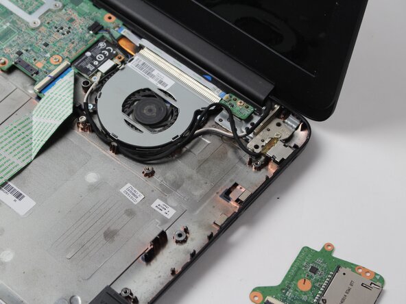

  8. HP Chromebook 14-SMB Daughterboard Replacement: crwdns2935265:08crwdnd2935265:01crwdnd2935265:02crwdne2935265:0 HP Chromebook 14-SMB Daughterboard Replacement: crwdns2935265:08crwdnd2935265:02crwdnd2935265:02crwdne2935265:0
    • Grip the sides of the daughterboard and lift it up and out of the chassis.
